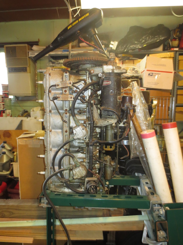

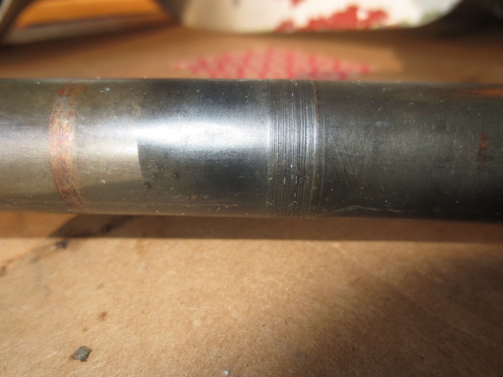

Hey All,
I have started restoring a 1961 Merc 800EL-1.
Never had it running but it cranks about 110 psi across all six cylinders. So I am hoping rebuilding the ignition, electrical, fuel system, and lower unit will make it go again.
The drive shaft shows wear at the water pump seal location and intend to send it out for flame spraying before reassembling.

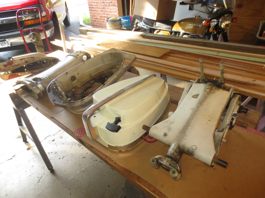

Dr Frankenmerc,
Curious how you get the motors you restore to look so pretty.
It appears that the powerheads are painted and would be interested to know what you use. This 800 looks rough and I do not know if simply cleaning it will be sufficient.
Also would like to know what you use for the Cloud White paint. The last one I restored I had a friend spray it with Imron and do not want to take that route again.
In the process of blasting the parts now and I will be painting this one myself.

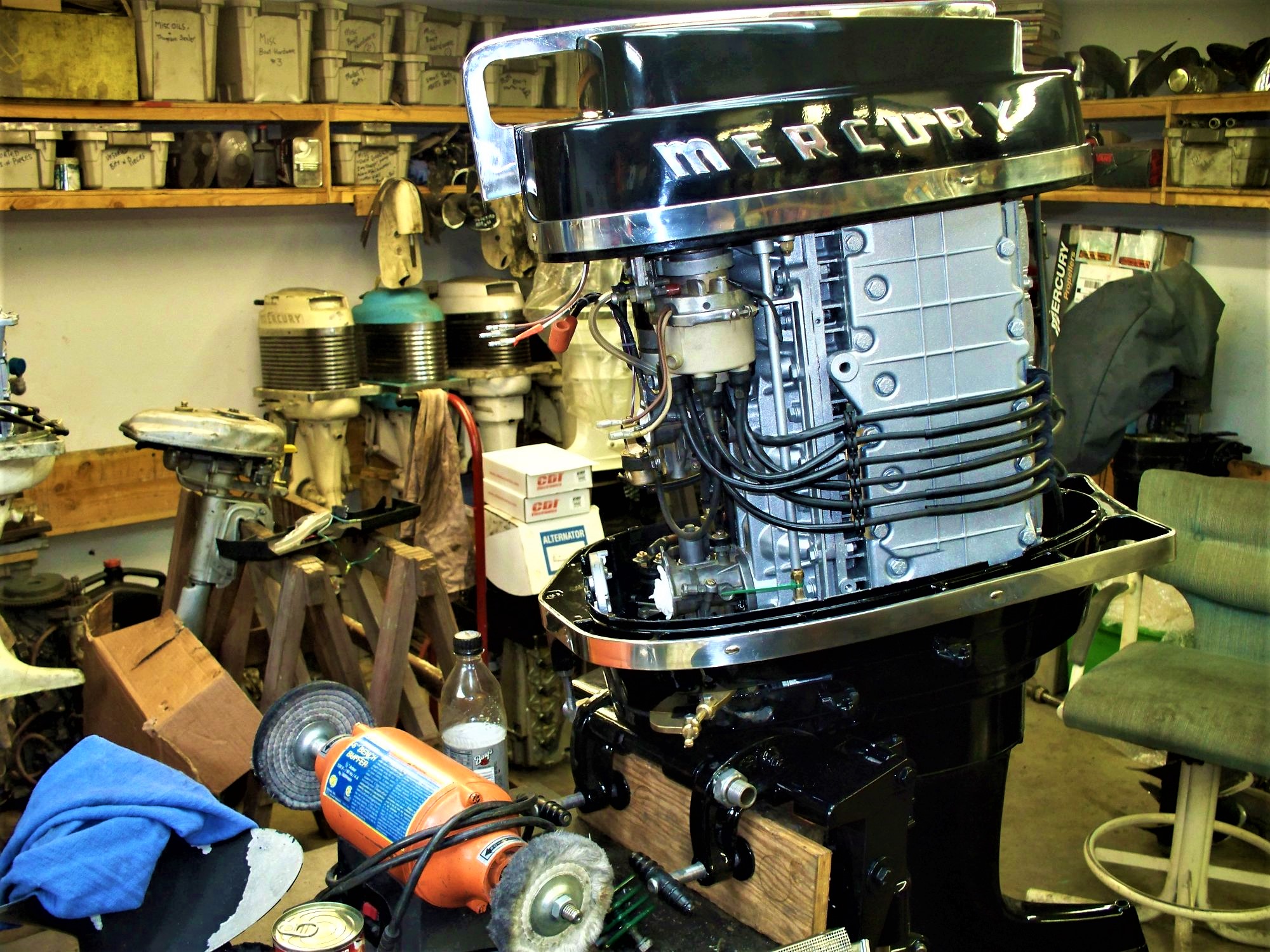

Merc 800 FGS restoration 9 years 5 months ago #131757
I have my painter use 1992 VW Cashmere white.
PPG paint, "base - clear"
I have him use a base - clear 'bright silver' on the engine block.
I can get both paint codes if needed.

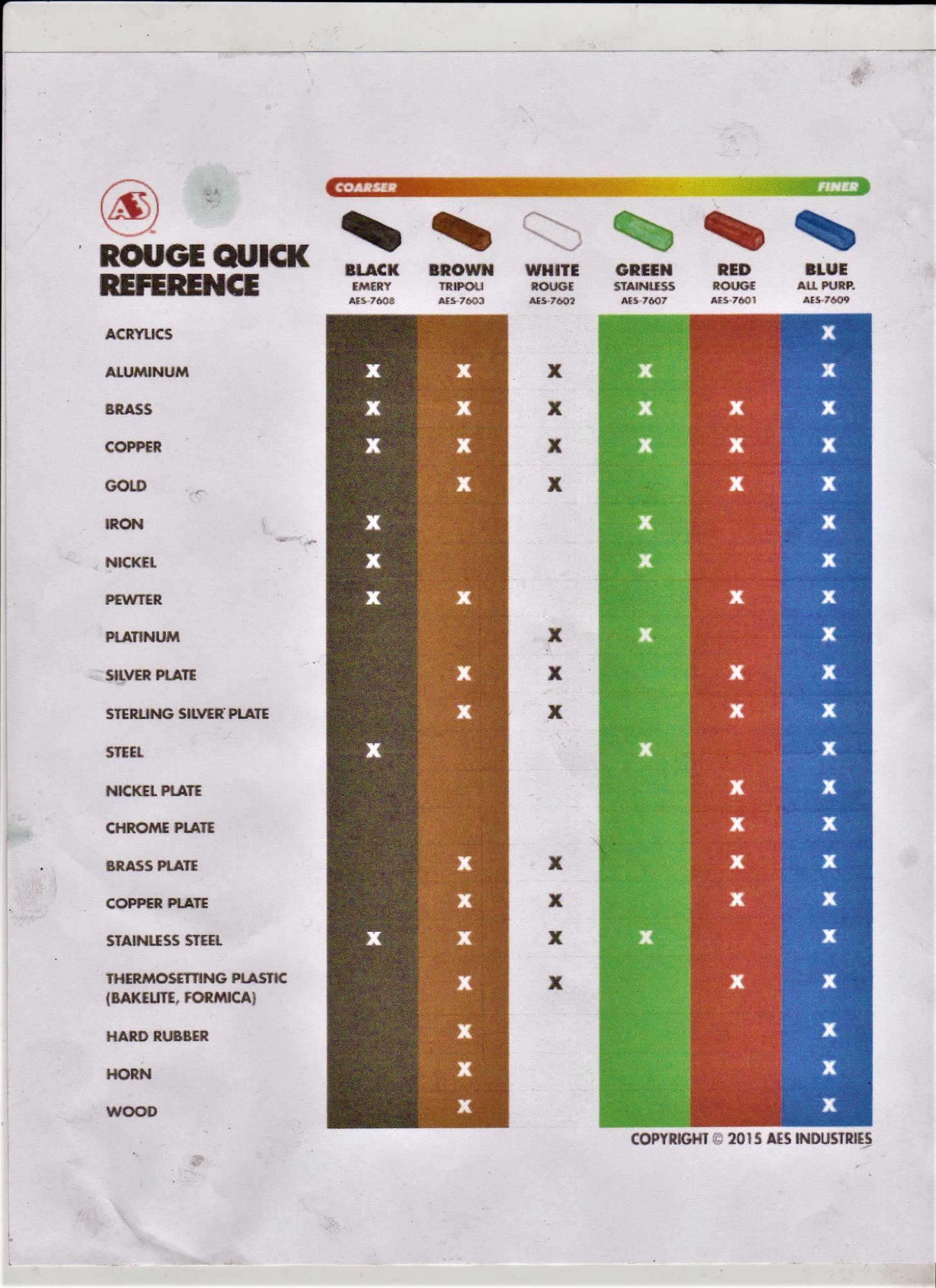

I polish the stainless, and aluminum parts with a cheap Harbor Freight buffing & polishing bench mounted devise.
It is visible in the picture of my beast that you added to your post.
I plan on spending a bit more money on a larger buffing-polishing set up.
I have attached a print-out of the different polishing rouges.
doc

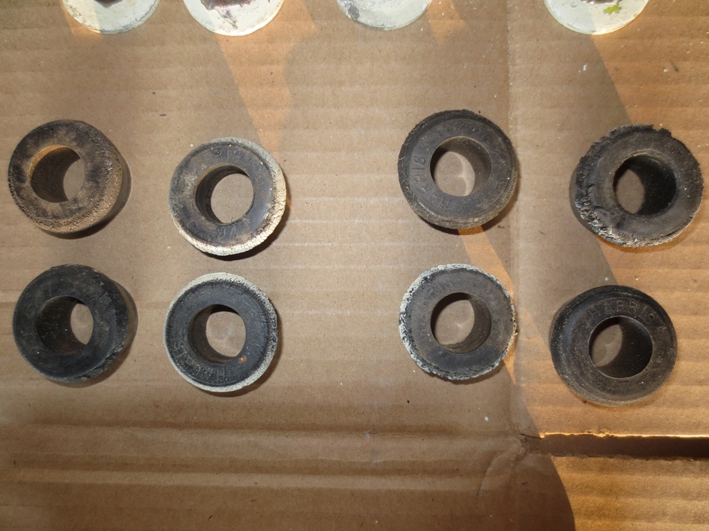

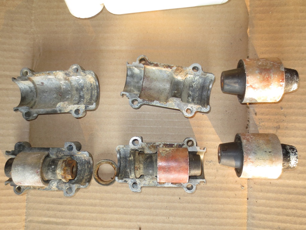

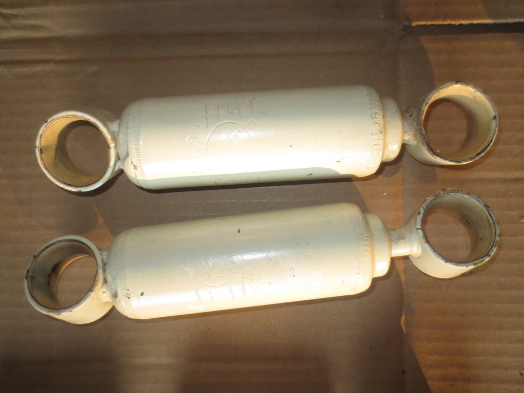

Looking for a few parts.
Anyone know of a source for the shocks?
Also need the rubber shock bushings.
upper and lower rubber mounts

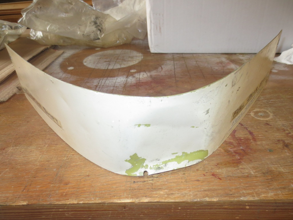

And this trim cover got mashed.
Thanks,
Terry
Merc 800 FGS restoration 9 years 5 months ago #131876
Terry,
It appears that www.marineengine.com actually has NOS upper & lower rubber mounts.
They also have the rubber bushings for the shock absorbers, but not the shock absorbers.
Your shock absorbers look pretty decent. If they work okay, and don't have any dents, etc - why not use them??
I might have some decent used ones if needed.
Believe it or not,...They actually indicate that they also have the NLA/NOS trim cover.
Yours could probably be straightened with an English Wheel. A pal of mine has rescued several of those for me with an English Wheel.
They also have the inside & outside covers & related rubber washers for the upper mounts.
All this is pretty amazing IMHO, but they haven't failed me yet.
doc F

Thanks for everybody's input.

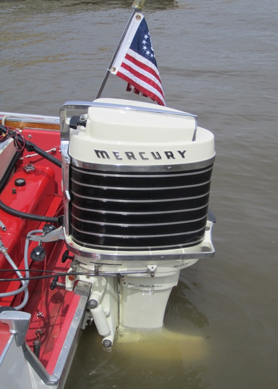

Good to know the rubber parts are still available through Marine Engine and Joe Poole says he has them in stock too. Joe also said he has a housing cover replacement and aluminum replacement shocks.
I want to keep this restoration as original as possible so will need to find used shocks if NOS are extinct. What I have pictured above leaked and are shot.
Still blasting parts today but need to make a decision on paint soon.
This is the Merc 800 I have on Mama Mia! now after a fresh coating of Imron.
Terry
