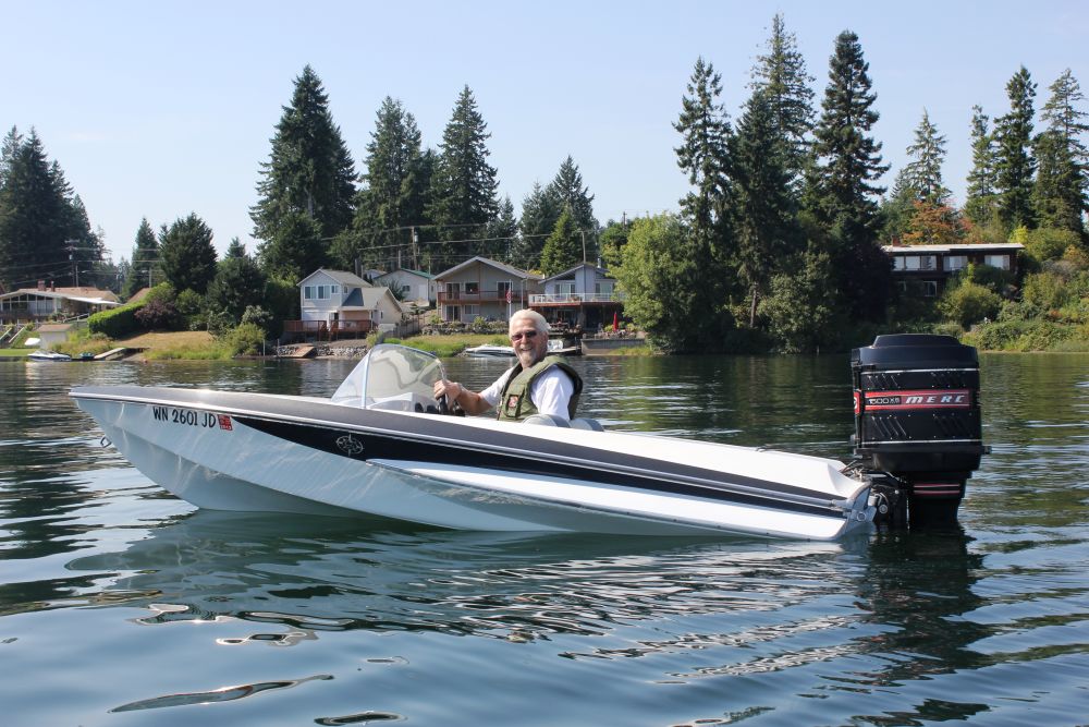

I couldn't find the measurement on the cables in Mercury Momma's G-3, so I did the best to measure it accurately.
I'm 'pretty sure' that they are 12 ft, Teleflex CC17912

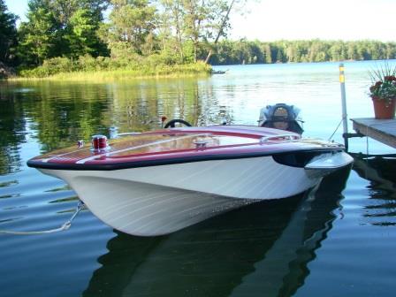

Thanks, Doc. I figured it would be about that as the Teleflex steering cable is 13'. If I may, I have another question. My engine's (Model No. OD230618) flywheel is protected with a plastic piece called the Cover Assembly on the parts list at MarineEngine.com. It's held in place by three studs and wing nuts. One of the studs is missing and the other two are rusty and deteriorating. I cannot find the studs or the engine part that carries them in anywhere in the parts list. Can I operate the engine wisely/safely without the Cover Assembly if the studs fail or do I need to replace the studs. If I need to replace them, can you point to me to where they are in the parts list? Thanks for you help and insight, Doc. I really appreciate you and the wealth of knowledge you bring to the forum. Here' a pic of my G3 in quiet repose.
