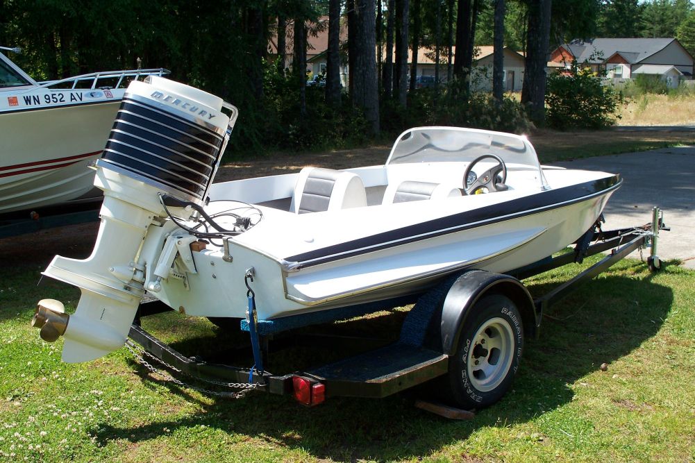

new to this forum, looking for help/instructions with installing power tilt on my 1961 800 fgs. I have "pieced- together" some of the parts, I have the 2 cylinders and mounts, pump and lines. The used lines will be replaced, once I get everything together. I don't know if I have all the mounting hardware, bushings etc. need to find either a parts break-down and/or installation instructions. any help would be appreciated !!

If you can post a picture of what parts you have, we can let you know what bits-n-pieces you still need.

Are the upgraded swivel mounts available? or is it off a later model that I can look for ? the motor is off the boat right now, and any upgrades would be easier now. I also have a '62 850 fgs for a spare that I will be going through. not in a hurry, The boat is undergoing preservation / restoration . Btw, thanks for the info. going to try adding some pics .
