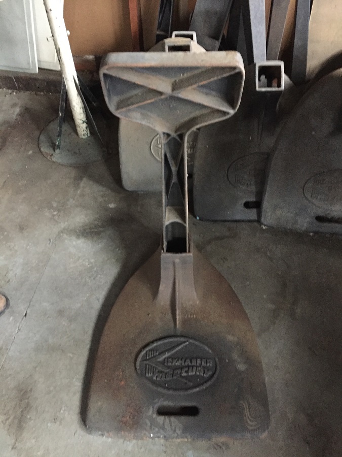

Merc stands 9 years 8 months ago #130837
I recently posted a thread about some barn fresh Mercs. My friend, who bought the marina where those were found, just found some more treasures. From the shape of the logo I am guessing that they date from 1957 to 1963.
There are eight of these. They do need new paint. He wishes to sell them. Well, one is spoken for... He does have some caster sets, too. I have seen these on ebay, with some extraordinary asking prices. What would be a fair price for one?
Larry

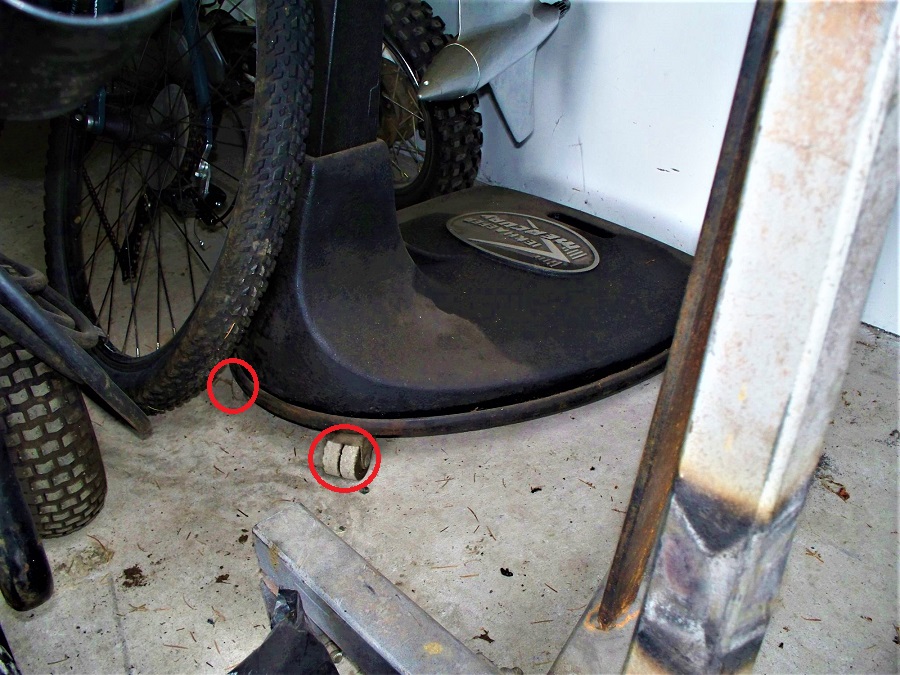

Doc, would it be possible for you to post a photo of the caster base? I looked at a later Merc stand (rectangular, 70's) and it looks like it uses stem casters that just plugged into the cast holes in the stand base where the neoprene buttons would go. They were 2" diameter double wheel casters. Did the earlier stand bases have a frame of sorts that the casters attached to? I haven't found any generic stem casters that will plug into the holes in the base, but I may fabricate a few from some similar plate casters.

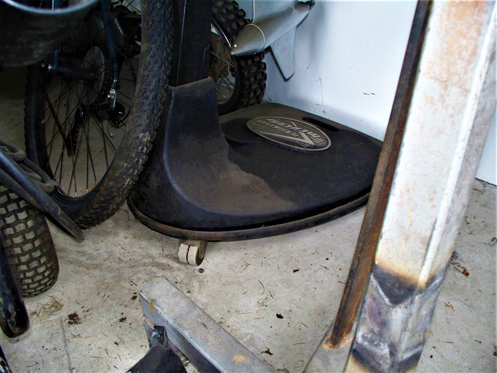

Re:Merc stands 9 years 6 months ago #131427
Not the best picture, but here ya go!
doc
Merc stands 9 years 6 months ago #131481
Doc, Thanks for the photo. I think I see two casters peeking out on that end of the stand base. That indicates that there is some kind of subframe for the casters.
If I could get a look at what Mercury made, I could fabricate a replica. I would also be able to make a shop drawing to share here so that others could make their own. Any help greatly appreciated.

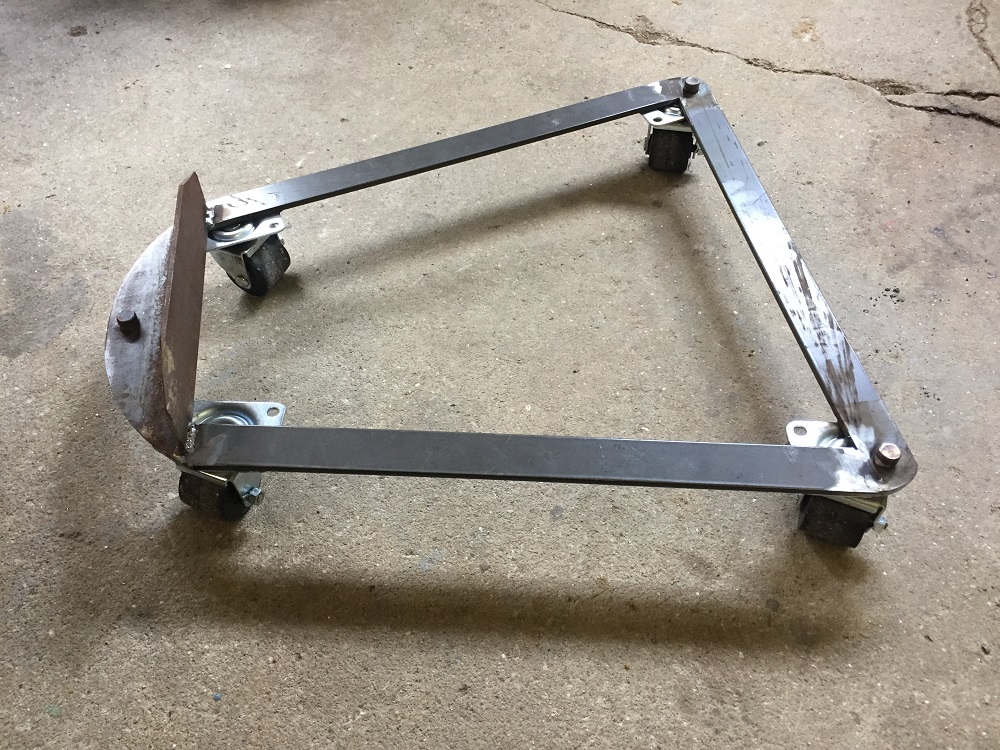

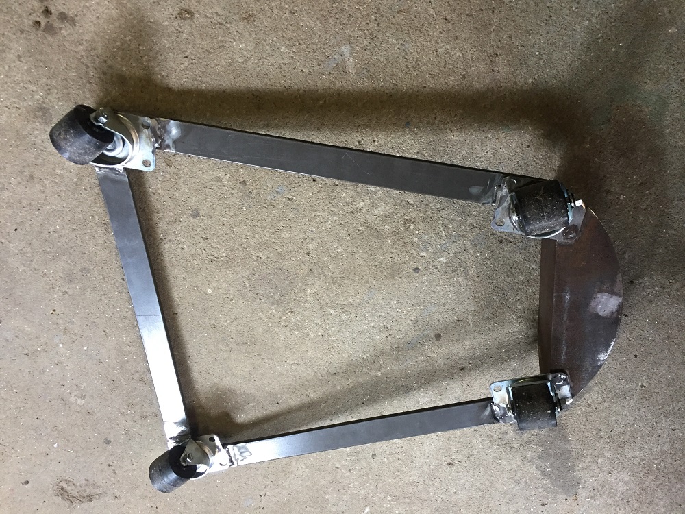

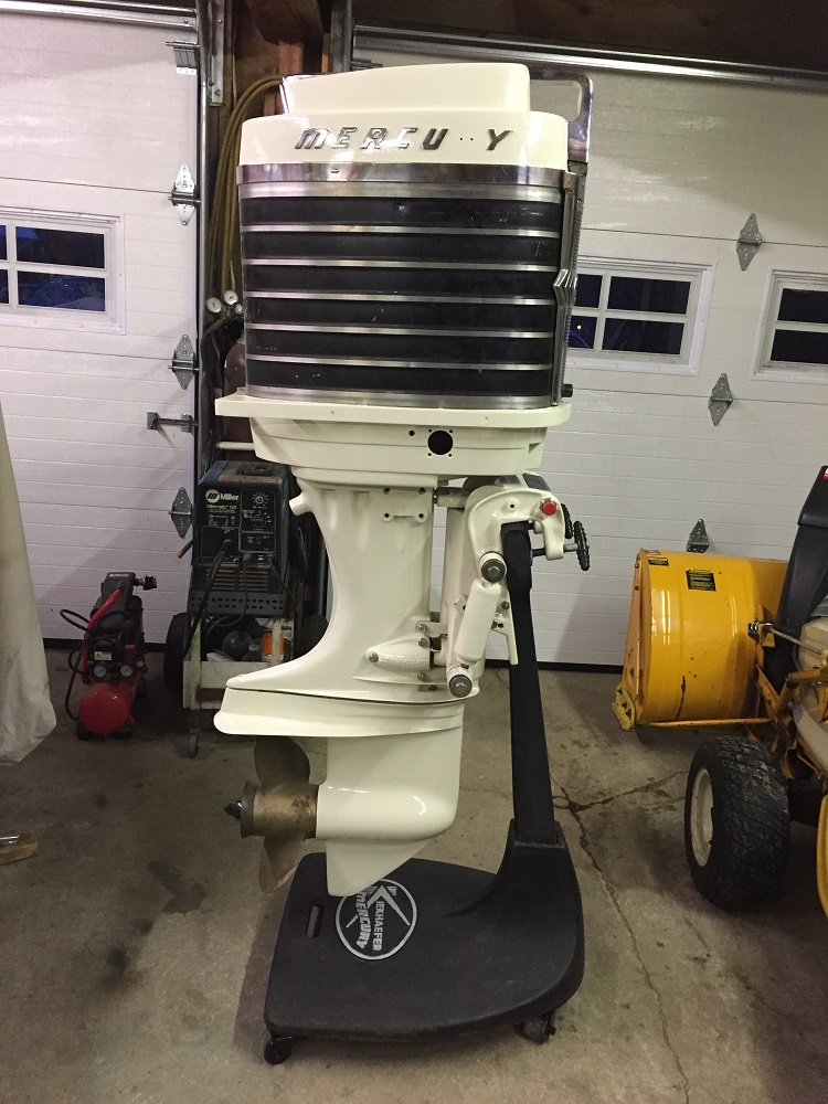

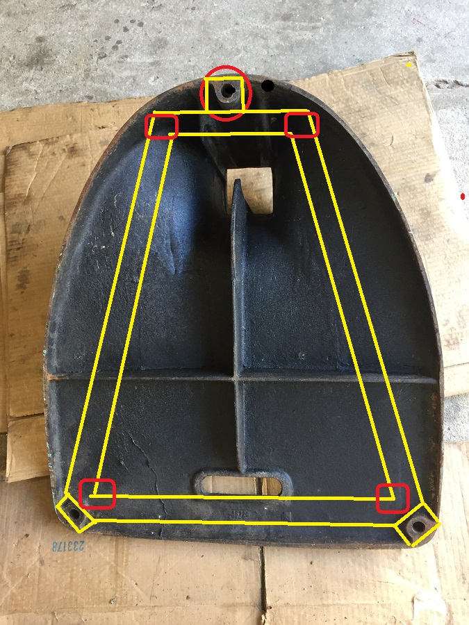

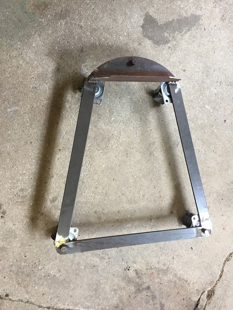

Merc stands 8 years 7 months ago #135835
Well, I have found that the casters just don't exist. So, I recently made a caster base. I found double wide 2" diameter casters on the innanet. A piece of 3"X3"X1/4" angle bar, a few pieces of 1/4"X1 1/2" flat bar, and a piece of 5/8" round stock. An hour of cutting, grinding, and welding, and Voila!
Best,
Larry
Merc stands 8 years 7 months ago #135838
  • Dr.Go!
  • Dr.Go!'s Avatar
  • Posts: 1719
  • Karma: 19
  • Thank you received: 125
Nice! Functional and looks great all together now! Well done.
