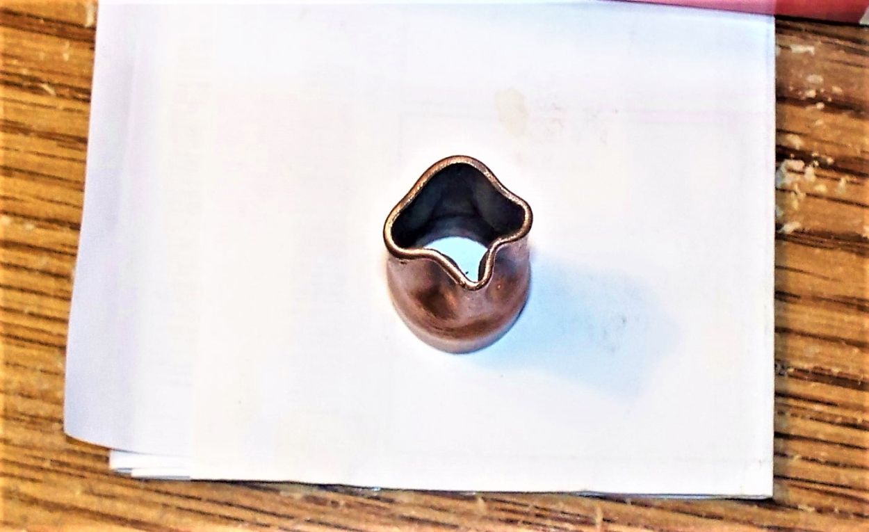

If the beast has been used in salt water much, there is a possibility that salt corrosion has crushed the water delivery tube at its top end.
I have attached a picture of just how powerful salt corrosion is.
doc F
