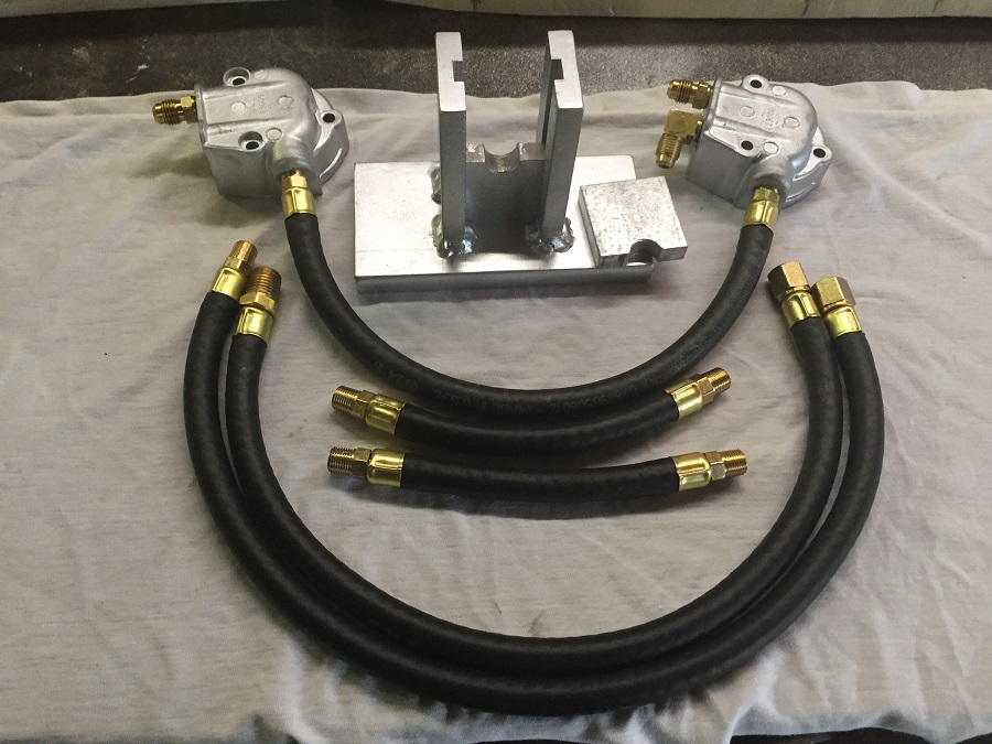

I found the fittings online, and changed the proprietary Merc fittings to flare fittings. Bought the hose at the local auto parts store. I made the fixture to swadge the ferrules. Cost for the parts was less than $35.
Larry
