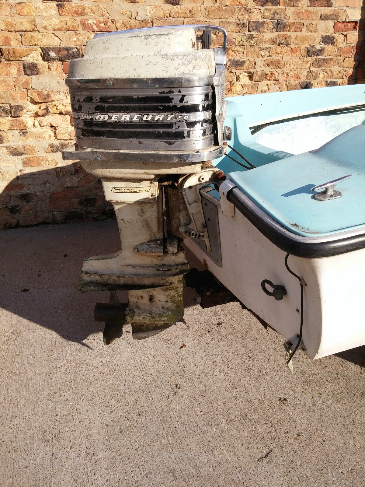

Hello
Can anyone tell me what type of connection and fuel tank I would need of the same period as my 1963 white cloud Merc 50.
There are several tanks available here in the UK but I want to be sure they are of the correct age and that the connections are compatible.
