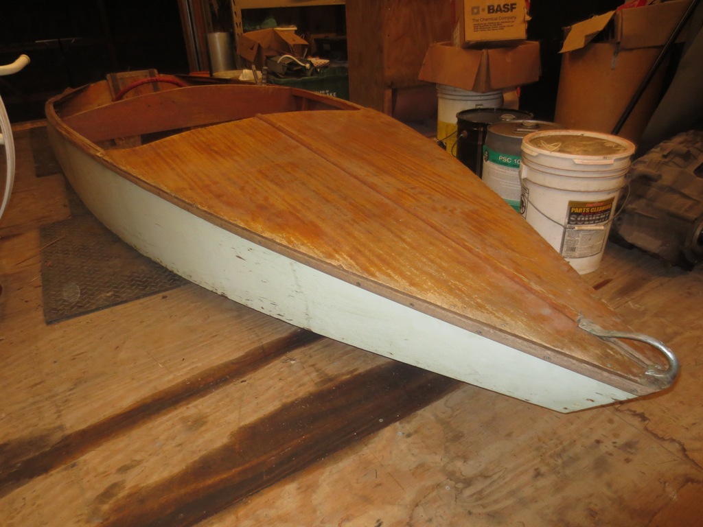

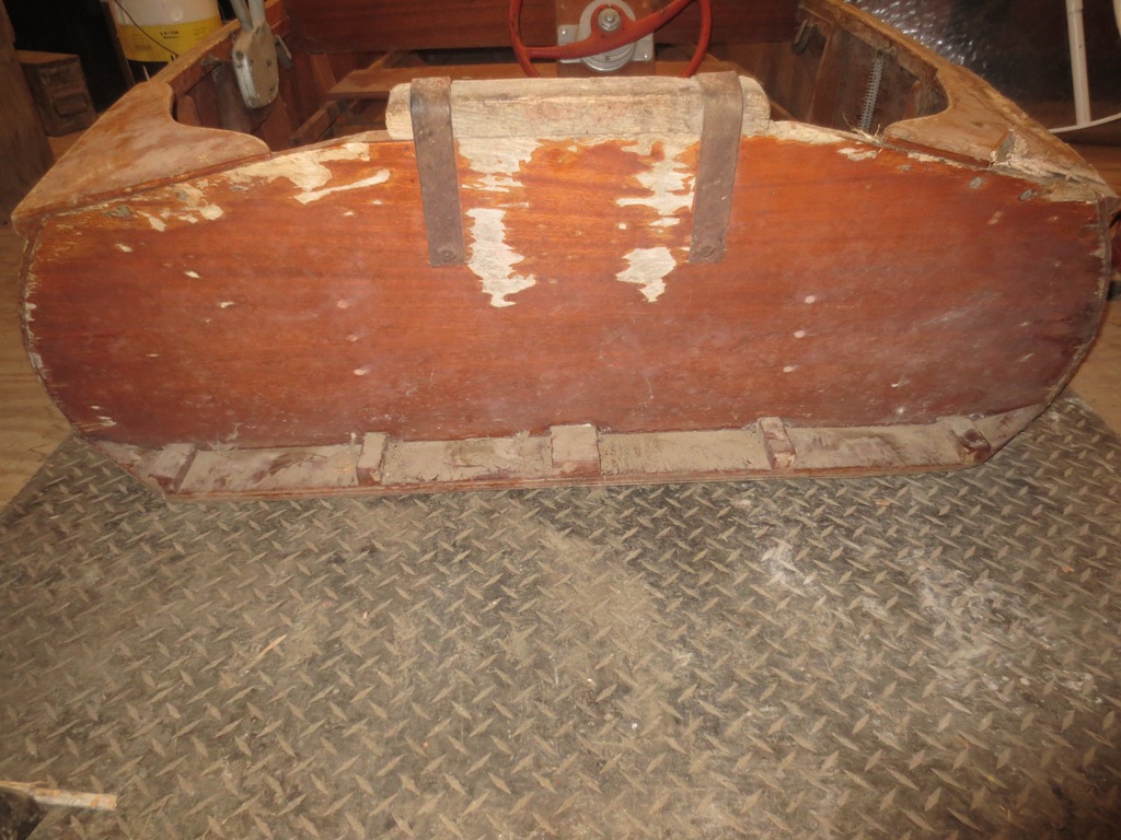

Working with a buddy to select a correct motor for this 1952-53 11’ Thompson Speed Demon.

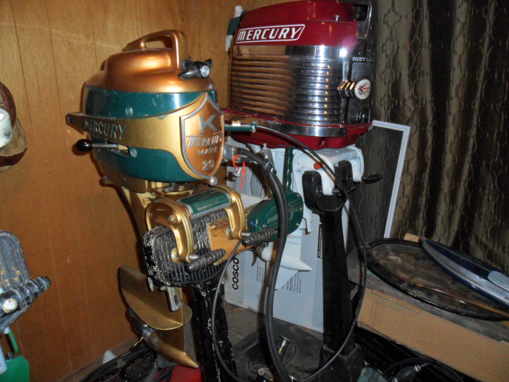

He is a Johnson guy but got him convinced to go Merc. I found a 1955 Mark 20 but I think he will need a short shaft.
Any ideas or suggestions would be appreciated.

I would say a mark30H or mark 55H. mark 20H may be small. That is a racing bo
at. the block was added for a short shaft service motor. 10ft was a B classMark 20H
11ft would be a C class. Mark 30H
