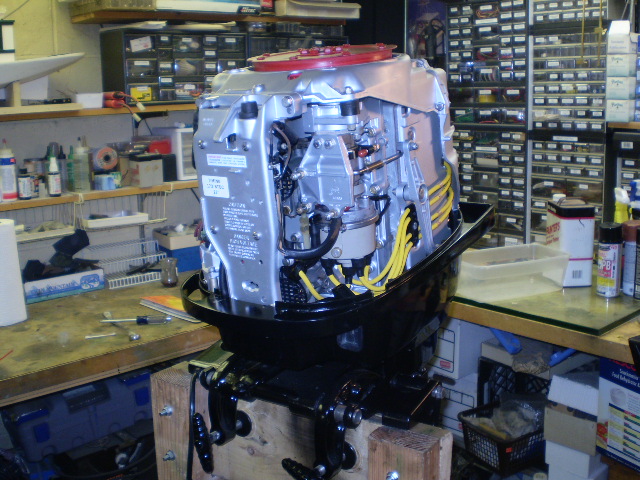

When I rebuilt my '69 Merc 80, I took it to the dealer for it's first fire-up. I spoke with the manager and specifically hired the oldest tech in the shop. When I booked him, I also booked a repair bay for the entire Saturday morning... no disruptions! Two hours later, my Merc was reborn! It was worth the 93 bucks an hour. After all I had well over a grand into it and six months of my own time.
Worth every penny..... If anyone is interested here is my re-build link
