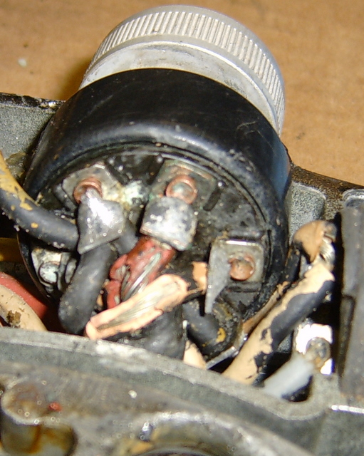

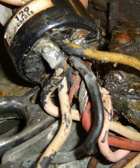

I suspect your ignition switch itself. There are rotary contacts inside the switch itself. I had a switch go flakey on me.....a brand new one after a few years.
Switch contacts can go bad and secondly switches can be damaged by way overheating the terminal lugs when doing the soldering. So either way if switch was replaced or not it's a likely suspect.
On my situation it was cutting on and off the 12 switched volts to the switch box. The problem was random yet would happen with pretty good frequecy. In addition to cutting out while underway, I could also rely on a few cut outs while cranking. Motor ran in "start" but when you let go and key rotated to "run" it would stop cold.
My guess is either the constant hot 12 volt inside rotary terminal is flakey, which if your choke works when motor conks out then that's OK or the rotary terminal on the switched 12 volt terminal that connects to the switch box is flakey. Either way, switch is not repairable so a new one is in order.
On mine if I rotated the key a few times, quickly the issue would go away....for a while.
At the switch box l probed for power at time of issue and I simply jumped the constant 12 to the switched 12 when problem occured and that fixed it and further it never happened while jumped this way although this keeps motor running till you remove the jumper, still it proved the switch was bad. I put a new switch in and no issues now years later after doing so.

Sounds to me like the ignition switch is kaput.
Re:1977 1150 Random Electrical Shutting Off Issue 9 years 8 months ago #129935
  • Robby321
  • Robby321's Avatar
  • Posts: 902
  • Karma: 42
  • Thank you received: 10
I'll second that..seen it
