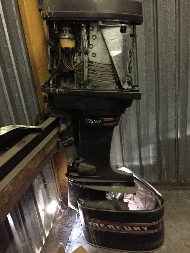

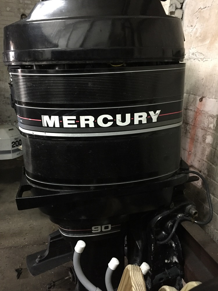

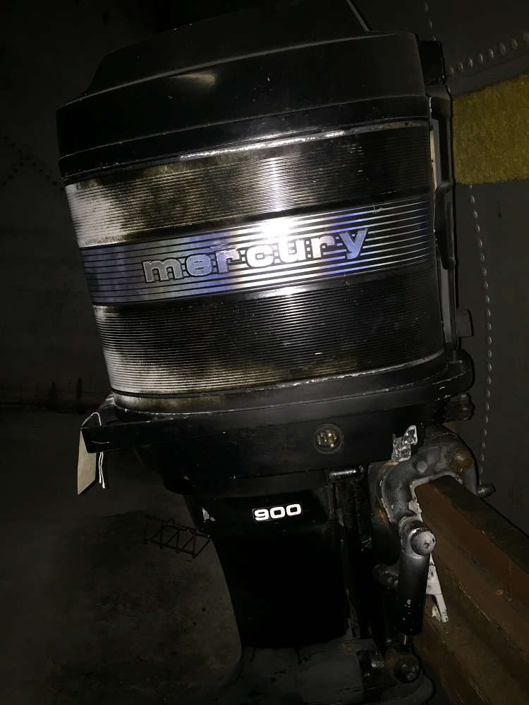

A friend of mine recently bought a marina. These and others came with it. I have a chance to pick up these three Mercs. I don't have any information on how long they have been stored, whether they ran or not when put away. Also don't know yet if there are controls and wiring harnesses for them. What years are they? Are they worth saving? What would they might be worth?

The 1st one is an '86-or-so 115hp (edit: well, it's a 90hp isn't it. Need to go to the eye Dr. I reckon!); which was rated at the prop and so has about as much power as an earlier crank-rated 140. Excellent motor, the last few years of the Inline Six were its best. This motor also has an integrated power trim & tilt and that PT&T center section alone is probably worth $400-500 on eBay.

The 2nd is 'circa-'71 115, this particular model has HUGE ports and can be upgraded to a rip-snortin' 135hp with changes in carburation and, internally, to reed stops. You have to crack the crankcase for that job. Distributor if it's working is worth $300-$400 on eBay.
The 90hp is a '78 model with distributor. These have small ports and are very torquey but run out of steam above 4500 rpm or so. A good motor for a cruiser, nice n' smooth Six power and good hole shot, with excellent fuel economy.

As pointed out by my Good Buddy Dr. Frankenmerc, the 1st motor is a 90hp. I guess I was blinded by the Bee-You-Tee-Full striping and shiny Phantom Black paint! :S
Still a good motor, what would have been a 115hp at the prop in older times.
So there you go, now if you do run across a 115 that looks like that, better snap it up too!!!
