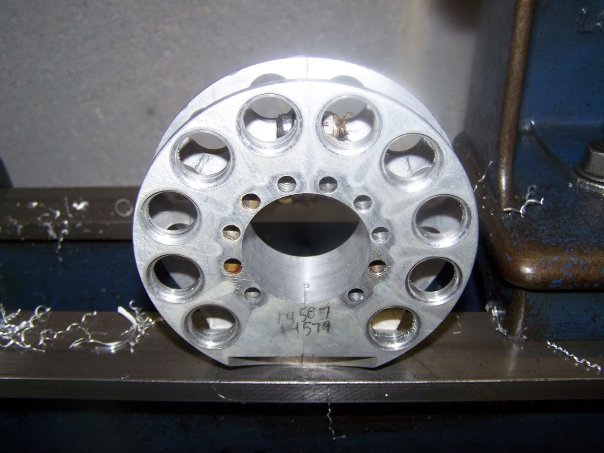

Is there a way to inspect the reed blocks without opening the block? Such as snaking a cable camera into the block with the carbs off or some such.

The Doc has had someone restore reed blocks in the past. They make a new insert, machine-out the center of the reed block and install the new insert (with pins as I recall but maybe something else too). Maybe the Doc will post with details of the process.
