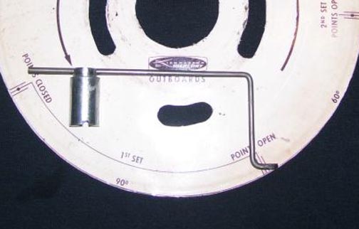

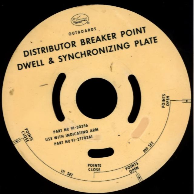

these 6's are touchy with the points & dwell setting and should be done by the book with the Dwell & sync plate
print this out but you will need to make a pointer Taco

Hi Mad props,
I have printed and it is pretty large. I think we have underestimated the importance of the points settings. I will go back to the Mercury dealer and let them do the job. There is only 2 weeks left for the classic boat race I want to run with the motor. So I can`t affort experiments anymore.
Thanks for your support!! Taco.
