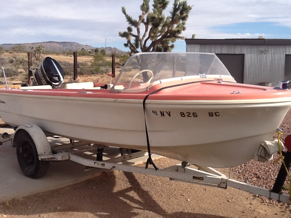

Anyway, we came home with a 1961 Performer Islander with a 1964-65 Merc 1000 on board, but elevated with the transom saver. This has been in storage, without use, for 15 years. We have not started the engine, but my husband was amazed at the clean engine after opening it up. The boat was put into storage with no fuel and had received a standard maintenance prior as well.

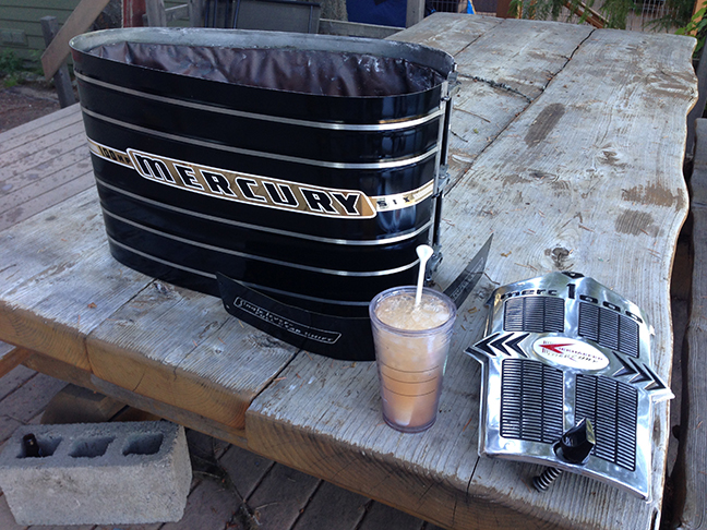

Sorry for the duplicate photos.... I'll try again.
Re:1964-65 Merc 1000 10 years 1 month ago #127669
Re:1964-65 Merc 1000 10 years 1 month ago #127670
Re:1964-65 Merc 1000 10 years 1 month ago #127671
Re:1964-65 Merc 1000 10 years 1 month ago #127672
motor is 1965.

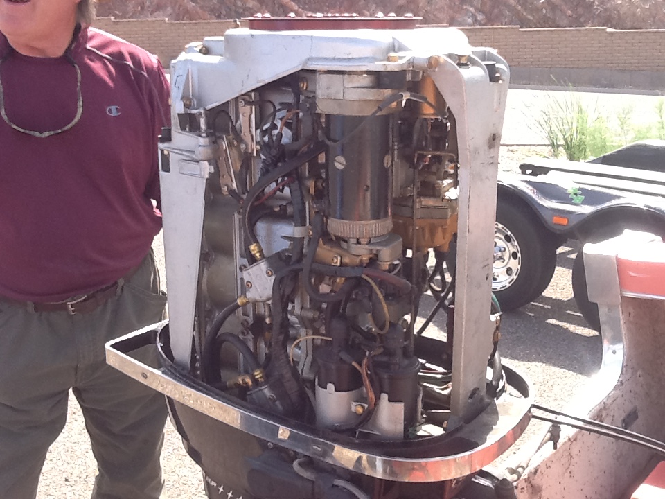

nice package, there will be some general things you will have to look at after sitting for 15 years. I just brought a 650 merc from 63 back to life after sitting for 8 years.
The low voltage wiring insulation will likely have crumbled or is about to, inspect it carefully. The grease in the distributor collar may have hardened (thanks Dave B)preventing the distributor from rotating far enough to open the carbs properly. The engine will be dry from sitting. Pull the plugs and spray engine fogging oil in there and rotate the flywheel by hand to distribute the oil. The starter pinion may be stuck from dried grease or oil. The oil in the gearcase needs to be changed as does the impeller for the water pump. Carbs will be dry and the floats may be stuck on the bottom of the float chamber. The original fuel lines will likely need replacing as they dry up and do not fit tightly at the fittings anymore. The old lines do not stand up well to todays fuel either so ultimately you will have to change them.
As you discover concerns post pics and questions, lots of help here.

Gina, this great motor, one of the first 100hp motors on the water. I am in the middle of restoring a '63 Merc 1000. I am in my second year of restoration. I am a amateur, like you.
The advice you got from daveswaves is correct. It sounds like it is a lot of work, and it can be if you let it. My advice is to approach it with curiosity and a manual. Take your time and enjoy the experience. Take pictures of everything so you know how all the wires attach and how everything is set up. Ask lots of questions here in this forum.
I am lucky to have someone in the area (Seattle) that is the Doctor of Mercury motors. Thom Adams, aka Dr. Frankenmerc is a marvelous mechanic and has helped me greatly.
You will basically have to take the all the items on the front of the motor off: starter, carbs, choke solenoid and coils. In restoring mine we had to replace all the wires in the internal harness. The external harness was also fried. The insulation just falls off the wires. It is a real challenge. The coils may be fried. The carbs may be goey. But the motor is a monster and worth saving.
Luckily you have some great suppliers at your fingertips. Dr. Frankenmerc has every part for that motor. Joe at fergusonpoolemarine.com/ also has every part and will give you loads of free advice, like Thom.
Thom may chime in here to give you more advice. Just know that it is a challenge, but well worth it when you are flying down the lake.

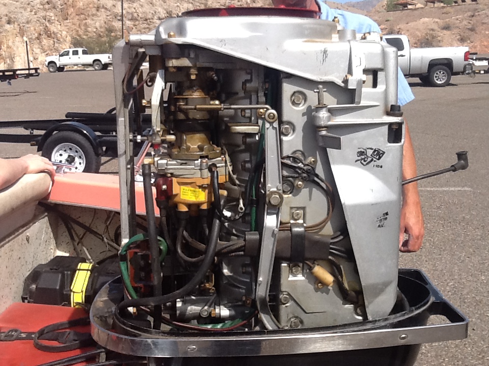

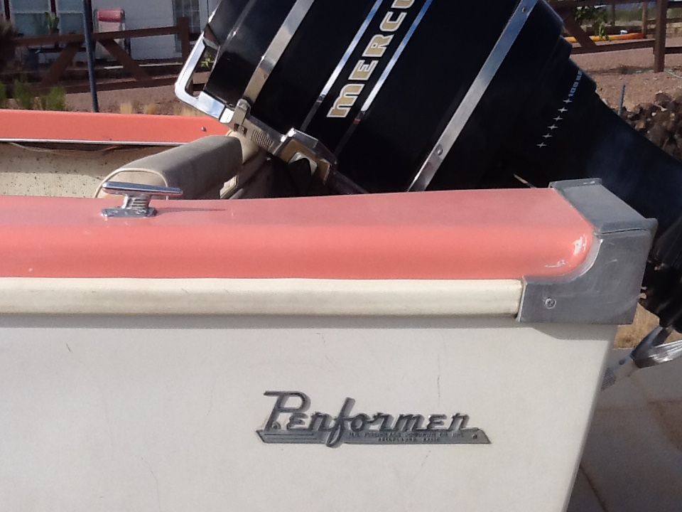

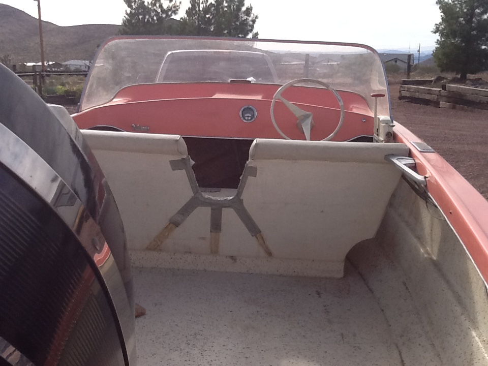

Here's some photos of the interior:
Re:1964-65 Merc 1000 10 years 1 month ago #127753
Another
Re:1964-65 Merc 1000 10 years 1 month ago #127754

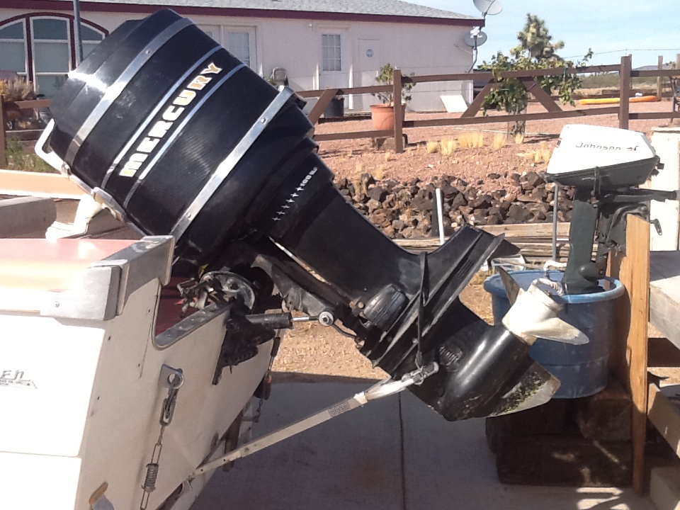

Full unit
Re:1964-65 Merc 1000 10 years 1 month ago #127755

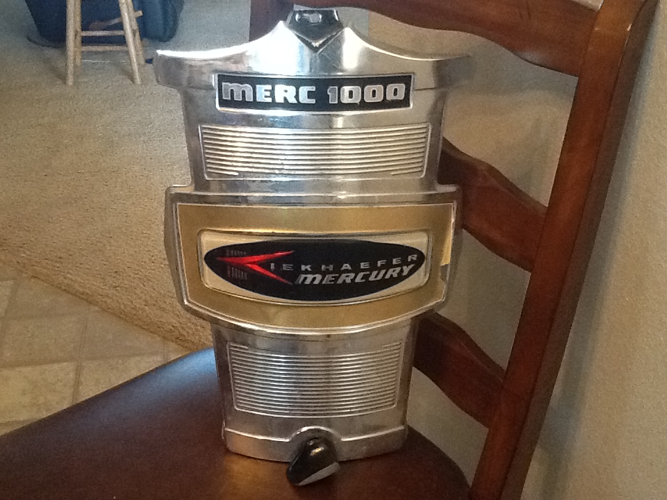

Faceplate

Have you tried starting it? Put on the muffs, give her some gas and give her a crank. Don't let it run long, it will need a new water impeller.

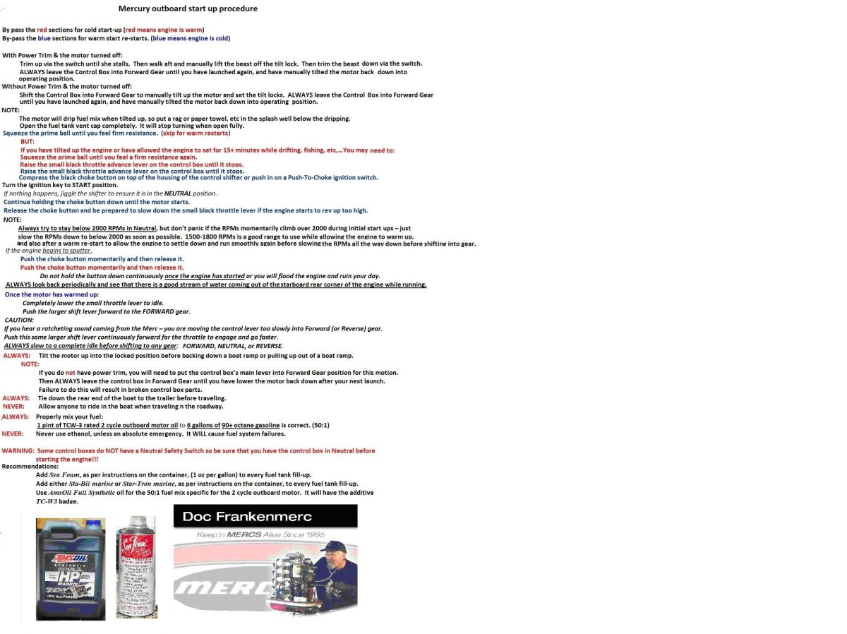

I have attached a 'start' document, that can be very helpful with both cold and warm start ups.
doc
Sorry about the E-D-B-D pix,... :P

Yes, Phil greased the distributor beforehand. He's going to try starting it today using the carb cleaner.
Thank you for the attachment. He did have the neutral throttle forward, but if it starts, we'll be sure to back it down again to keep it under 2000 rpm. The 5 gallons we put in the tank is a 50:1 mix with an octane booster additive as the fuel we had on hand was unleaded 87 octane. We'll be sure to use 90+ in the future.
