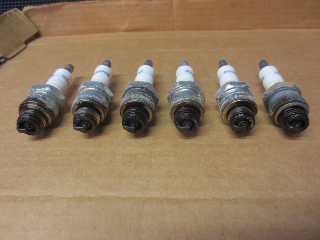

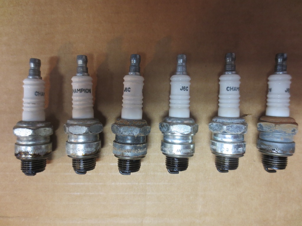

The distributor has been rebuilt a number of times over years and it was last done 2-years ago. I found this post where I had questioned the condition of the cap.
www.fiberglassics.com/glassic-forums/home/mercury-outpost/merc-800-distrbutor-cap
Yesterday I checked the points with a meter and with the plugs out. Turning the motor by hand both sets appear to open at TDC and measures .5 ohms closed.
The plugs were also changed 2 years ago and don’t look too bad although 1 and 4 appear as though they got hot. Put them in the boots and cranked over and spark looks good.
L to R, 6 thru 1
4 & 3
2 & 1
Raining here today but going to go pick up new plugs and start it again.
Thanks,
Terry

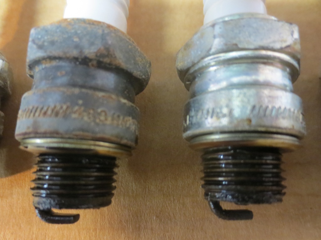

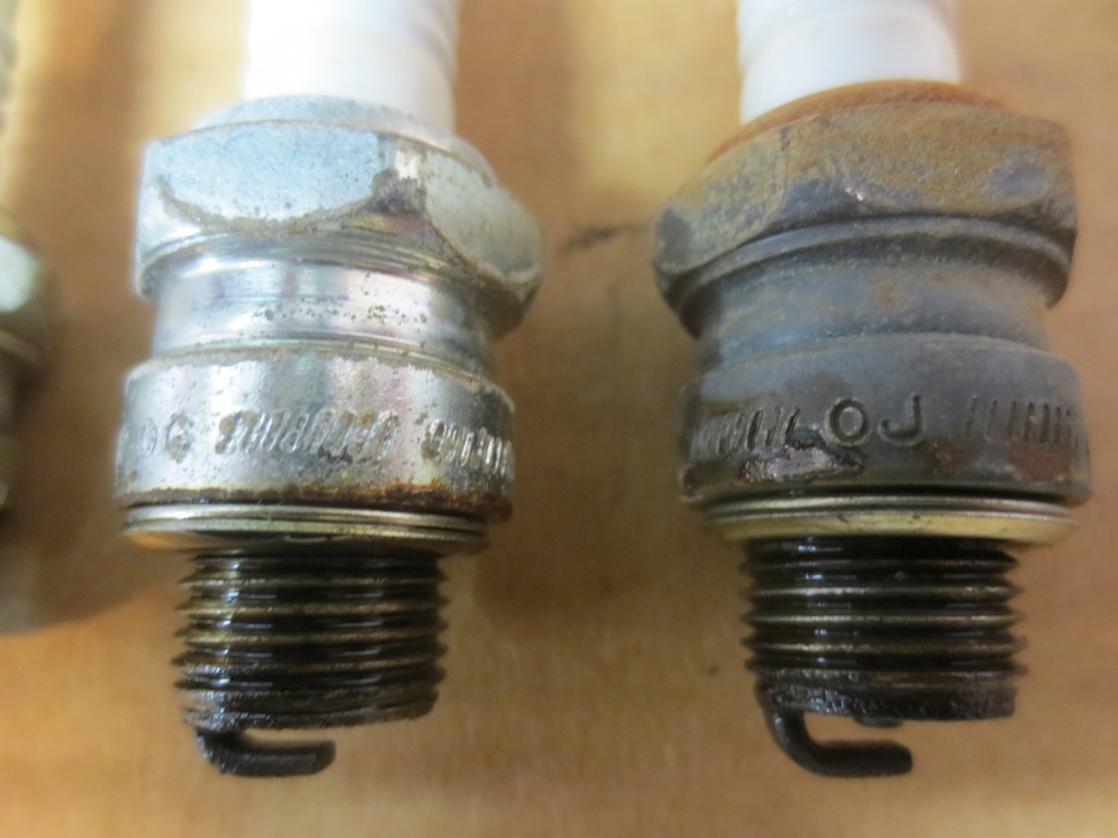

Plugs look a bit gnarly, especially that strange "glob" deposit on #5.
Maybe try a set of NGK B6S plugs, they seem to work really well in the older motors.
Re:Another Merc 800 10 years 1 month ago #127455
Number (5) does look like it needs to be cleaned or replaced, but I am also concerned with the lighter deposits on number (4) & number (2).
That looks very suspiciously like melted aluminum caused by water intrusion.
I agree with Master Ed,...Replace the existing plugs with NGK B6S, and then,...Get the beast up over 4000 RPMs, and see if a failure develops.
The reason I say 4000 RPMs, is that seems to be the magic number at which water intrusion rears its ugly head if that is an issue.
A water pressure issue.
doc

Put in new plugs and took a close look at the old plugs. Not sure what you see in the pics Doc but it appears to be carbon build up and it wipes right off.
