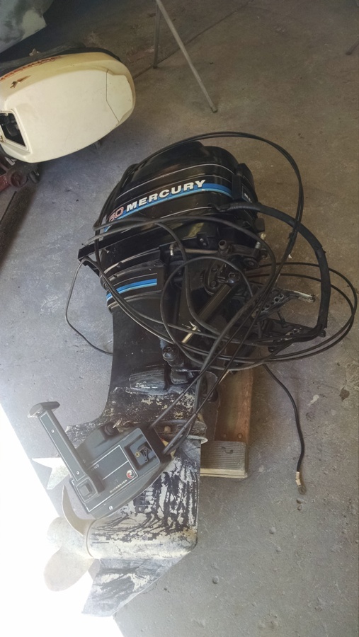

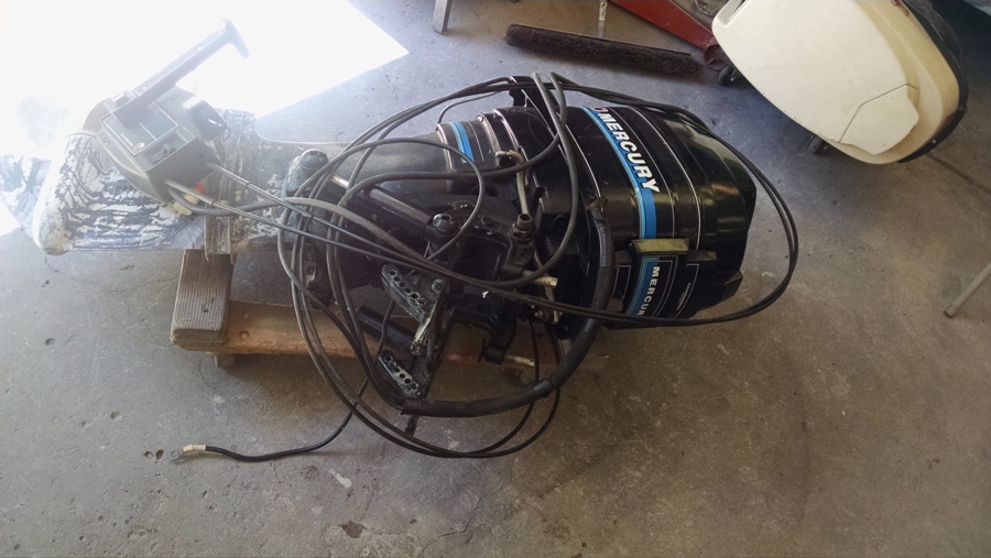

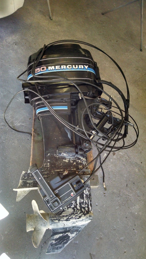

Merc guys, I am thinking this might be a dumb question but I am not sure what to do. I picked up a complete 50 that a guy kinda got screwed over by a marina. They just kept telling him he needed parts after parts, he was trying to fix it himself and they sold him a complete wiring harness with the brain/control unit (for lack of a proper term) every wire on it brand new. A new set of carbs. Just about anything that bolted on the outside of the engine. A guy we know sent him to me. He told me the story and said it had no power but would run fine just putting around. I felt sorry for him about the screwing he got and asked if they or him did a compression test?
Nope never did. I did and found 2 dead cyl's. He asked me if I would follow him to the lake so he could unbolt it and drop it and tow him back. I said no can't do that and that he could sell all the new parts atleast. He was so upset that he just wanted it gone out of his life. He asked if I would give him $50.00 for it and like a dummy I did. So I am stuck with a lot of new parts but nothing to put them on.
So 1st off I can't find a tag on it to figure out the year, any ideas? 2nd, what other engines could I use the parts on? I found a nice 80 with trim that is the same color stripe's but the guy has no idea what year it is and won't send me a tag number. What can I do with it? will these parts work on the 80? I would really like the 80 for my Grumman. Here is a pic of the 50, the 80 looks the same but I have no pic's of it. Strpe's are 2 tone light blue with red numbers. Idea's I am thinking mid 80's?
Re:Help ID a late model 50 and 80 10 years 1 month ago #127099

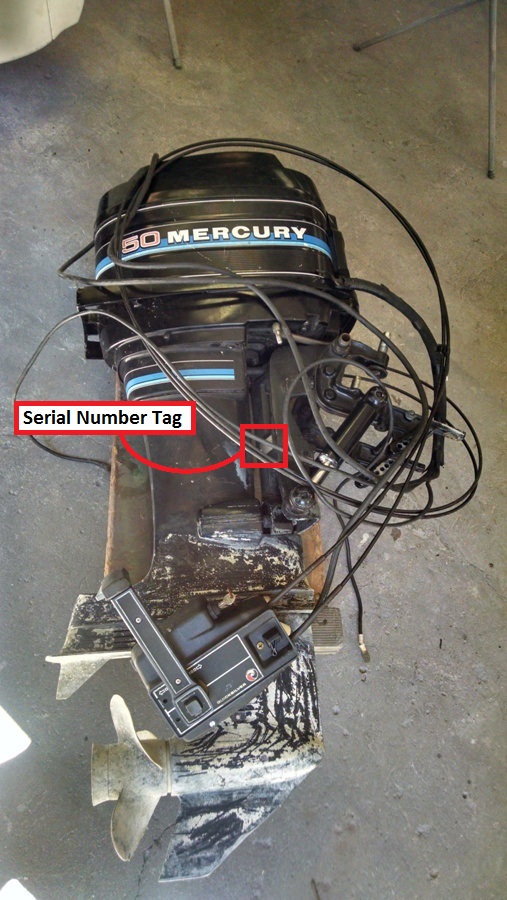

It strongly appears to be a 1980-83 model. The serial number plate can be seen in the first picture, but is a little covered by the control cables.

Re:Help ID a late model 50 and 80 10 years 1 month ago #127201
"The 80hp I am looking at has pwr/trim and appears to be a 83 also. Both 4cyl. and just would like to know if the electrical parts would work on it from the 50."
It looks possible that the stator from the '80s 80HP, MIGHT work on the '80s 50HP,...BUT
You are going to have to provide the serial number for the 50, as there were several styles of stators used.
The OEM part numbers don't match on the stators, but the after-market CDI-electronics stator part number is the same for both IF you have the right serial number group.
The switchbox part number is the same for both the 50 & the 80.
The trigger assemblies don't cross - probably a difference in the shape of the link connecting to the throttle linkage.
If you can not read the serial number on the tag highlighted in the attached picture, let us know and I'll check a block and see where the welch plug is located that also has the serial number stamped into it.
doc
