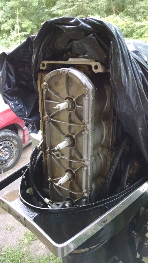

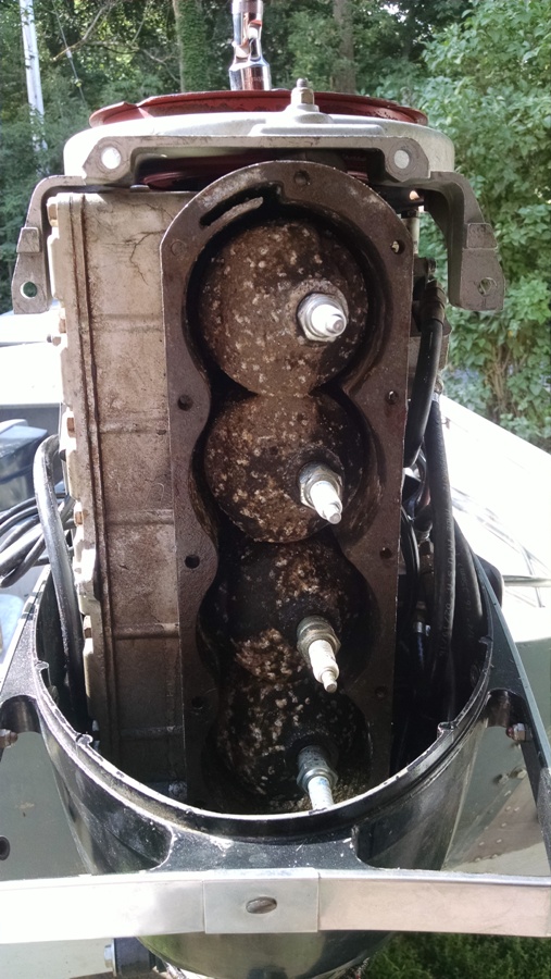

My 67 or so I think it is,#2165005 65hp 4cyl that I have on my Grumman started blowing water out around the #2 spark plug. Nothing in the cylinders and I am hoping its just the gasket on the water jacket. Is this common? can I change it without taking the power head off? I don't see any cracks so I am thinking gasket I hope I hope.
Anybody? Ideas?
Re:1965 65hp water problem. Help 10 years 3 months ago #125420
That is one HEAVY engine for that boat!! The holeshot must be something to behold, and you would need a gaggle of friends in the bow to stop the porpoising. Anyway to your question, yes it is just a gasket under that cover that can be removed and replaced without exposing the cylinders. The 650 has a blind bore with no separate cylinder head. It can be replaced without removing the powerhead, but I always do anyway to make for a better job. It is hard to clean and check the surfaces for straight otherwise, and it is worth it for the sake of a little extra time and a few more gaskets.

cosmic12 wrote:
Thanks Ed, I hope this fix's it. I hate to say it but these Merc's are really beginning to upset me.
Should I use any kind of sealant? what kind?
I dare say that any mfr's 51-yr-old motor would have issues by now! It's not like it's a 15-yr-old "plastic" motor like they are now making, where the parts all seize in the plastic and you can't heat 'em up to release 'cause you'll burn it up, and many many parts already obsolete!
Any old motor is gonna require maint and no reason to fret, that's just the way it are! The payback is how cool they look and how nice the old Mercs run when you're done.
Yours looks like a freshwater model and the bolts should come right out. If they don't, be very careful and heat up around the bolts with a propane or MAPP torch.
If the gasket surfaces all look nice'n clean and aren't pitted, you could assemble the gasket dry. If the gasket you get has a shiny glue on it, you definitely don't need anything.
If it's just a plain old uncoated gasket, a little Permatex #3 wouldn't hurt if you desire to use a gasket dressing.
For serious sealing on pitted surfaces, you might have to go with some Ultra-Grey, Ultra-Black, or Hi Temp Red RTV on the inner machined surfaces around the spark plugs.
That's the only place I've ever had any serious erosion issues. The only thing you should ever need on the outer portion of the block is a gasket dressing.
Brush a thin coating of #3 on the bolt threads and they'll never get stuck, either.
Hope that helps, give the ol' gal a break and think some nice thoughts at 'er!...........ed :kiss:

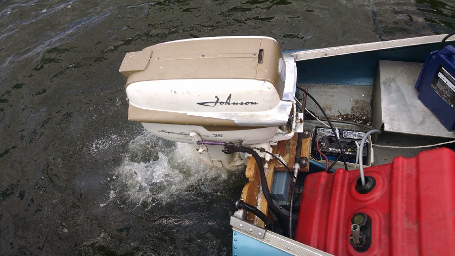

I picked up a 58 Feather Craft for a friend 2 weeks ago that has a 58 35hp Johnson that the seller said didn't run and hadn't in over 15yrs but we had to take it if we wanted the hull.
I got it home found a bad float and someone had put the low speed idle needle in wrong, fixed both problems new gas and it runs perfect just unreal how nice it is. That in itself has made me a believer in the J,Rudes. I love the look of Mercs and the sound but that Johnny made me think about what I am doing. My back ground is in I/O or srt8 inboard so this clamp on stuff is very new to me.

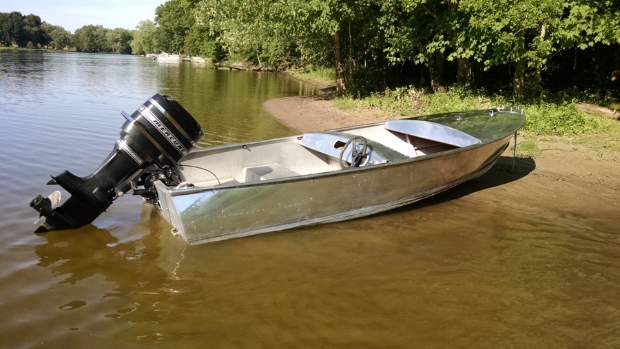

OK! well we have success!!! I pulled the cover off and found the gasket rotted around the top 2 plugs, surprise surprise. I glass blasted it and cleaned the head or whats supposed to be the head. After getting all the broken bolts out and I mean all the bolts.
A friend that builds vintage racing sleds gave me some stuff to fill n seal the pit's I put it all back together and oh it runs sweet now. The hole shot is a blast and the cornering is even more fun. I have moved the weight around and have it running very flat. Now I need a SS prop hopping to find a bit more speed. Only running 45/47 on the Phone GPS, was thinking it should be more.
Thoughts?
Re:1965 65hp water problem. Help 10 years 2 months ago #125922
Sounds pretty fast to me on that boat. Looks like a real hoot!
Good job "staying with" that Merc through the tough times. Looks like it was worth it!
Stay calm. Move on.
Re:1965 65hp water problem. Help 10 years 2 months ago #125986
Playing with trim, engine height and props will give you a little more speed, but it seems like you have a good "all rounder" there. Hell of a boat.
Re:1965 65hp water problem. Help 10 years 2 months ago #125987
Man, that is a cool ride just as it is!! Jack it up and trim up and see I ya get more speed, but 45-47 is kinda fast already on a tin can LOL!! Very beautiful boat!!

The height seems right, cavitation plate is dead nuts with the bottom and if I trim it up it bounce's like crazy. I had to lower it to the bottom slot to get that out of it. The hole shot is great and it turns on a dime but I just want that magic 50mph mark. I haven't been able to find a prop with the right Hub yet but still looking. Any idea's on size? pitch ect.
