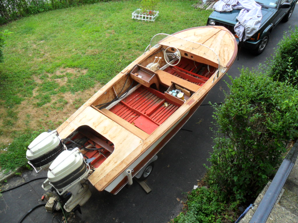

Here is my twin 500's

Thanks for the picture, looks like a sweet ride! What's it cruise at?
1960 14' Speed Queen
1972 10' Tri-Cat 3
[Building] 10' Glen-L Squirt
Re:How to hook up twin Mark 30's 10 years 3 months ago #125317
have not run it yet, but I am shooting for 40-45 mph should be doable.
