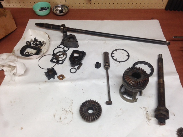

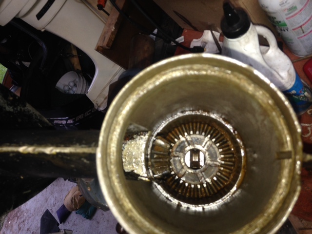

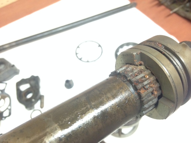

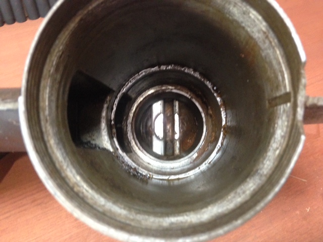

Updates - worked with my buddy the mechanic to finish taking apart the lower unit. We were going to weld a tool, but ended up just cutting an old socket into a shift shaft removal tool. Everything popped right out after that.
I have pictures for the Merc experts to pore over and advise.

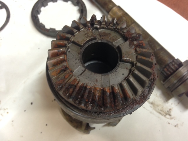

Reverse gear has the most rust. I assume there is a bearing under that gear in the bearing carrier, but it feels like the gear is welded on. New bearing for sure, and I think i can clean up the gear. How do you get the gear off if you don't have the bearing removal tool - looks like a slide hammer?
Forward looks to be in pretty good shape with just a little rust. Have to try cleaning the bearing to see what it looks like because it is a little rusty. That might be from me turning everything once it was freed up.
Impeller
Prop shaft
Forward bearing holder
Until now I wasn't worried about working on it because it could have been junk. Now that it looks like just a little rust was causing all the problems, now I need to treat it like a lady. Waiting to hear your suggestions.

To the Merc experts - is the clutch supposed to freely slide on the prop shaft? Not quite sure how that works in relation to shifting from forward to reverse. I see the cam which looks like it moves the prop shaft from forward to reverse. Is the clutch fixed and the prop shaft moves?
I just need to know what to be concerned with while I am cleaning everything up. I got a little sticker shock looking on marineengine for the lower drive bearings. The reverse bearing is $75!!! The forward bearing looks specific to the application, but is the reverse bearing just a "normal" bearing where I could find the correct size bearing and put it together? Still need to work on getting the reverse gear off. Maybe Sunday before the Packer game.
As usual - any assistance is appreciated!!

The clutch is spring-loaded and yes it must be free to slide to the rear for Neutral and Reverse. You probably need to clean up all the visible rust, lube it up and work it a bit. Or take it all apart if it won't move freely. Under that spring-keeper (which just unwinds from the slot) is a pin that keeps the spring in place. If you drive out that pin (careful it's under a lot of pressure) it'll all come apart. Be sure to capture all the pieces and note where they go!
The reverse gear bearing is non-tapered ball bearing, so you should be able to get the numbers off it and find a replacement. Not sure if it'll be cheap, though! Maybe less than Merc wants, anyhow. Stay away from Chinese eBay bearings, be sure you get a name brand such as Fafnir, FAG, BCA, NTN, SKF. These are all quality bearings, the Chinese junk won't hold up.
BTW a bearing "splitter" will likely be necessary to get the rev. gr. bearing off far enough to get a jaw puller behind it.

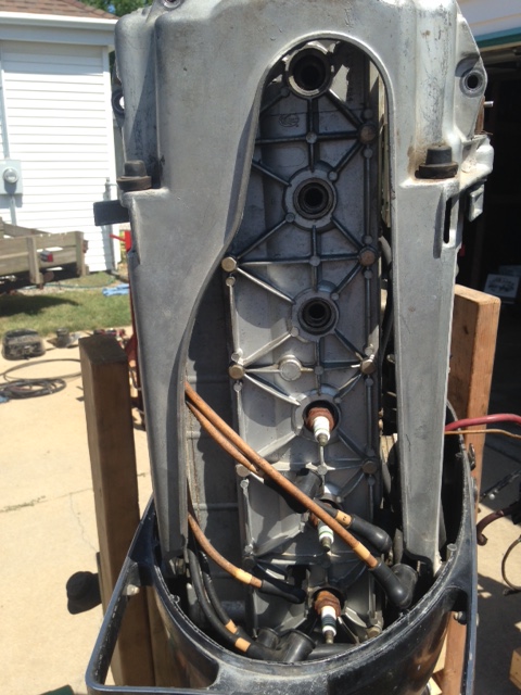

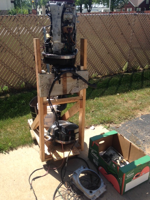

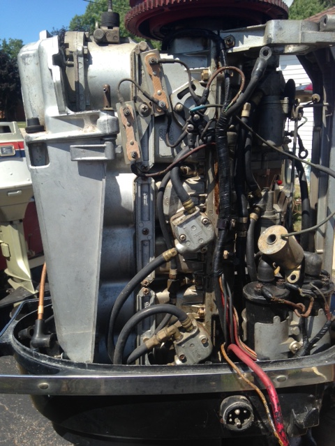

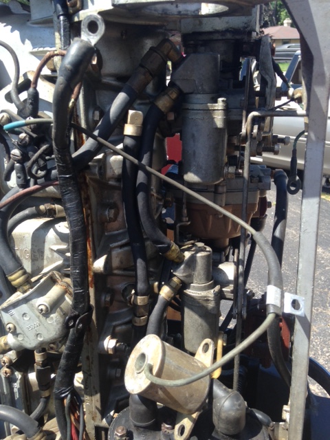

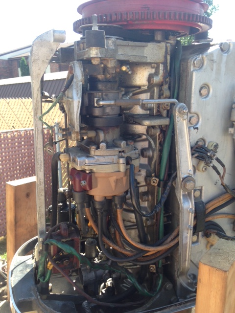

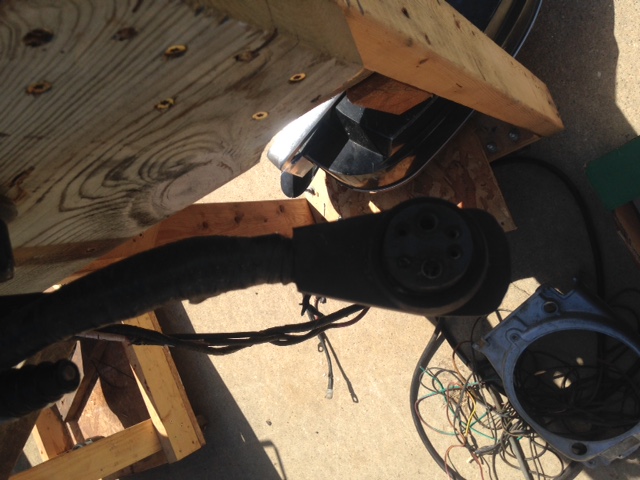

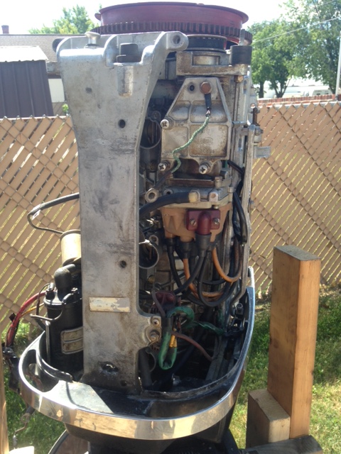

Thanks for all the help so far. Finally got around to rolling it out in the sun to let you see what the top looks like. Right now looking at whether I should scavenge some of the wiring from this motor to get the 63 Merc 850 up and running or if I just need to source everything else.

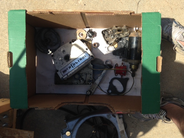

Pics for the experts below:

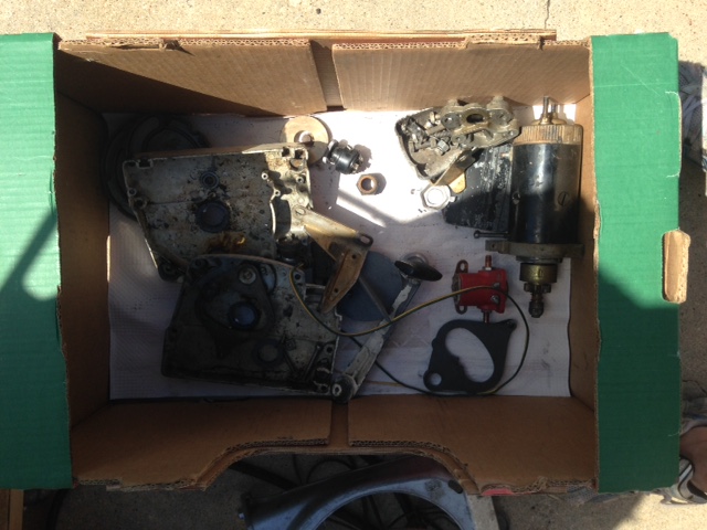

Box of parts - starter, controls, solenoid, etc
Should I grab this for the 850?
Choke solenoid is not set up. Does it need to come off with the starter?

Looks like the correct external harness for a Dual-Coil ign system.
The choke solenoid on the later motor mounts on the removeable upper cowling support. On the older recoil-starter motors, the solenoid mounts up inside the recoil housing.

Should I scavenge for the 850, or just find something for the 850 elsewhere?
Re:1965 Merc 1000 - lower unit was locked up - HELP!! 10 years 2 months ago #125650
  • ed-mc
  • Away
  • Posts: 1482
  • Karma: 235
  • Thank you received: 131
That depends on your priorities and which motor you most desire to get running.
There are quite a few of these still kicking around on eBay and Craiglist (not to mention in the Hot Little Hands of many Fiberglassics members!), so you're bound to eventually run across more Good Stuff.
Time to troll eBay and Craigslist for more parts!! :woohoo:
BTW that control box with the correct harness on eBay hadn't any bids the last time I looked at it, for $60 or so it was pretty cheap.
Still available, auction ends 6:48 PST, $83.09 shipped:

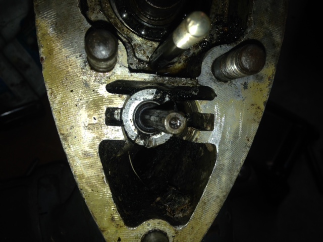

it looks to me like the reverse gear is toast, the ramps where the cluch dog hits is damaged badly and will jump in and out of reverse and the exhaust housing is missing some, I would find another lower unit, gears and a dog and bearings will cost a pile

I will get some more pics of the gears. The bearings are definitely in trouble, but I didn't think the gears looked too bad with mostly surface rust except for a bad tooth or two.
