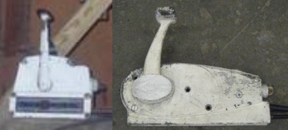

I have seen two main styles of MerControls for boats from the 60's give or take a few years and want to understand what should be there as well as what would work properly. The two are square versus shaped - will either work or is one more appropriate for the ski boat?

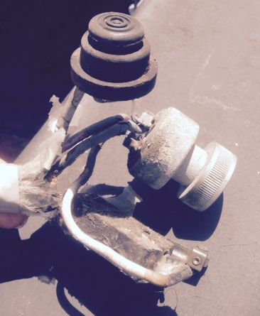

The end of the wire harness looks like this (position switch / key ignition and electric choke button - I think):

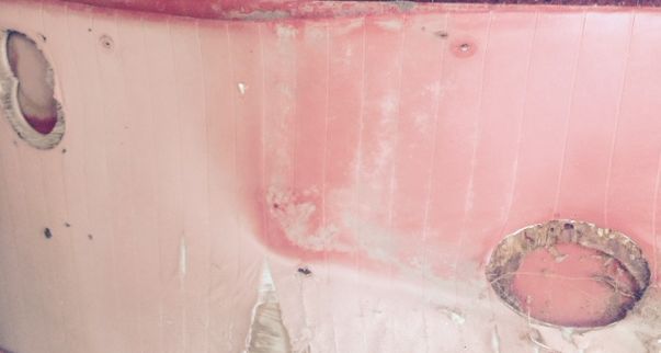

The panel it was mounted to looks like this (in case mounting holes tell the story):
The left side of the panel area has a double hole cutout for the power trim 3 button controls...
Re:What MerControl will work (1965 1000) 10 years 3 months ago #124710
Either box will work, but it is very tough to find control cables that will work in the larger oval control box.
The square box uses control cables that can be purchased new still.

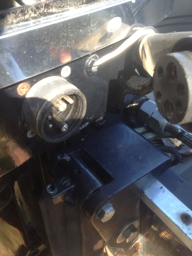

The external electrical harness for the '65 1000 has to match the pin configuration of the motor's internal harness, so if you don't have the external harness (goes from the ignition key back to where it plugs into the motor) you'll want to be aware of this issue when you are on the hunt for the harness.
That ignition switch, etc is from the square box, and so are the control cables.
Can you post a picture of the pin configuration at the engine end of the electrical harness?
doc F

Here is a picture of the engine pin configuration:

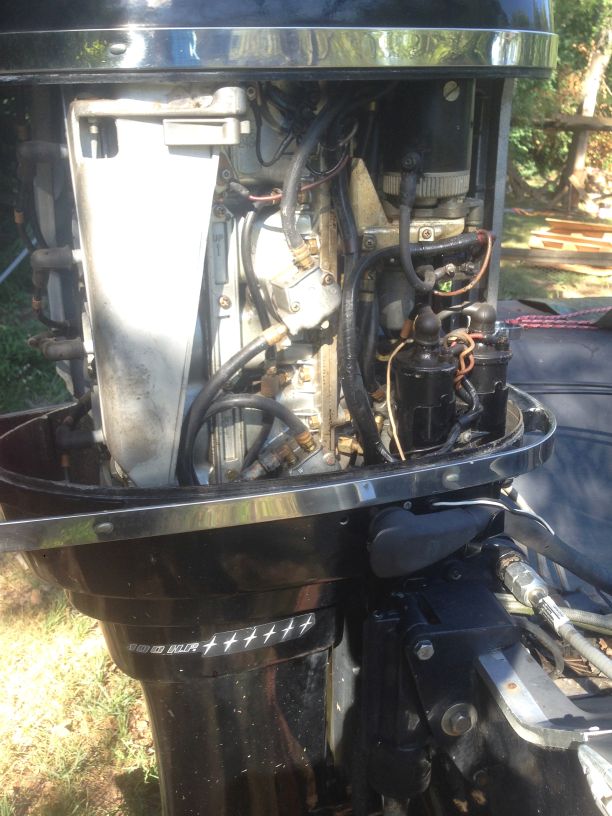

That is the first time I have unplugged it - here is how I found it (well, the cowl and medallion were on):

Hey Doc :) What is the model and HP of that sexy red beast ?

Re:What MerControl will work (1965 1000) 10 years 3 months ago #124752
Mark 75 H one of the rarest mercs I think only about 74 made.

That one happens to be a Mark 75 "F", one of Doc Frankenmerc's special creations!
Extremely rare, there's only one like it in the whole world!!

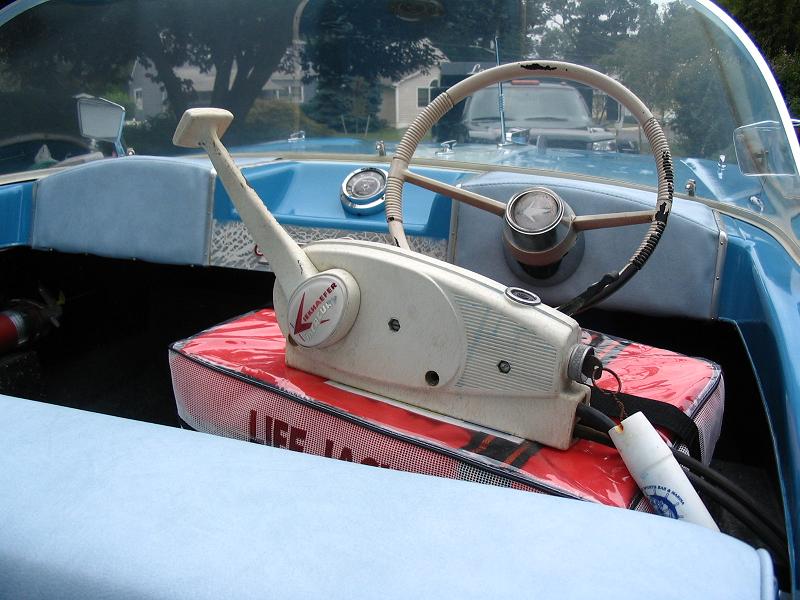

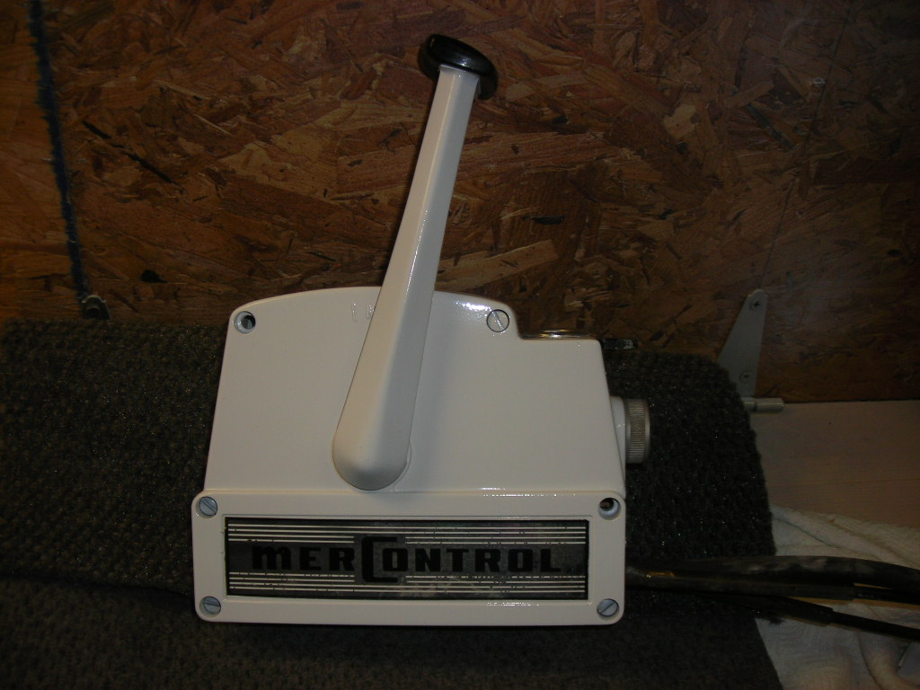

i've used both on my 62 merc 700 with no alteration. :
Re:What MerControl will work (1965 1000) 10 years 3 months ago #124830
Vuyosevich,
I see two options, could you please clarify:
1) You have the same selector cables and wiring harness hooked to the outboard but change between the two housings you show with no issues in fit or function
2) you have two housings - each with their own selector cables and wiring harness - that hook up to your outboard with no issues
The difference I am interested in is that I already have the original selector cables and original wiring harness in place I just am missing the MerControl housing and it sounds like one fits my cables but the other fits a different design of cable.
Right now I am under the impression the cables will fit one control box design but not the other (I have never seen the inside of the two boxes side by side).
Thanks for any further insight into how you switched between the two designs (control box only change versus control box-cable-harness change)
Chris
Re:What MerControl will work (1965 1000) 10 years 3 months ago #124834
the square box takes the cables that have a hole in the end of the cable.
the pepod box takes a cable that has a gear on the end.
Re:What MerControl will work (1965 1000) 10 years 3 months ago #124839
Thanks Dave.
Doc said they were not the same I just did not know how - thanks for the explanation.
Chris
Re:What MerControl will work (1965 1000) 10 years 3 months ago #124845
anytime the cable with the gear is hard to find. go with the eye still available.
