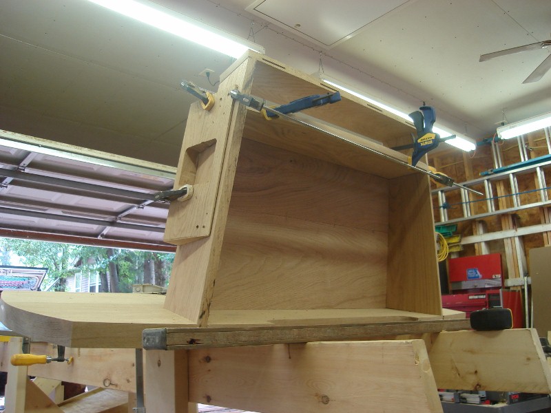

Building a boat to host the '59 Merc Mark 35A I have restored.

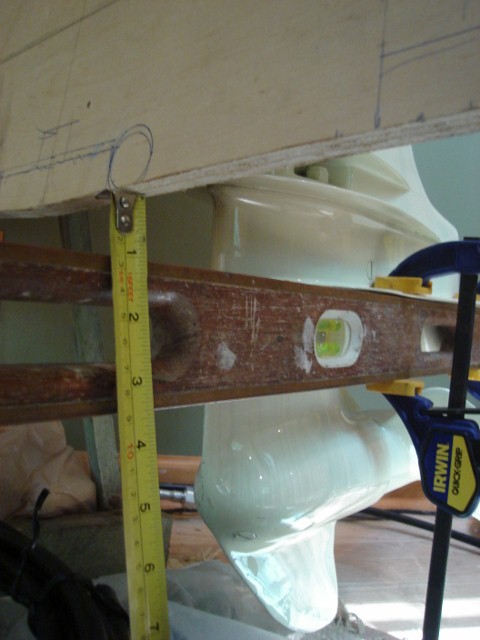

I have 'mocked up' the transom onto the engine stand and the cavitation plate is 1" below what will be the bottom of the boat, the transom is exactly 16" high.

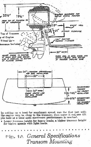

I have attached a copy of the original owners manual specifications for engine height.
I'm leaning to step up the transom height to 16 1/2" or even to 17", the baot will be a pleasure cruiser only.
