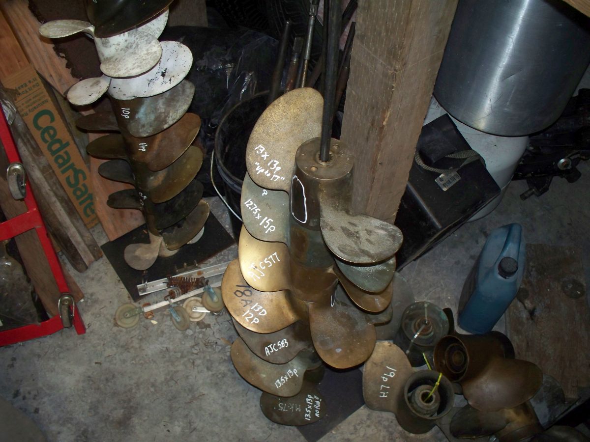

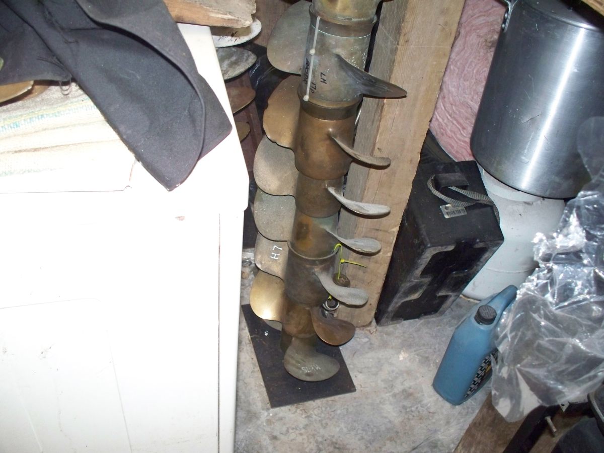

Re: 57' Mark75 finally running good 10 years 6 months ago #121964
Okay,...Here ya go:
I wrote the diameter and pitch on all the Mk 75-78 props I have.
I couldn't find the cross reference for the (2) Michigan props, but I'm pretty sure I have the stamped numbers correct.
One prop in the pile suggests that it started life as a 13P, but 'might have been' modified to a 17P, which would probably make it very desirable.
Based on this suspicion,...That one will cost you $100 + postage with no guarantee it is a 17P.
The others,...Or any other LH DR prop I have - whether through prop exhaust or earlier style - as you are hunting - are $50 plus actual postage.
doc F

Listening to it sounds a little high on R's too. Does come out the hole nice though! I think maybe the 15 might be a good choice but you can figure if that, or the 17. I can't tell from Docs pic if they is any cup on either, but add some cup to the 15 maybe?
Ya really gotta hook a tach up to see where ya at. GOOD LUCK and motor does sound "sweet"!
