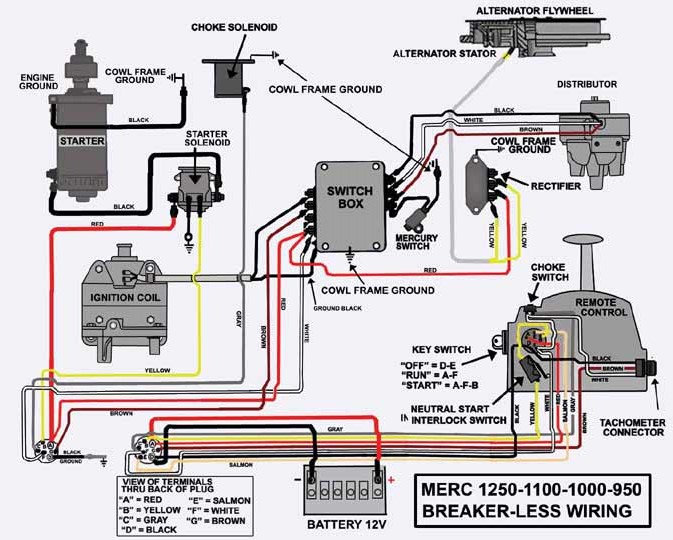

You can isolate the low-voltage problem by unplugging the external harness and measuring voltage on terminal "F" of the harness with the ign key in the "ON" position.
If you don't get 12V-nominal there, the problem is external to the engine. If you do, disconnect the white wire from the switchbox, reconnect the external harness, turn ign "ON" and measure voltage on white wire to ground. It should be battery voltage. If not, there's an issue with the pins in the harness or the wire itself.
I've attached a wiring diagram and here's a general test procedure for Merc CDI igns such as you 1000's:
