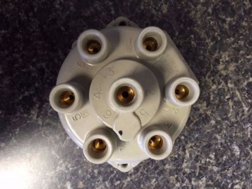

hey guys.. Once again this may be a dumb question.
I recently bought all new wires and a Cap for my mark75. Originally i thought i was going to re-use my old cap, so without thinking, i removed the wires without marking where they went. I later noticed that the cap had a crack so i found a NOS one on ebay. Now i am in the process of screwing the new wires into the cap, but i noticed there are several number markings on the top of the cap, and none seem to make sense with the 1-6-4-2-5-3 firing order.
This may be a stupid question, but can someone point me in the right direction? :unsure:

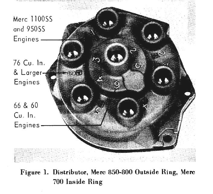

Use the very inside ring of numbers.
See attached diagram, that should help....ed
