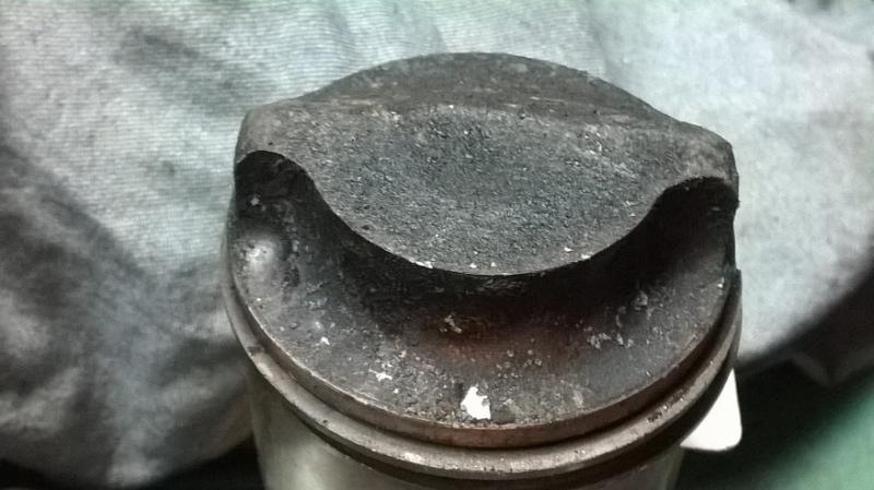

hi, i am going to be setting the max advance on a 1970ish 4 cylinder 65hp. i am using the instructions that i saved from this website a few years back, it says to set it at 34 degrees for a crossflow. i just want to verify that this engine is a crossflow, i pulled a spark plug and looked at the top of the piston and it is the same type as the one in the attached photo.

That engine is a crossflow design. My book sez max spark advance is set at 38 deg BTDC. You might want to dial it back just a bit, in deference to today's fuel quality. Highly recommended to run non-alcohol fuel if you can find it.
It'll run fine at 35-36 deg max spark advance. The older crossflow engines are not as prone to detonation as are the later 99-c.i. Inline Sixes.
