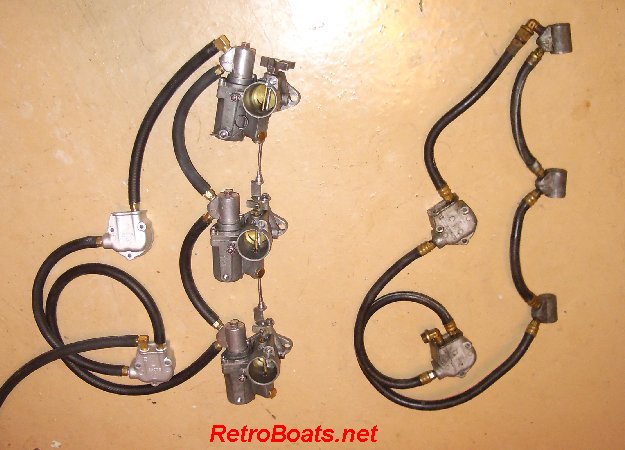

I need to make all new lines for my Merc 800 DR. Sources for parts/fittings? Anyone use a service that will make them?

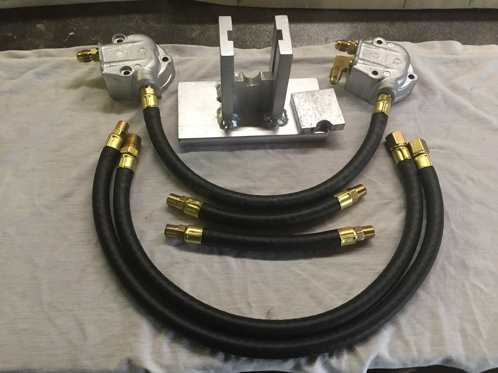

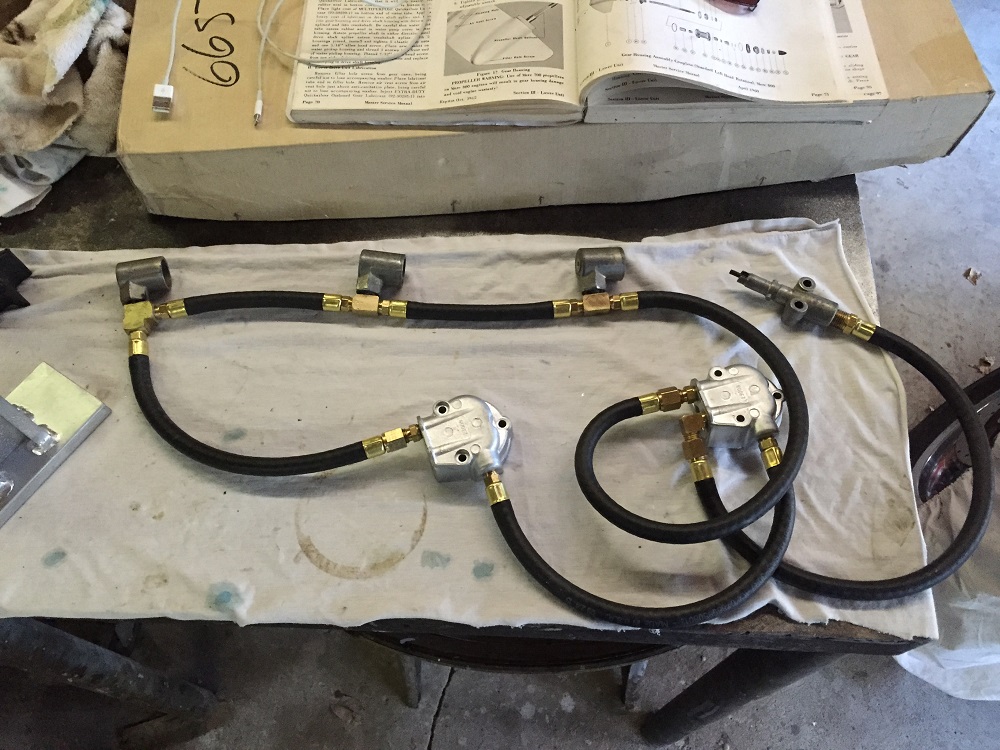

I went here. fittingsandadapters.com/ and was able to buy all the fittings and ferrules. I changed the proprietary disconnectable fittings to SAE 45 degree flare fittings. Cost for the fittings was $35 shipped. Cost for 6' of 1/4' fuel line was $10. I spent an afternoon making the fixture and the dies.
Larry
Assembled

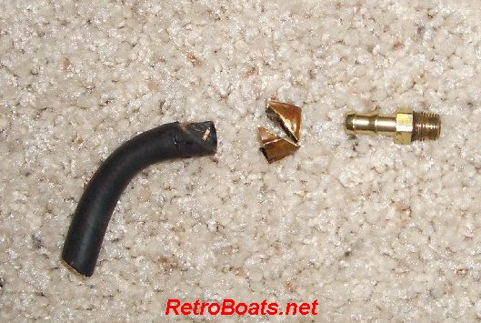

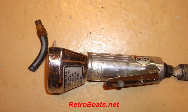

Just make your own with old fittings.A "how too"

Great job on the crimping tool.
