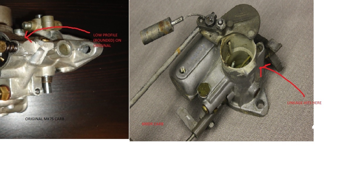

Re:mark 75 carb swap advice UPDATE 10 years 8 months ago #119865
Hey guys,
I have an update on the carb swap. the Carbs off the 600dr, will in fact bolt right on, however the profile of the carb body itself prohibits the full operation of the distributor linkages.
Basically the levers on the distributor that operate the linkage on the top of the top carb hits the body of the carb on its swing around. This could be solved by swapping to the distributor linkage from the 600, but at this point i think i am going to run my old carbs, and just re-pack the main needles.
Scott
Re:mark 75 carb swap advice UPDATE 10 years 8 months ago #119866
here is a picture of what i mean

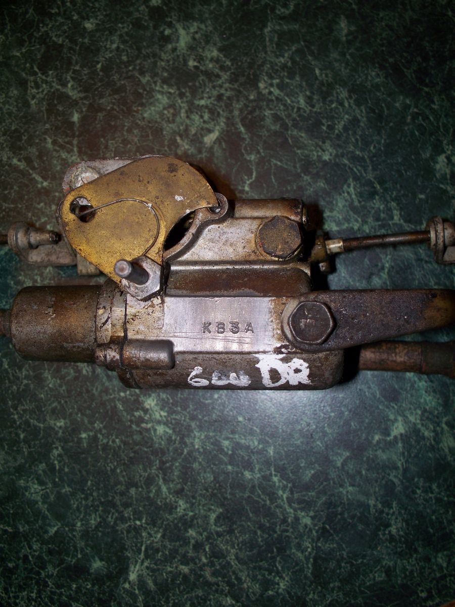

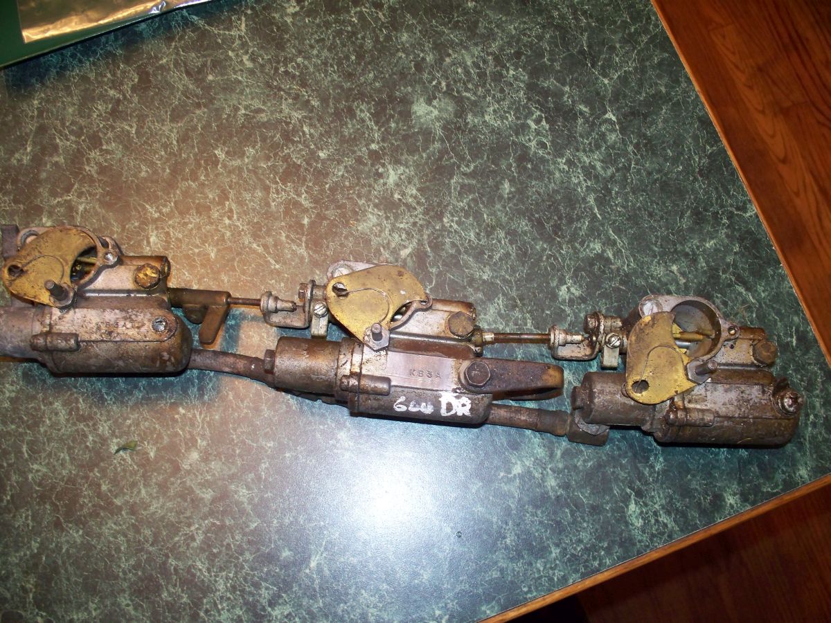

Re:mark 75 carb swap advice UPDATE 10 years 8 months ago #119967
I found the set of 600DR carburetors.
See attached pictures.
doc F
Re:mark 75 carb swap advice UPDATE 10 years 8 months ago #120170
Sorry i've been away from this thread for a few days. This darn cold has really been kicking my butt.
Thanks Doc for the offer, but im wondering if the linkage on the distributor will still hit the bodies of those carbs, where the lowspeed adjustment is?
I can definitely see a difference in the distributor linkage between 600DR parts motor i have and the Mark 75. The distributor on the 600 has a slight upward bend to clear the side of the carb bodies, where the mark 75 is straight.
Hopefully this makes sense? next time i am out in the barn i will snap a couple pictures.
