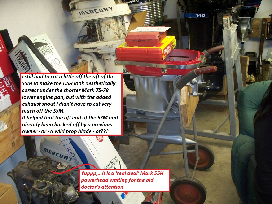

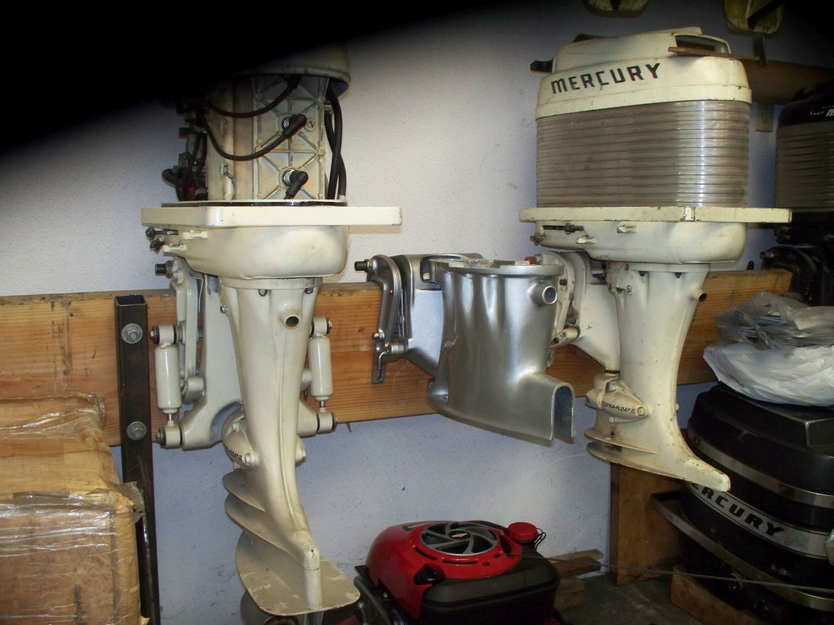

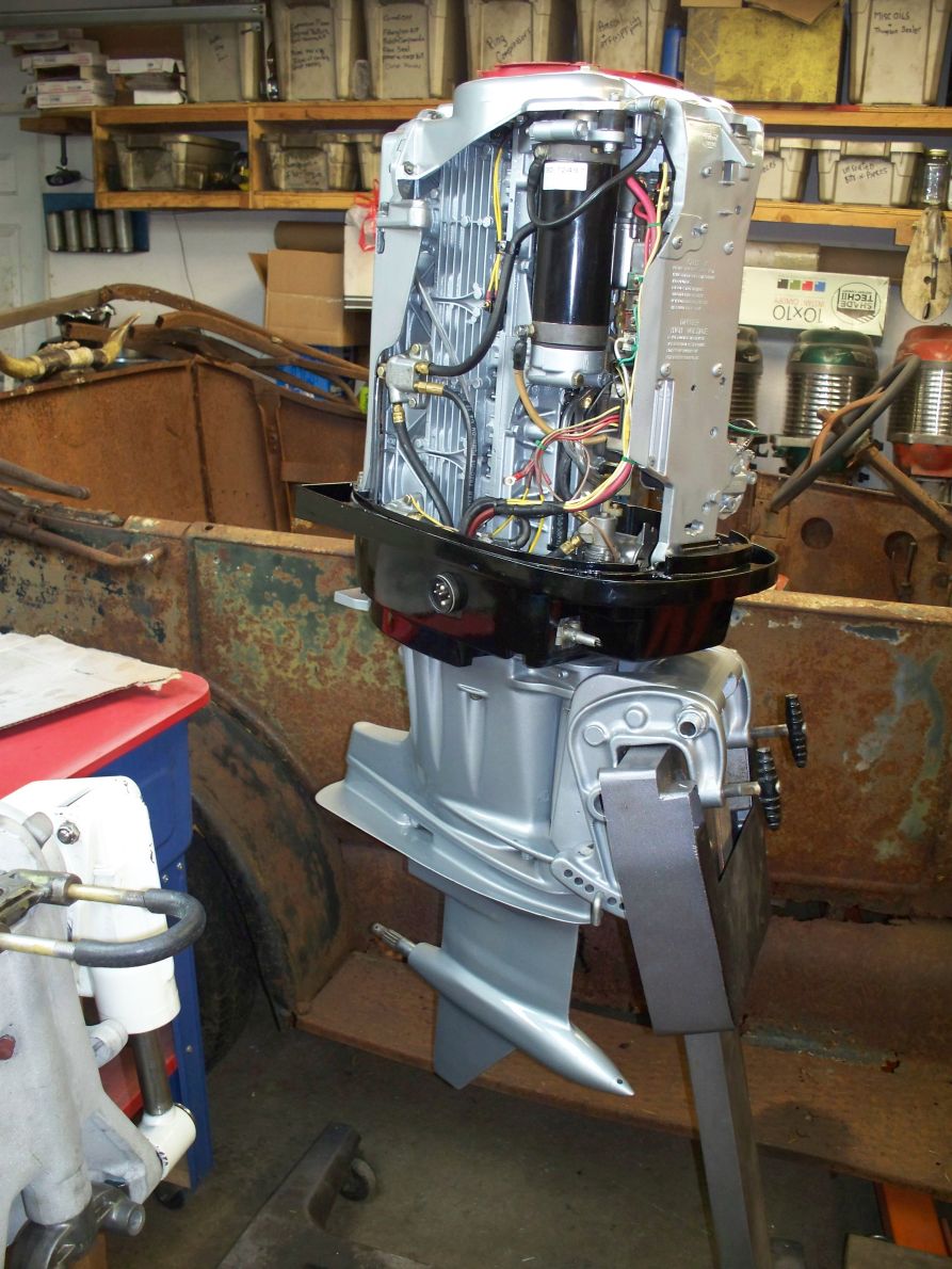

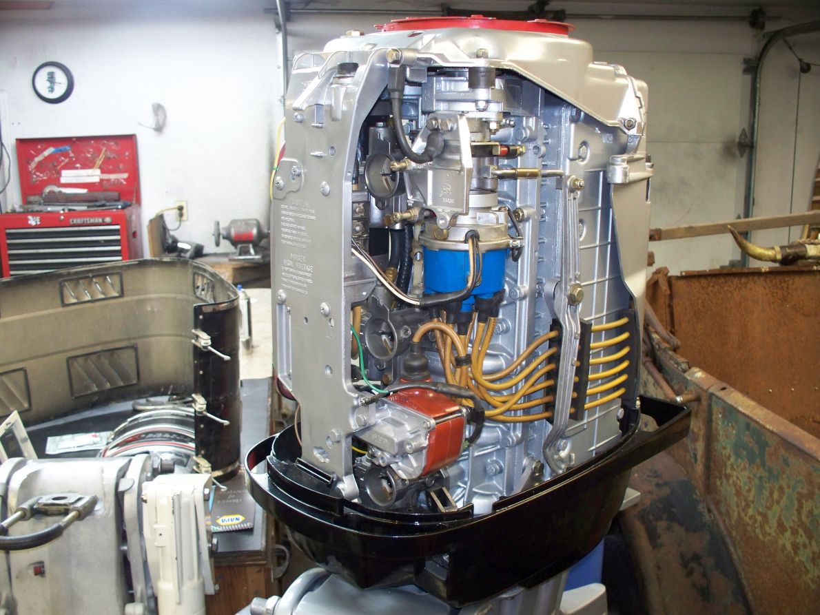

I'm not finished with it yet, but the powerhead is all re-machined inside and rebuilt.
The DSH is a Bonneville.
and the lower unit is a Mercury SSM.

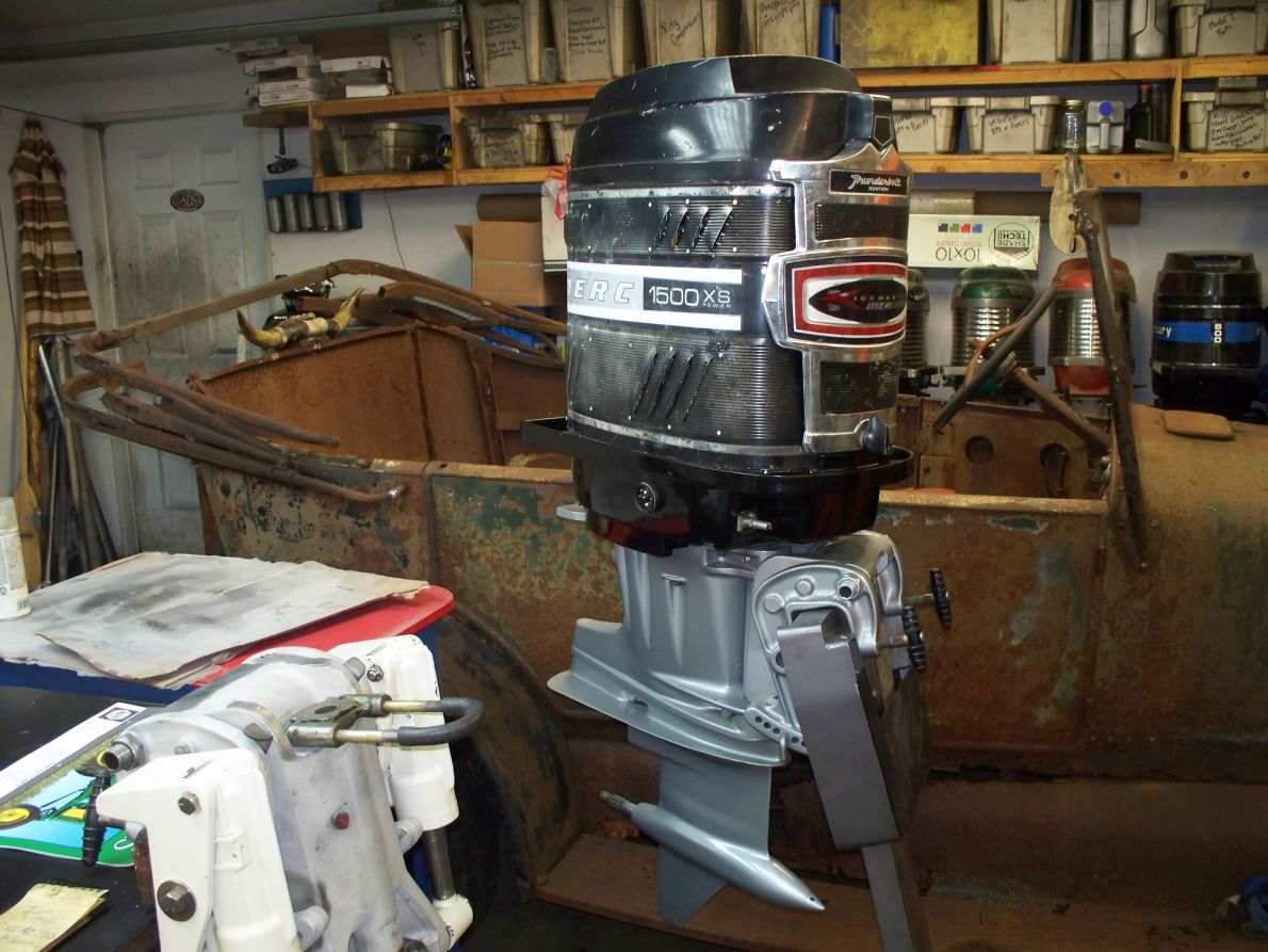

I'm not sure if I'll use the louvered 1500xs wrap on this build or not. I'm thinking of using a set of red stripe Twister decals.
I probably won't finish the beast right away due to a lack of 'Play Money', but I'll post pixs when I 'git-r-dun'.
doc F

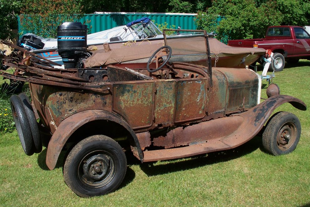

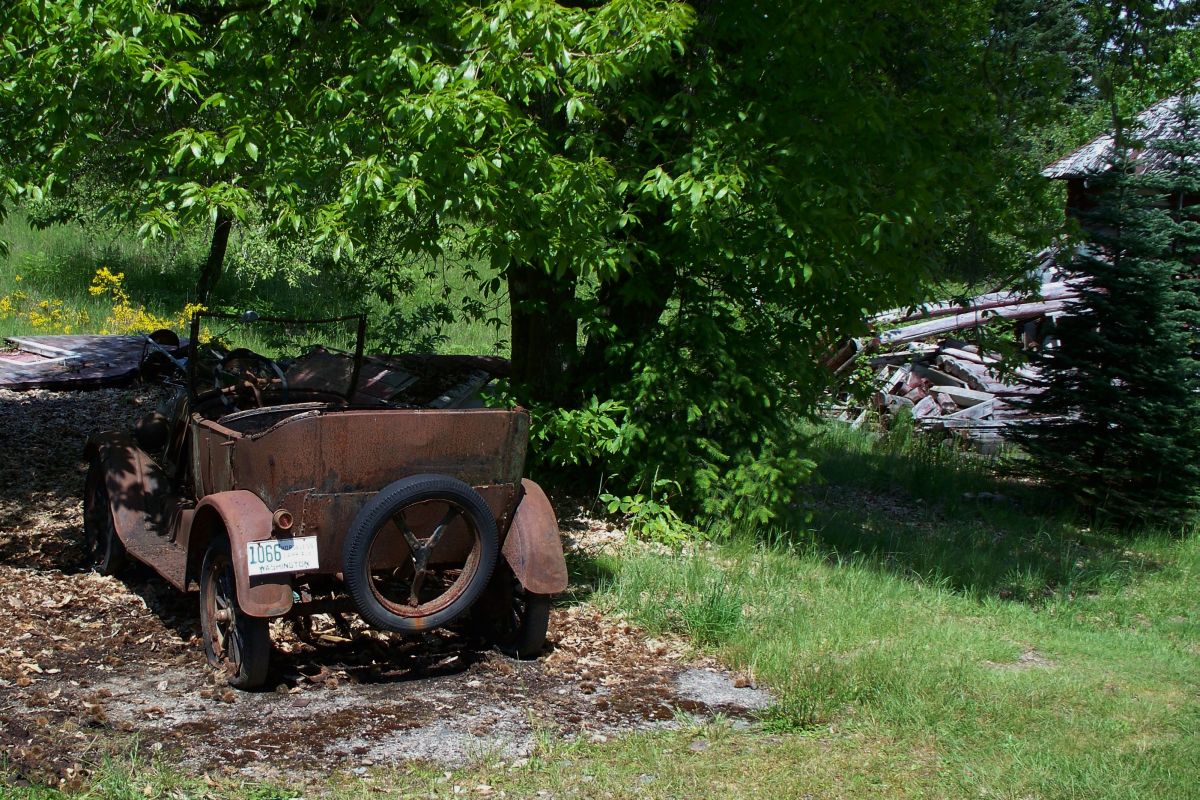

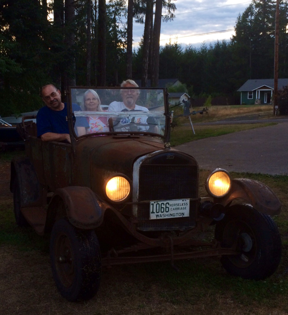

Badger Bob asked, "now that year it the ford T in the back ground?"
and
g3jim asked, "Whats that little buggy behind the Merc Monster Doc?"
So I'll 'drift' off topic for a second :)
It is a 1926 Model T, 4 door touring model.

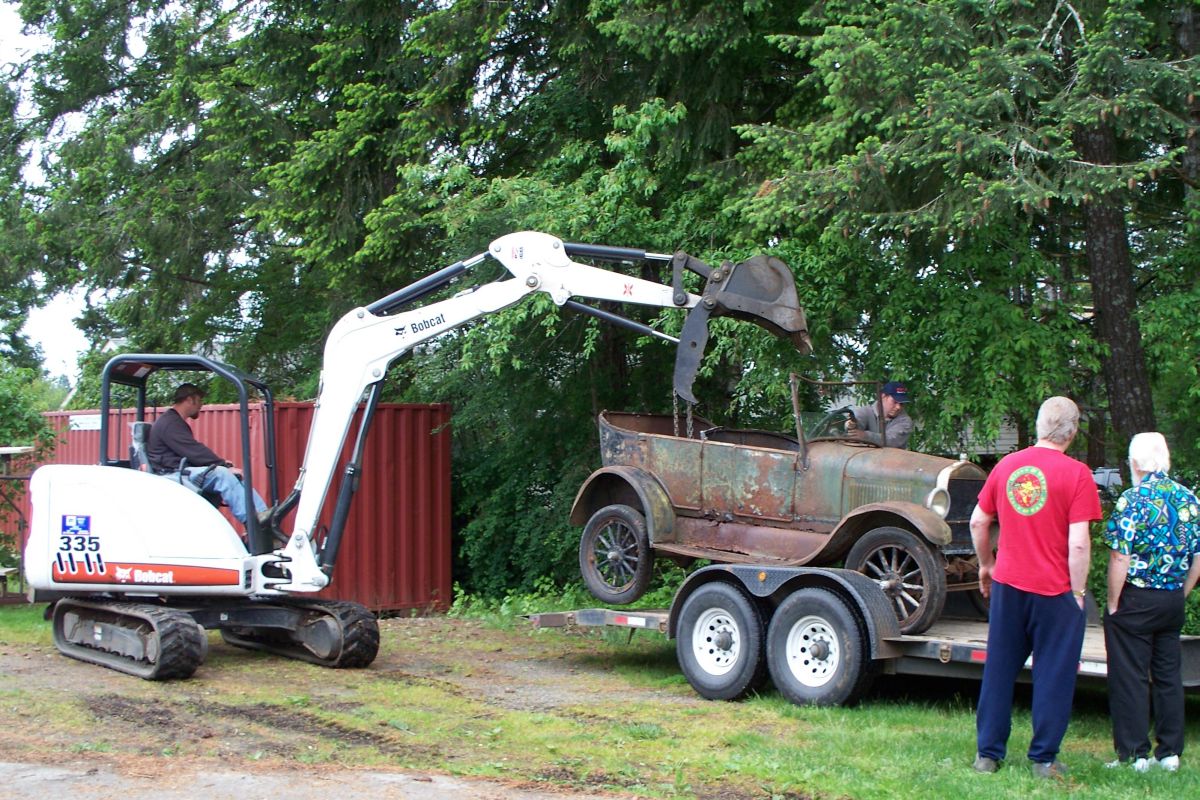

It was left out in the weather here in the Great Pacific North West on the southern edge of the Olympic Rain Forest, slowly rotting into the ground.
I had a pal lift it onto a trailer with a mini excavator to bring it home.
The transmission, engine, and brakes were rusted solid. The tires had rotted away at the contact with the ground. The steel wheel rims were also rusted severely at the ground, and the tires were flat and rotten.
The radiator was full of a rust colored thick milk shake consistency liquid. I couldn't believe that the radiator and block had not cracked open during the freezing winters.
I spend a couple years tinkering with it between Mercury Magic projects, and eventually got it running.

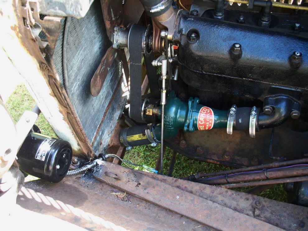

Original radiator, motor, transmission & rear end were used.
It had an original electric starter, which I went through.
I added a tractor distributor I snagged off of ebay, and the coil and spark plug wires are OEM Kiekhaefer Mercury Outboard parts.
I also added a 6 volt alternator to replace the very dead 6 volt generator.
I also added an 'oo-gah' horn.
Replacement wooden spoke wheels,tires and rims were way too expensive for my pocket book, so I converted the original Model T hubs to use 4 lug Ford Escort - Mustang wheels and tires.
I found the rustiest old Ford rims I could find, so they would 'match' the 'surface rust' character of the ole survivor.
We drive it to town to car shows and for lunch during the summer months.
See how much of the starboard side metal under the doors has fallen off since it arrived. (compare pictures 2 & 3)
I try to make room for it inside during the foul winter months, and start her up every month or so. I run 91 non-Ethanol gas.
We call it "Patina Royale".
doc
ps: note the mention of Mercury O/B parts to keep this post on topic.
Re:1350 Hot Rod Project 10 years 9 months ago #118906
  • g3jim
  • g3jim's Avatar
  • Posts: 1009
  • Karma: -27
that is 1000% awesome!!!!
Re:1350 Hot Rod Project 10 years 9 months ago #118912
Iam very glad to see one more saved from the junk yard . very nice. bob
Re:1350 Hot Rod Project 10 years 9 months ago #118916
  • frog
  • frog's Avatar
  • Posts: 1431
  • Karma: 59
  • Thank you received: 3
doc, your ford is just plain cool. nice job. frog
Re:1350 Hot Rod Project 10 years 9 months ago #118925

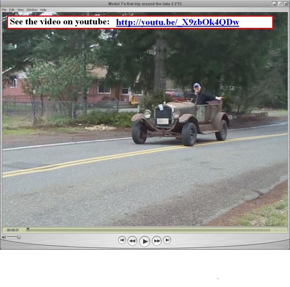

THANKS everybody!
We get a lot of 'thumbs up' and big ole smiles when we're "touring in the T"
Just when everything is in a rush,...Hurry here,...Hurry there,...I like to take a step back and cruise the T.
The fastest I've ever gone (and only for about 100 yards) was 22 MPH.
(some of my old cop pals have radar guns - lidar these days)
15 MPH is purrrrr-fect!
doc
