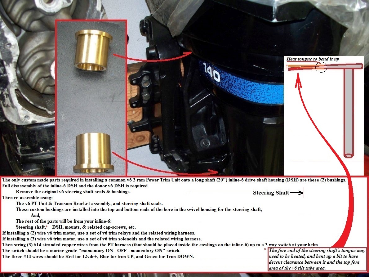

If you have a long shaft (20") inline-6 Merc from the late'60s through '88, and want to have the best power trim (PT) for a reasonable price, find a dead v6 Merc that has a 3 ram PT unit that has the entire system inside the swivel housing aft of the transom, not the ones that has a trim pump in the hull, and follow the instructions in the attached picture.

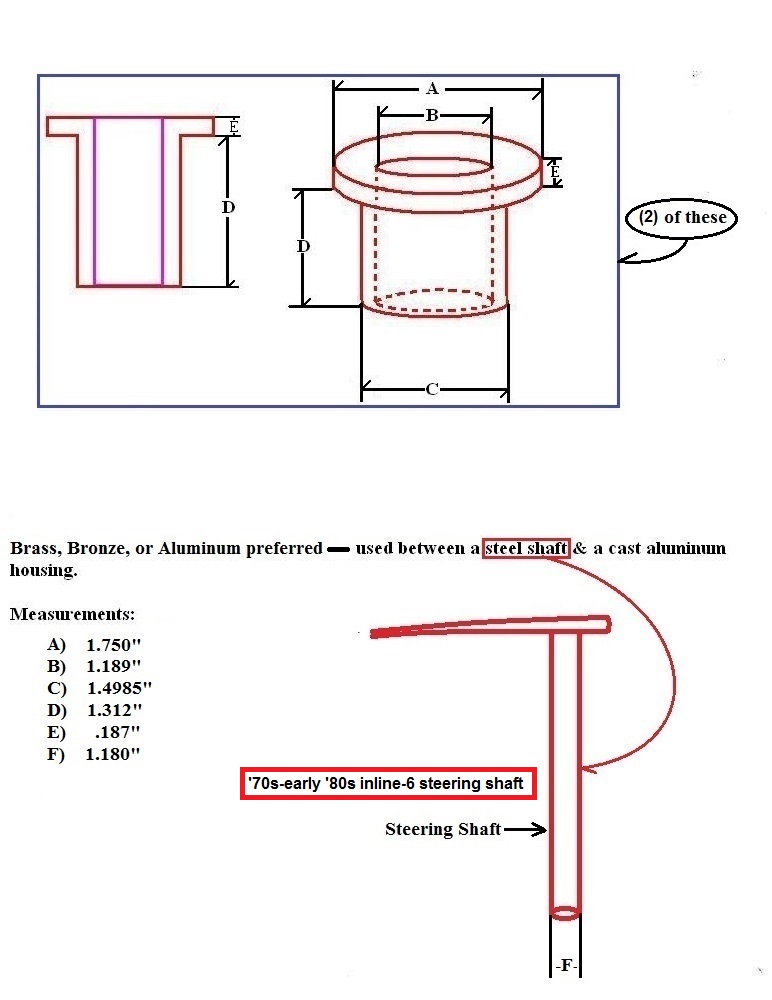

I have found bushings on line that are 'close' but too much clearance between the steering rod & the cast aluminum housing, so I have mine made locally.
I think I pay about $80 per set, but I'm not positive.
I have attached a picture of 'my' bushings that you are welcome to use.
