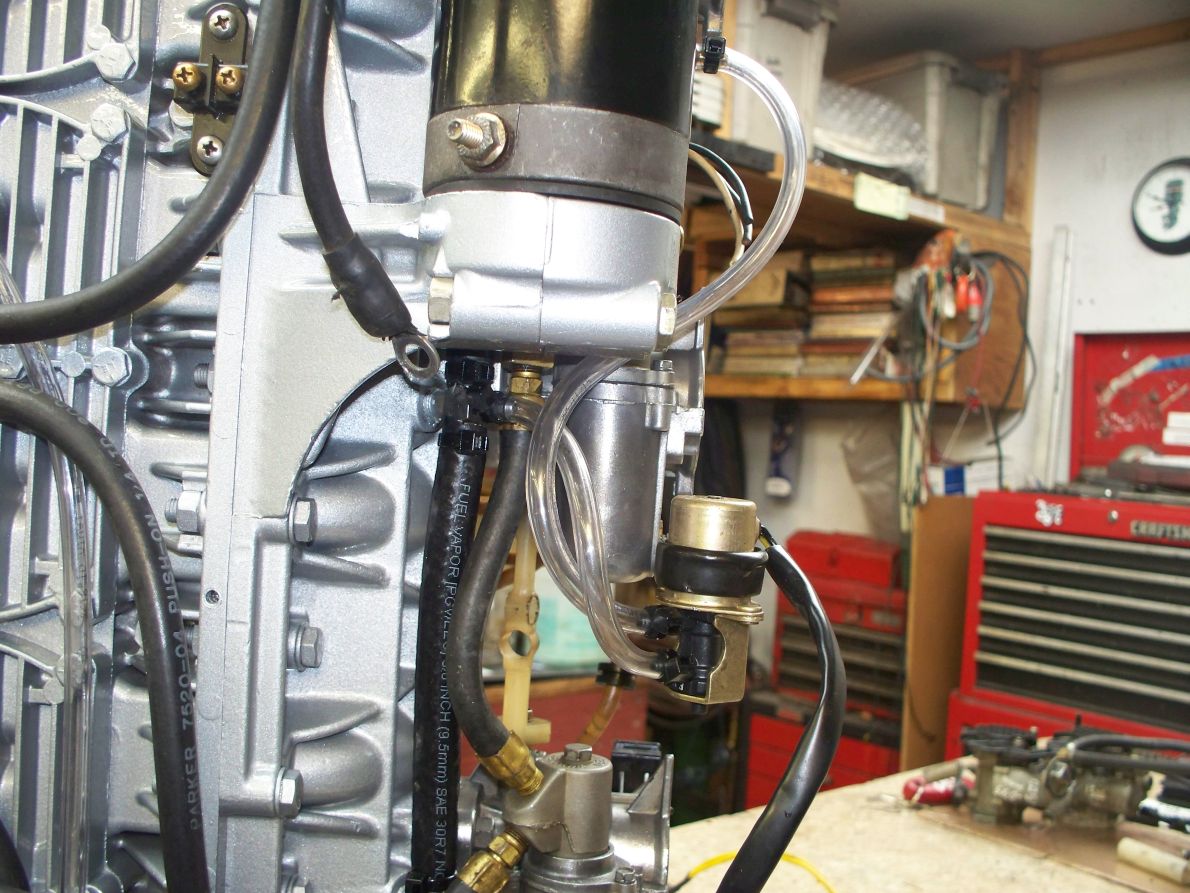

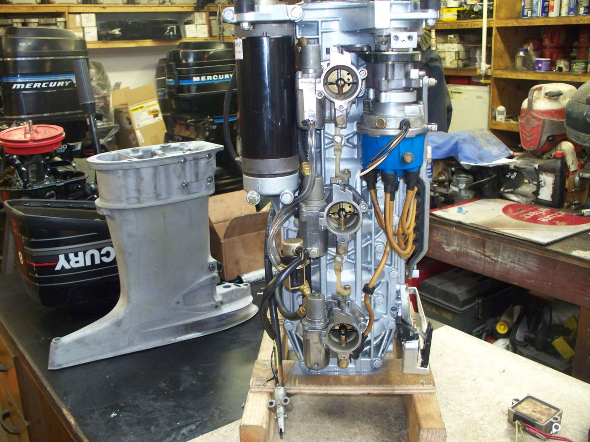

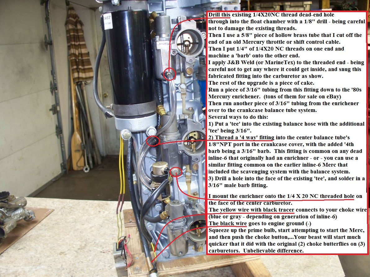

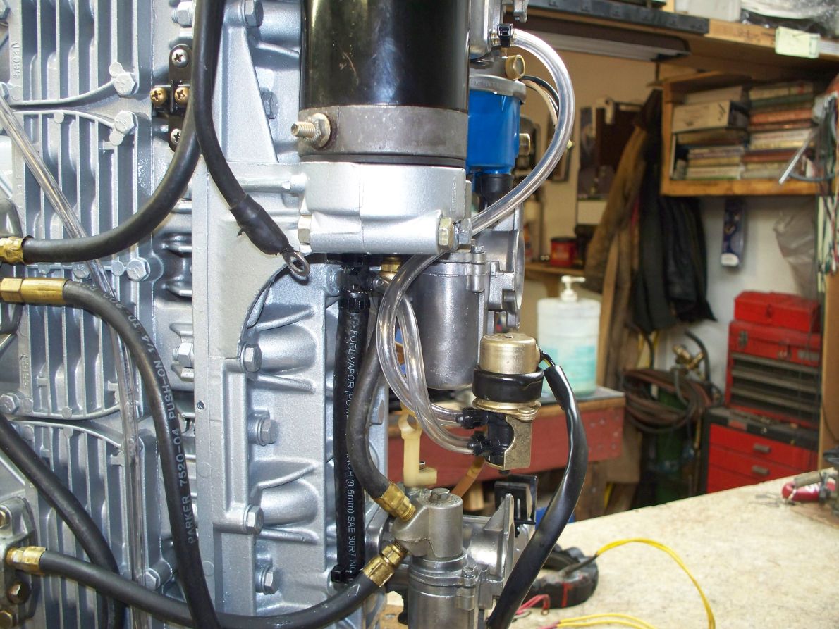

The '70s inline-6 Merc came with only (2) choke butterflies for (3) carburetors.
Consequently,...As they get 'looser' inside, they can become tough to get started when cold.
The solution is to convert to an enrichner system, like Merc did in the '80s.
See the attached pictures on how to do this upgrade.
Sorry about my miss-spelling of enrichner in the pixs.
:P
doc F
