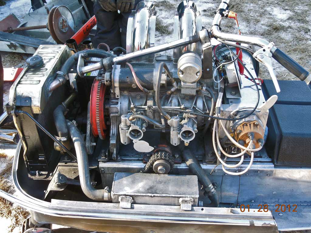

Back in the 60's the Mercury Midnight oil racing snowmobile used a tower laid on its side. The intakes were modified so the carbs could be turned 90 degrees.
I found some pics, but somewhere along the line someone swapped the 6 banger for a 4. but it still gives you an idea
That is so very cool!!!! Anymore shots of it? Would love to see a 6 done in one. Please if you have anymore post'm!

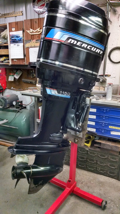

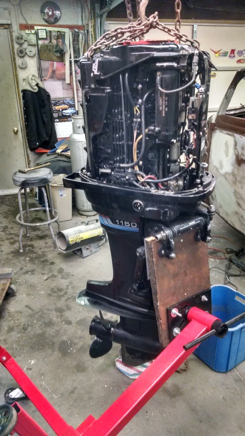

Re:Maybe a very dumb question 10 years 9 months ago #118887
  • cosmic12
  • cosmic12's Avatar Topic Author
  • Posts: 484
  • Karma: 3
Got this home and it is nice, or so I think? Now if I use it as is I need a trim/tilt unit for it.
Still not sure on the jet thing. The carbs are NP and cooling isn't a big deal bit the jet unit all times 2. OB is cheaper for sure.
