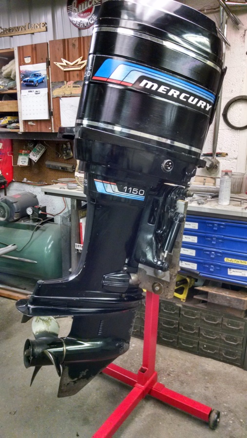

So,.. after a lot of looking I ended up getting a 1977 115. I bought the whole boat and stripped out the steering/controls/wiring w/a new deep cycle battery and the fuel system was all new this summer with all rubber parts upgraded for the E-gas including carbs. As a bonus it came with a very nice tandem axle trailer.
Got a stand made and the engine is ready for a spring fit.

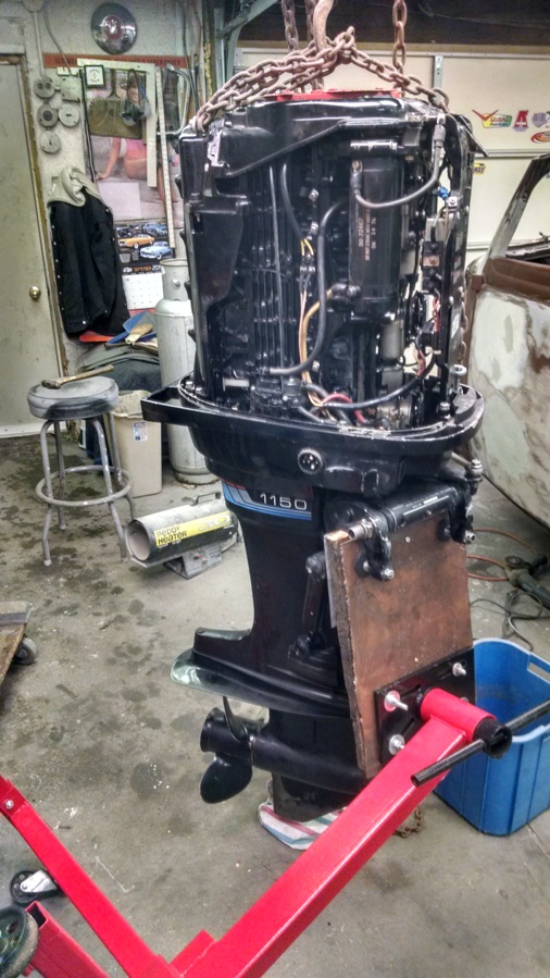

Re:Merc Questions????? 10 years 9 months ago #118822
nice motor but don't lift it by that method it will breake the rubber insolater mounts. get a lifting ring for theflywheel.
Re:Merc Questions????? 10 years 9 months ago #118828
  • ed-mc
  • Posts: 1482
  • Karma: 235
  • Thank you received: 131
dave bernard wrote:
get a lifting ring for the flywheel
Agree!
This is a good combo flywheel puller/lifting eye for a reasonable price on eBay:

Thanks for the link, I have bought one so I have it when I fit it to the boat.
I didn't have much choice at the time and was not happy about doing it. Please tell me what I need to look for now that I have "F"ed up.
