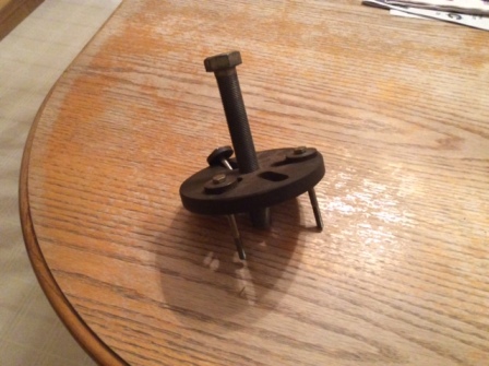

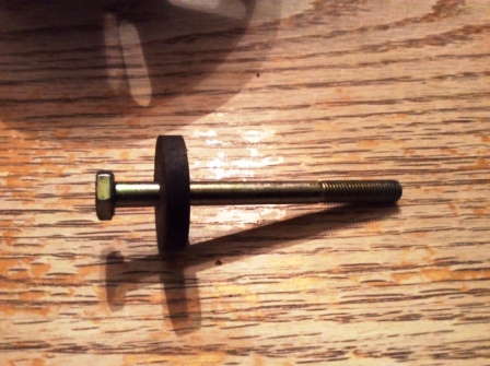

Re:Cant get mark 55 flywheel to pop off 10 years 10 months ago #118553
I hear ya there Jeff ! Some flywheels are just temper mental :lol: . What type of puller do you have? I have a smaller one then also be his larger one in the pic. Larger one ha a major bolt and also oversized washers help a lot. I will video next one I take off. Couple was ago I started tearing apart my next projects 2 1964 merc 650's. 1st FW came off easy then the 2nd took little longer but had to use the pb blaster and really torque on the bolt with a minor sledge tap!
