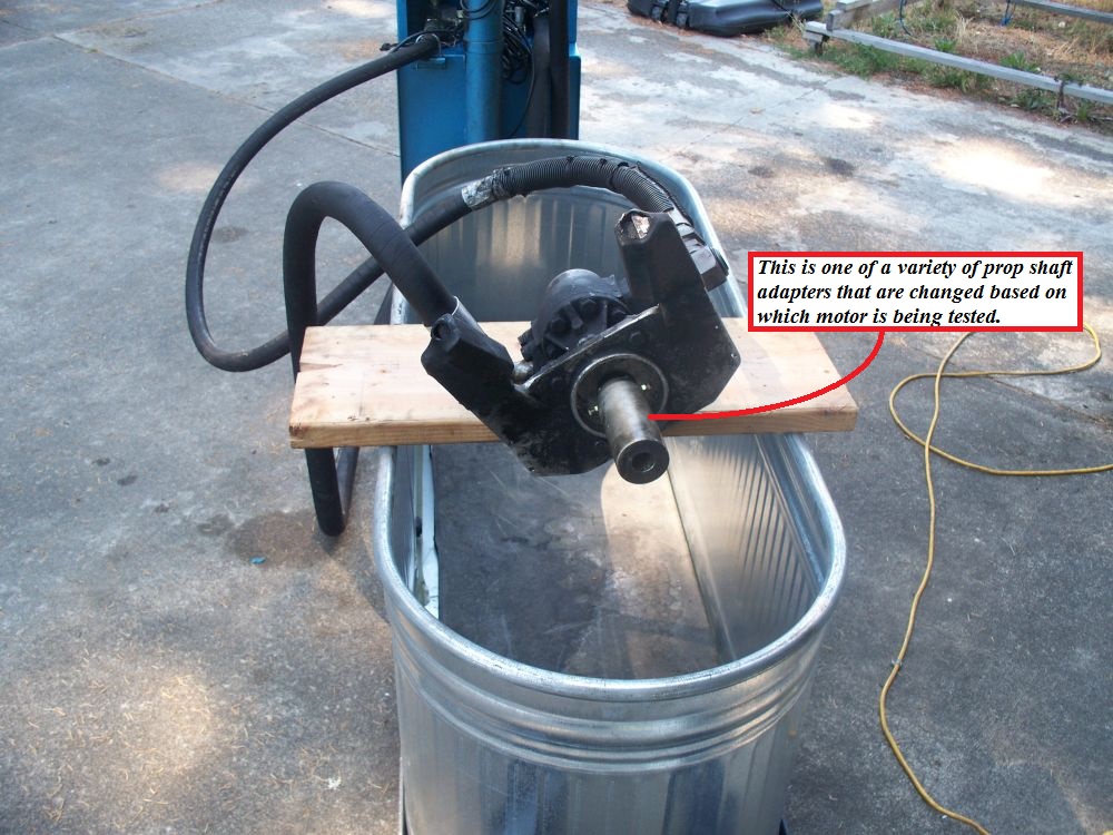

Anyway, WTF is that in the second pic? Is it what I think it is?

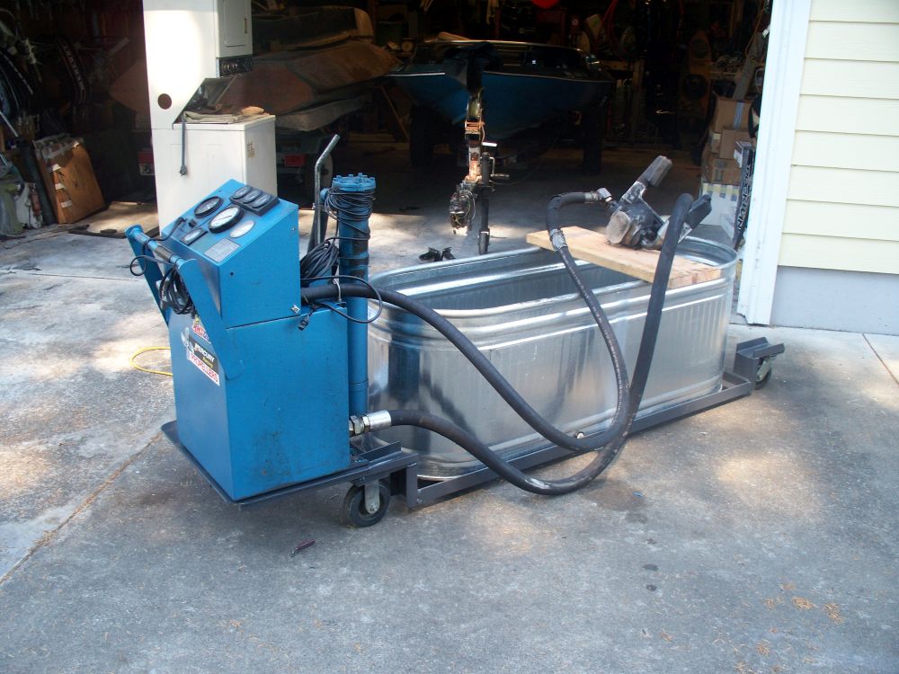

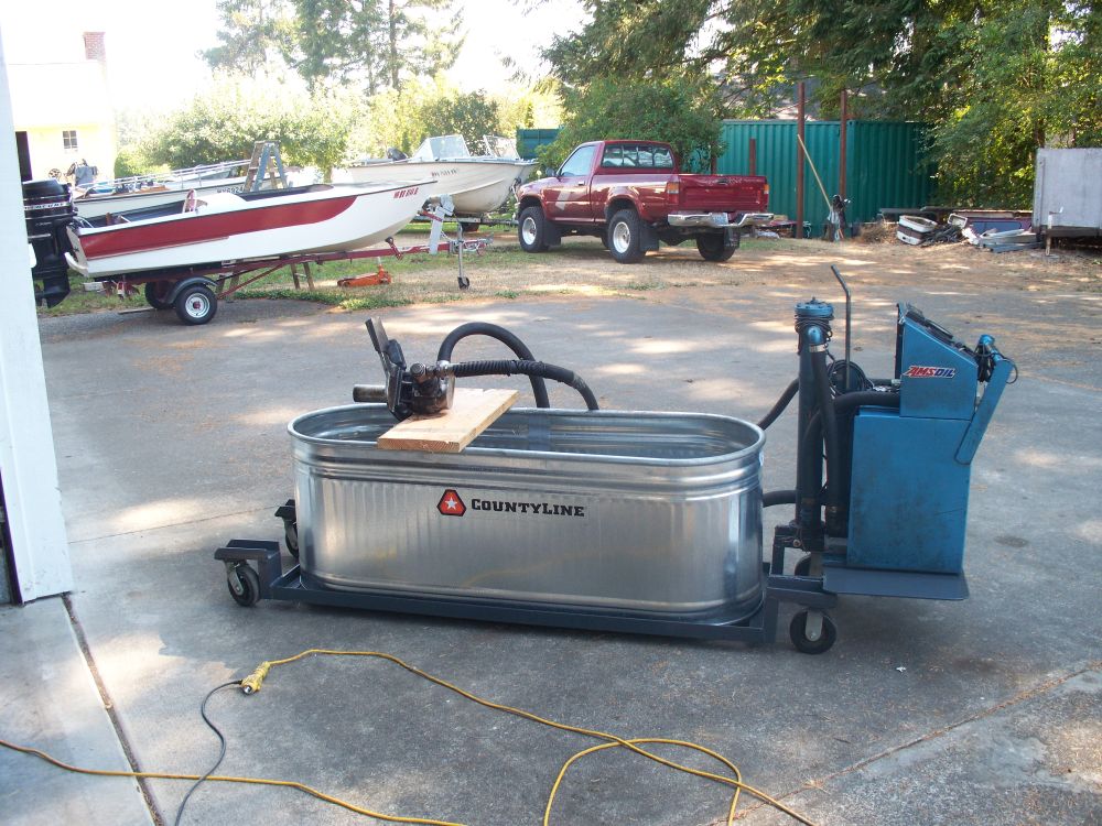

"Anyway, WTF is that in the second pic?"
The blue devise is a Dynometer, used to create load on outboard engines for testing purposes. The water tub aids in keeping the hydraulic motor's oil cool.
The max horsepower for this unit is about 200.
It eliminates the need to drop the boat in the water to complete testing in most cases.
Pretty cool.

Just what I thought! NICE FIND! What gave it away me was the "padded ears" that would hold it to the the fins L/U. And also ya sure can make a damn bunch bucks "Dyno an OB". Friend mine back east was a Harley engine builder. He bought long ago a M/C Dyno. Stopped building (kinda) and just traveled all biker events with the Dyno in a enclosed trailer. Lotta bucks made simple "having fun" with anothers bike! Ya got a damn nice prize there my friend!

Oh the dyne is awesome!!!! Land and Sea had developed one back in the 80's is it one of theirs?

I'm not sure of the origin of the Dynometer.
This is the second one I've had, and really kicked myself for selling the first one. I didn't think I would ever be lucky enough to find another, but I did. This one was recently rebuilt too.
I'll track down the manuals, and share what I find in respects to the manufacturer & related franchises. I had the manuals in my 'hot little hands' a couple days ago, while hunting for something else, so I 'should' be able to locate them again.
