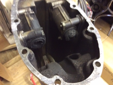

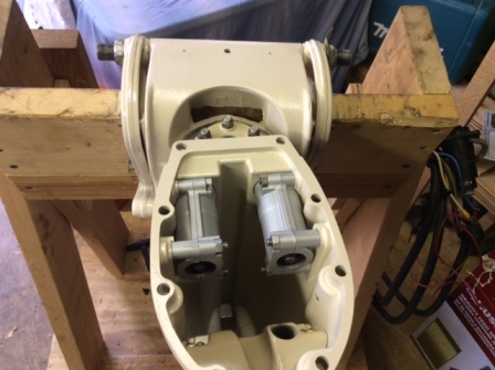

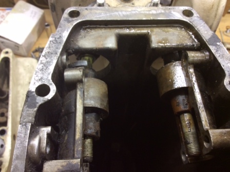

Travis, when you were rebuilding your Mark 55 did you replace the internal hardware on the upper mounts inside the leg? When I pulled mine apart the internal hardware is all rusted and rotted. I'm trying to find new stuff but none of the suppliers seem to have it. Do I need to improvise?
Re:compression and cranking amps 10 years 10 months ago #118223
Mine were all good luckily. Do you have any pics of what your current setup? They were a pain in the butt to remove. I'll look up the part number on those so called rubber seals but they don't sell them any more. How I was taught on re assembly is to fill area with silicon well and it does the job. I've seen it done but it might take the craftsman in you find some rubber and make em'. Here are a few pics at disassembly. Bottom pick is reassembly this is where I fill opening completely
with silicon. Hope this helps

Yea, Your not kidding about being a PITA to remove. I was able to find new caps and the rubber rings for the other end. For the hardware I'll just take it all over to fastenall and match stuff up. For the spacer I should be able to drill out a big washer and tack weld a piece of tubing on it.
Where there's a will there's a way. Furgeson Poole has the rubber parts.
