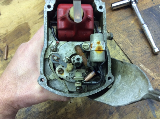

Hugh,
Not sure if this helps but here is a Kiekhaefer mag dis assembled.
I'm not able to get a larger pic so you can see numbers on bearings this is a mag for a Mark 55e. I was unable to see a few numbers on the bearings but here is what I have
top bearing Drive End FAFNIR 9103PPC1
Middle Opposite Drive ?6002XEZ
Bottom Magneto Pilot FAFNIR S5KDD
Travis
www.liquidassetsonline.org , 63\'PowerCat14-C w/twin64\'650\'s,14\'Glen-L Zip w/Mark58E,58\'TeeNee,
Mark55AE,Mark55E,PairMark58E\\\'s,Mark58AE,Mark78AEL, 6-7RBM\'s.Keep EM\' Alive! Always looking to add to collection.

O K, I will give it a go tomorrow. Thanks for the tip Dave, and the photo pondrocket.
Hugh
