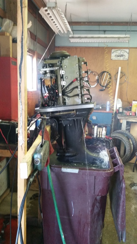

Its been a few months since i have been on here. I struggled with the MARK 75 all summer trying to make it run right, and decided i needed to take a break from working on it. Now that ive got my furnace hooked up in my workshop, i want to mess around with it some more. I am determined to figure this thing out!
Here are the symptoms the motor displayed much of the year:
Randomly the motor would miss-fire and run erratically. When this happened it would not die, although power was lost as it felt like it had stopped running one or two cylinders. also, when this happened starting in forward took longer, and starting in reverse was very hard if not impossible. Sometimes i could run for upwards of an hour before the problem would present itself, and sometimes it would only take minutes. I could not really isolate which cylinder / cylinders were dropping.
Here is what i did to try and remedy the problem:
-Rebuilt the powerhead. Compression at 160 across the board (new rings, seals, gaskets, and bearings)
-Rebuilt all three carbs (new floats & needles/seats)
-Rebuilt fuel pumps (new check valves, gaskets & diaphragms)
- new fuel lines (not factory crimp style, but used barb fittings and clamps)
- new impeller (pumps water well. doesnt seem to overheat)
- New spark plugs (probably 3 sets over the summer with no change)
- new ignition coils (both are new)
- Set point dwell with factory degree wheel (re-checked several times)
I was wondering if you guys had any ideas where i should start? Im in no hurry so i can take my time with the diagnosis. About the only thing i did not mess with is the wiring itself. I did notice some corroded wires that did not look 100%, so i tapped them up, but im wondering if i have an electrical short somewhere?
Any thoughts are appreciated.
Scott

Attached is a link to a video I took late summer of ot running in the barn. Just for fun :laugh:
www.google.com/url?sa=t&source=web&rct=j&url=https://www.youtube.com/watch%3Fv%3DqcDK9aFsZ8Y&ved=0ahUKEwiZ1sb0pd_JAhVnzIMKHbqRAJ8QtwIIRzAK&usg=AFQjCNHnzOTIhB_nyI48hsPTwsmUZKkxzQ&sig2=jIf7sjn4dpwHgUNtEc7Duw
