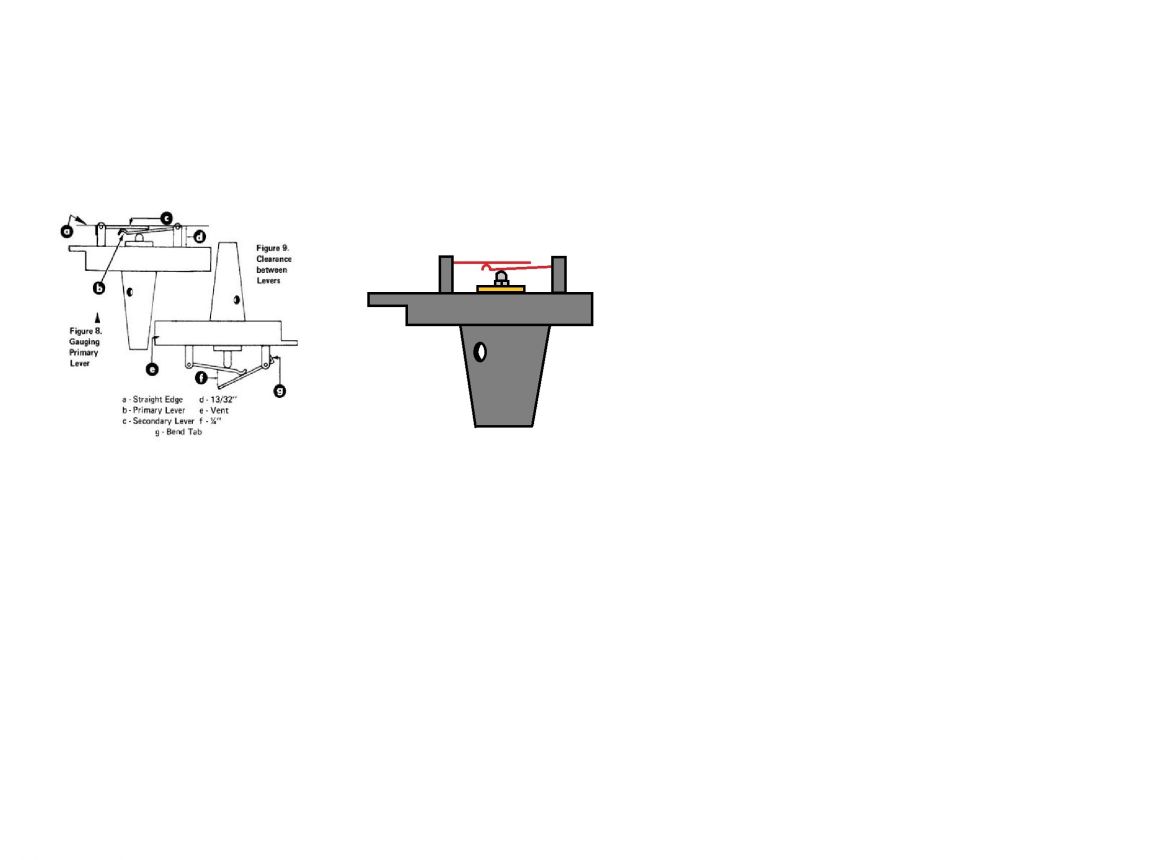

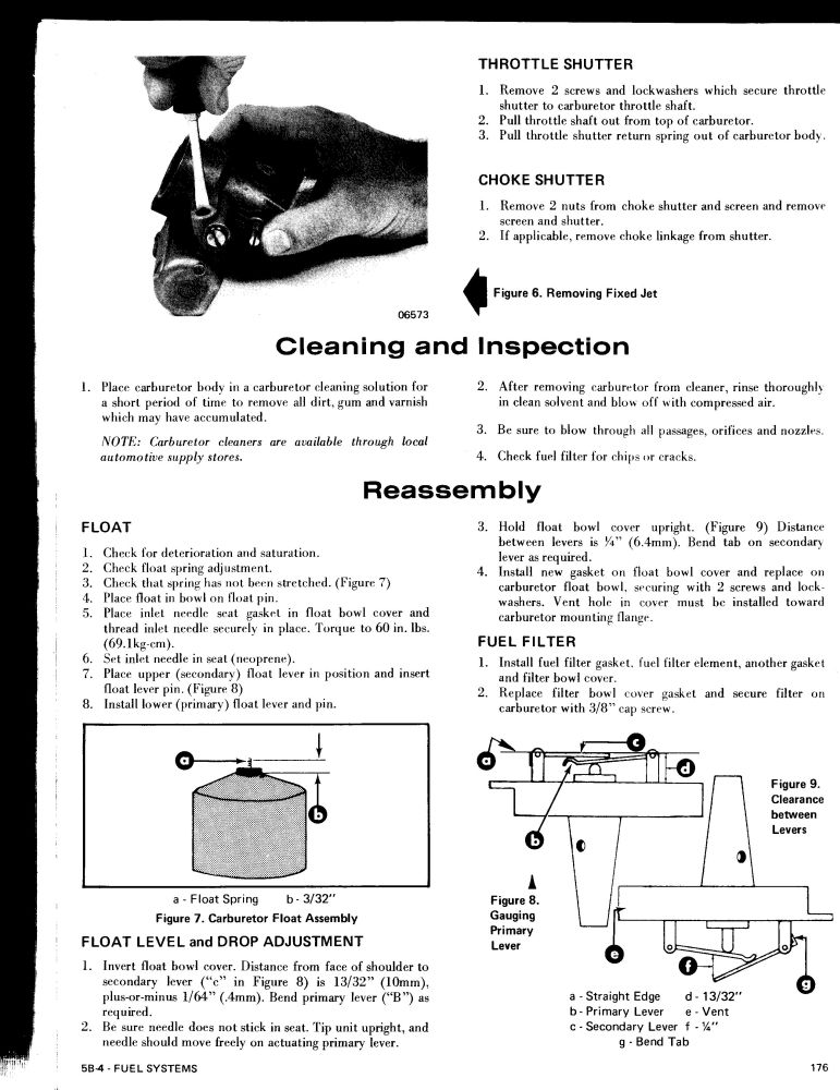

The carburaters of my 1974 1500 J block are re-built with a quicksilver repair set. As I do not have a manual { only the prior to 1965 } I like to know if someone can advise on the float height/ level settings?

Here ya go Taco :)
Personally,...I set to the second image that shows the links not touching each other. I have better luck doing it this way in a effort to stop fuel pressure causing flooding out the float chamber vent while pumping up the prime bulb.
doc F

Hi Doc,
Thank you very much. The mechanic says your info was very helpfull.
