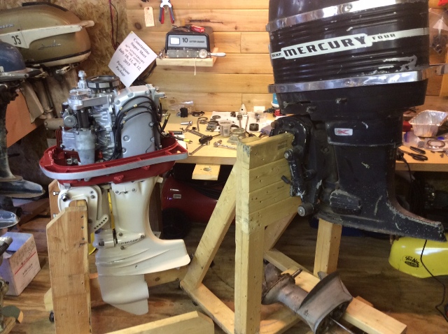

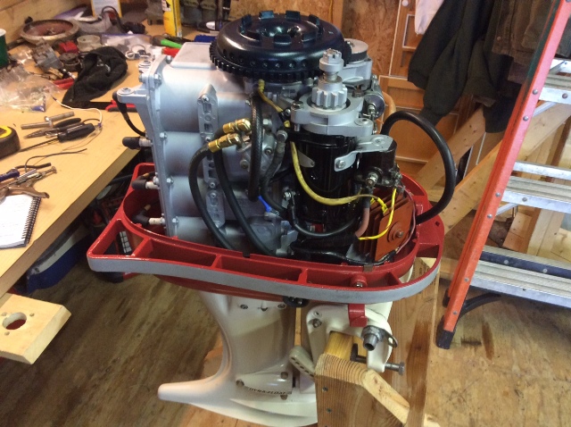

This is one I've been working on a 100% restoration. Need to rebuild the
Lower unit over the winter then ready to go.
Travis

The Merc addiction is setting in bad now. Just picked this up today...
I'm a sick man :S

great motors mark58

Perfect !! :ohmy: My all time favorite you will enjoy.
