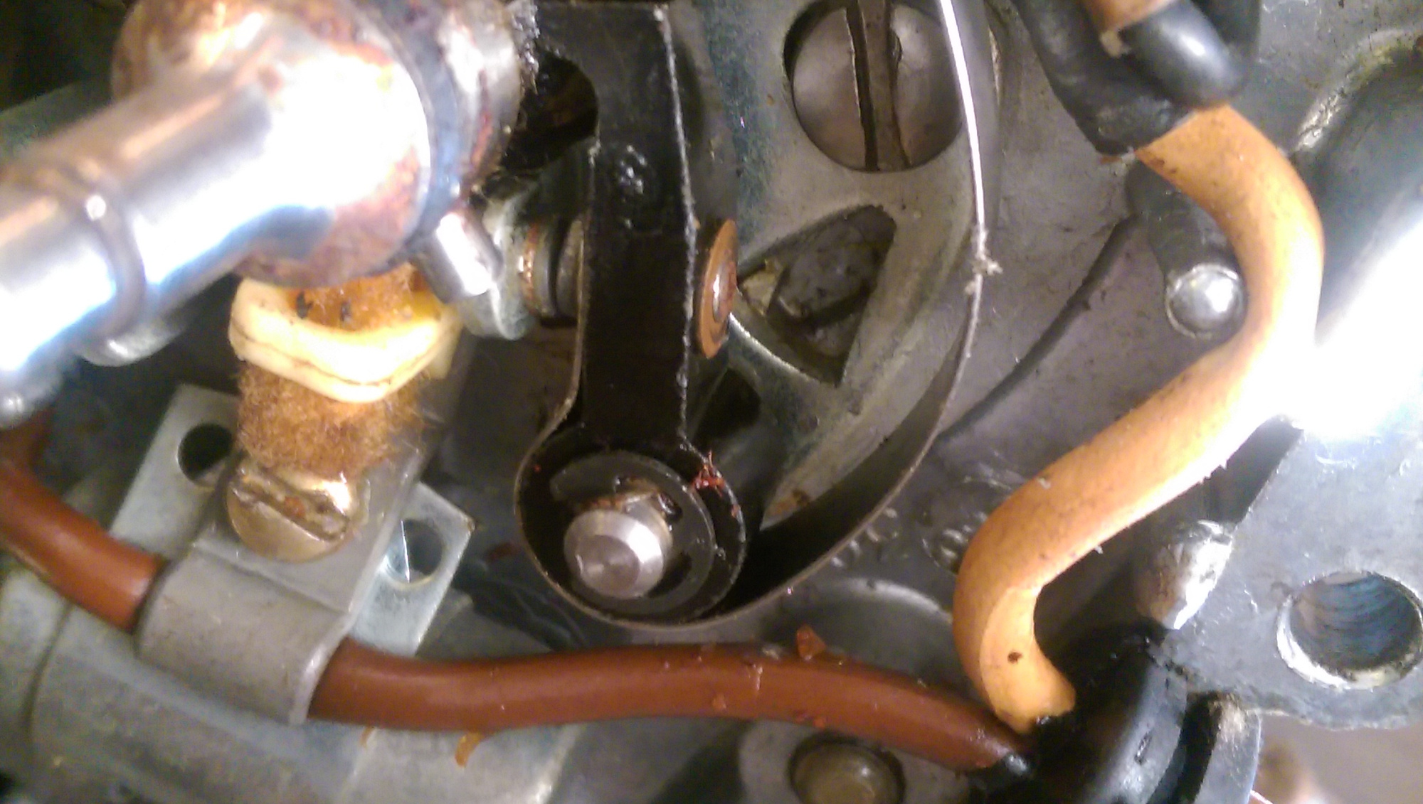

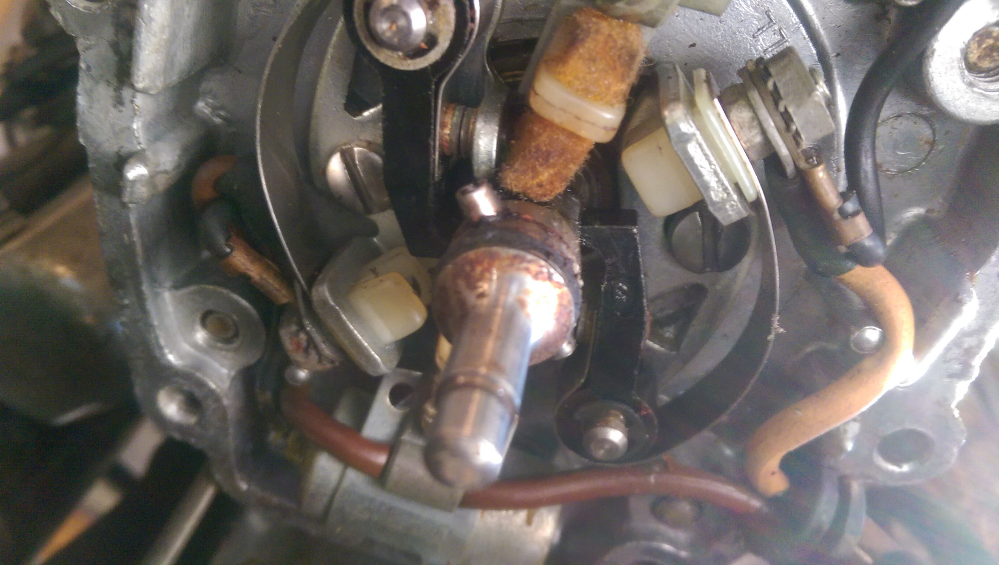

Thanks Guys, Here are some pics of the needle and seat. The end of the seat looks like it is a rubbery gasket so this may have been replaced?
After work I'll look at adjusting the needle according to the book. The instructions you provided, Dr F, are more detailed than in my seloc manual.
Thanks again.

Re:Merc 1000 on 'Cat 10 years 8 months ago #119756
I don't believe you can simply purchase the rubber washer any more, without purchasing the needle & seat kit.
In a pinch,...I have turned the rubber washer over, but I can't recommend that as a permanent fix.
I recommend purchasing a new needle & seat kit from Sierra Marine.
In fact, I would be putting new needle & seat kits (and floats like Master ed-mc suggests)into all (3) carburetors.
Based on your picture, I see that you have the original fine thread brass housing, so you will want to use the Sierra Marine 18-7057 kit and the Sierra Marine floats 18-7208.
The attached pictures show the difference in threads between the 18-7057 & 18-7061.

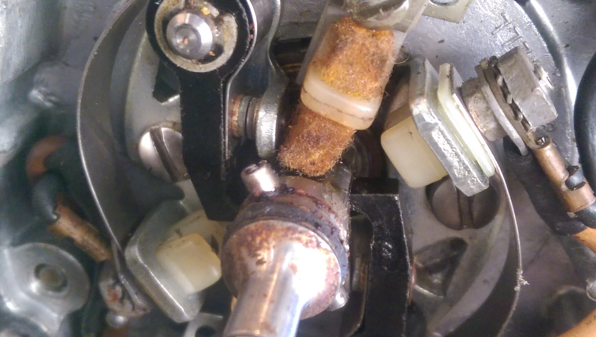

So here is a pic of the end of the seat i was trying to describe. The rubber washer i was talking about is PART of the seat. I think Tim rebuilt all the carbs on these two motors but i could be wrong. The gaskets look pretty clean.
Here is another angle of the needle and seat. They look different than the Sierra Marine part.
Oh, what's the best way to get that pin out of the cover? The one that holds the "secondary lever". I used a punch but it seemed pretty stubborn.

change the needle and seat to the newer ones rubber is on the needle. float looks good.

Talked to Tim via email. He watched the video and agrees with Dave, thinks it sounds like it's running on 3 instead of all 6.
So I hooked up my spark test light to each of the plugs and got a light when turning the motor over. Kind of expected lights on 1,3,5 or 2,4,6...
So i pulled the distributor cap to have a look at the points. Now i'm no expert, but the one in the first pic below seems wrong. The two contacts never seat flat against each other. Also, seems like half of the movable contact is white and corroded.
Should i replace both points and the ballasts? Can that be done with the distributor still in the motor, or should i remove it like the book says?
with flash
other side
whole distributor
