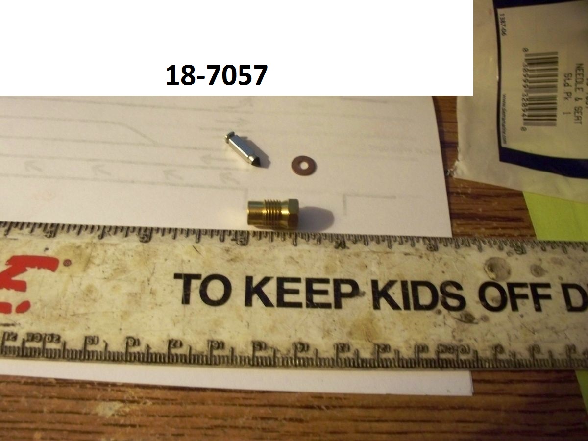

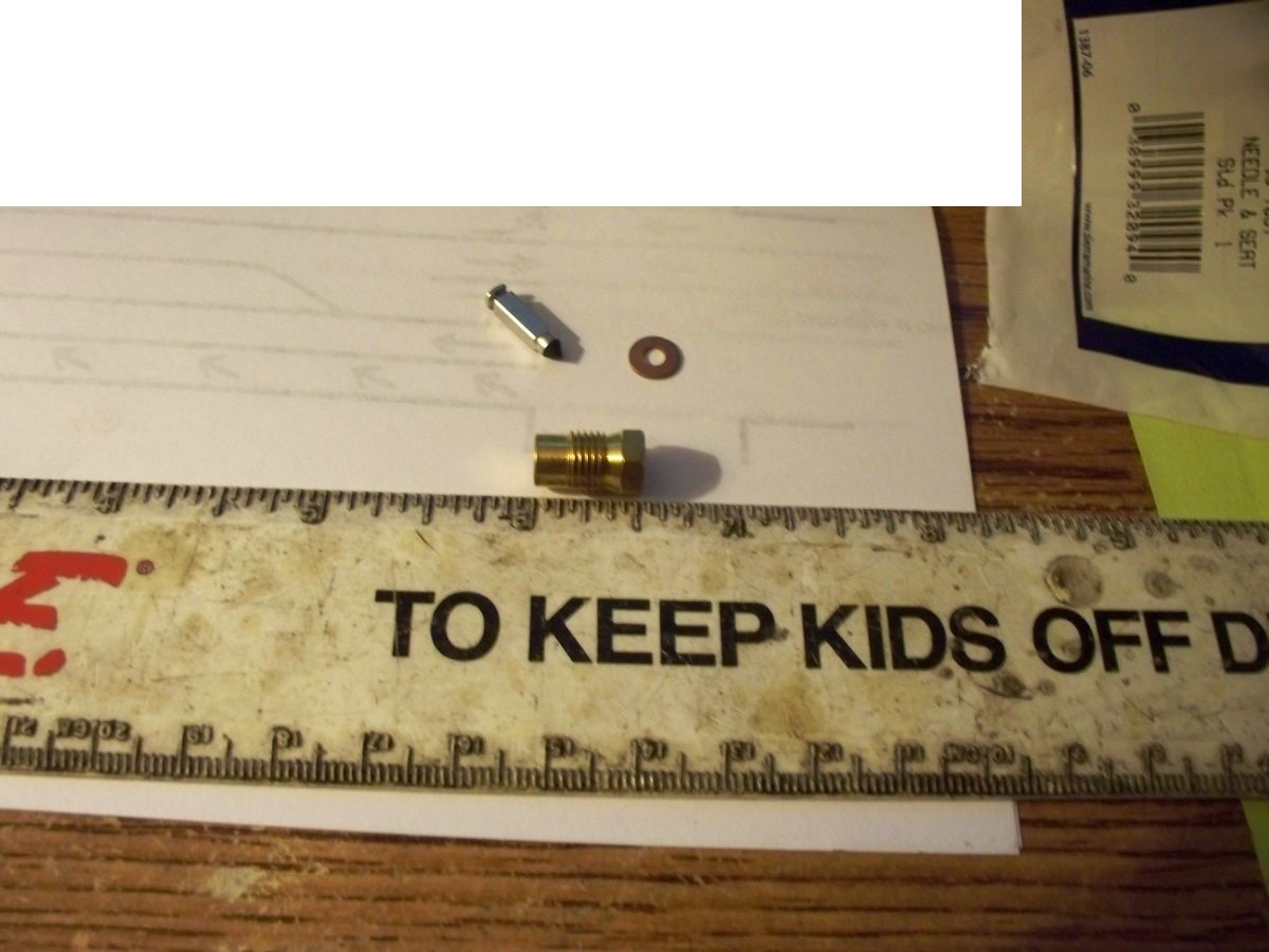

Dave is right - possibly just needs the float needle links set, but once you have the float chamber top off and before adjusting the links, turn the top upside-down and gently place your finger on the links and see if you can easily mush them down causing the needle to go deeper into the brass needle housing allowing the (2) red links to make contact. If they doe, the carburetor will flood as described.
If it does,...The needle & seat assembly are old - possibly original style that are compromised by ethanol & old age.
If so,...Replace the needle & seat with a Sierra Marine # 18-7057 or 18-7061, depending on what serial number your 1000 is, and whether or not it has the original float chamber tops.
The new needle & seat assembly does not have the neoprene washer to seal the needle - it has an ethanol resistant rubbery point on the needle that seats into a machined hole in the brass fitting.
The difference between the (2) part numbers I posted is they have a different thread for the brass housing in the cast aluminum float chamber top housing.
The 1000 Merc is right in there where Merc changed from using the earlier 7057, and went to using the 7061. I used to think that all old "Tillotson" tops used 7057 and 7061 was for the "Mercarb" tops, but I've found that not to be totally true in the 1960s.

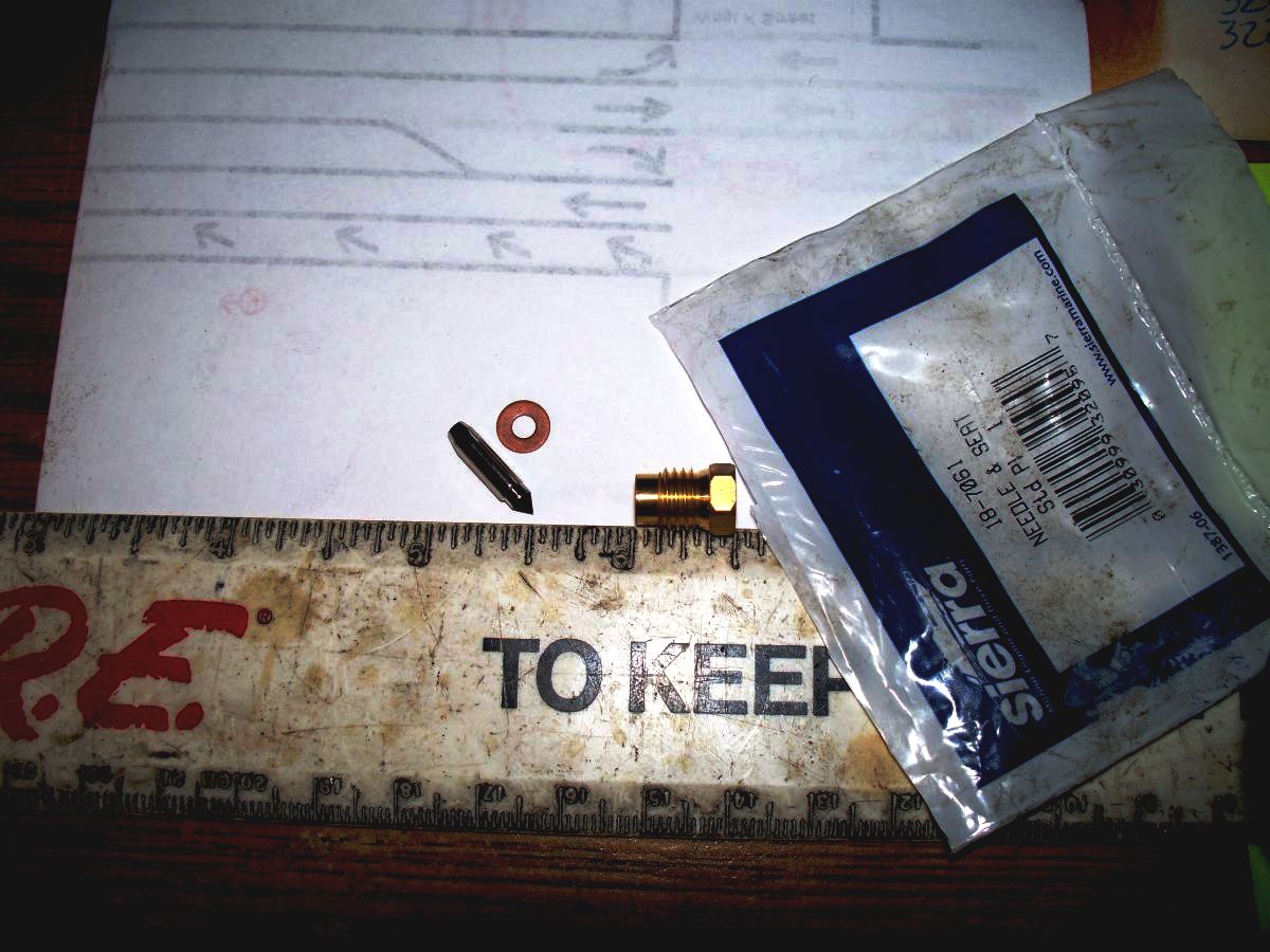

If you remove the brass housing & post a pix by a ruler I can determine which part number is correct for that carburetor top.
If the tops are the original, all the 1000, 1000ss, used the 18-7057.

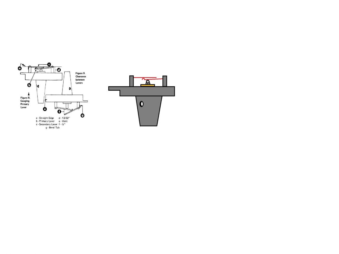

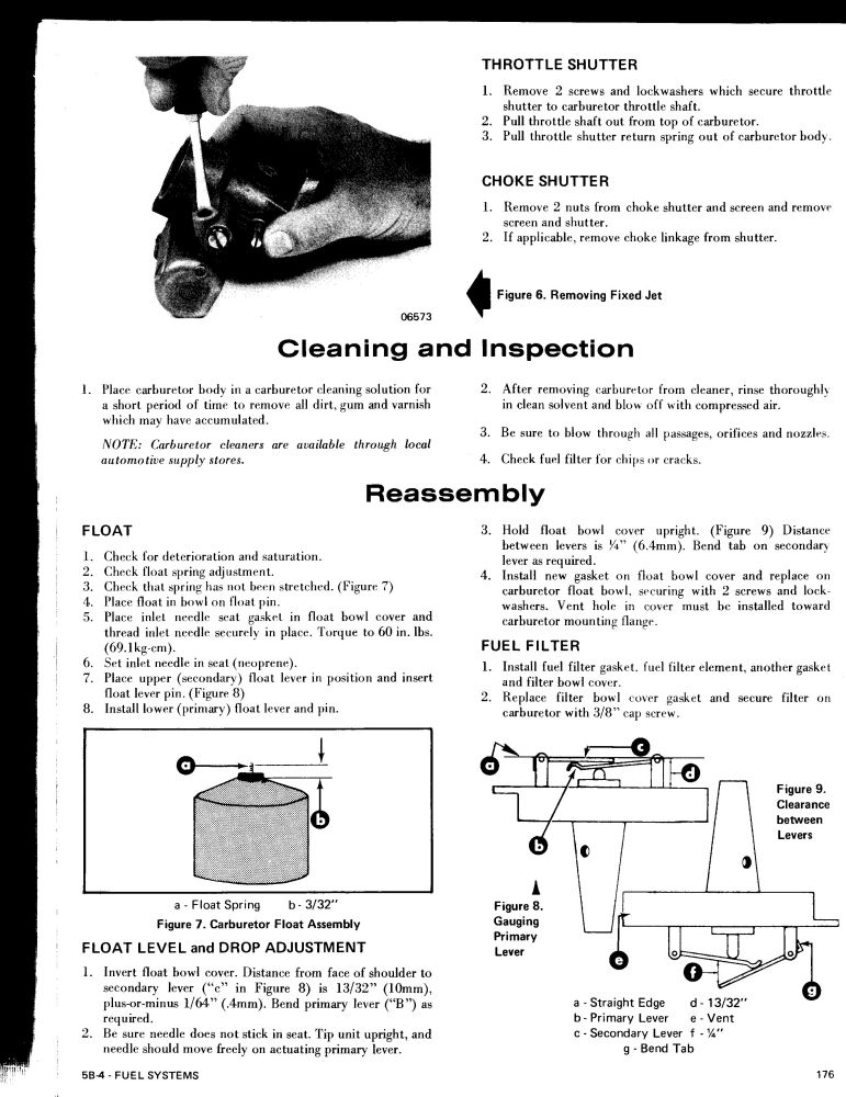

See also the attached pictures.
doc F

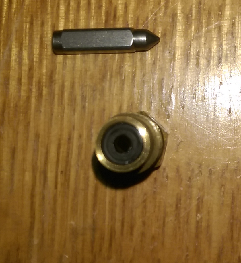

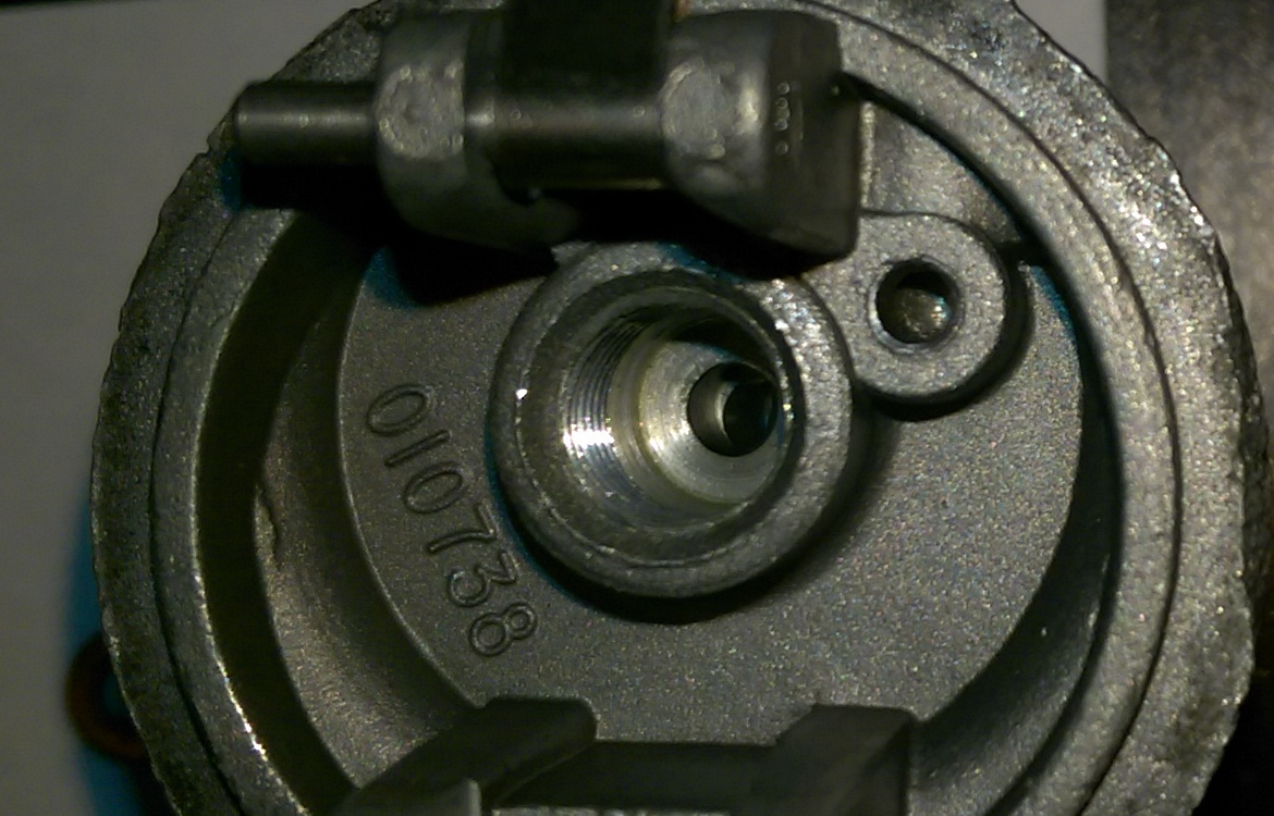

Thanks Guys, Here are some pics of the needle and seat. The end of the seat looks like it is a rubbery gasket so this may have been replaced?
After work I'll look at adjusting the needle according to the book. The instructions you provided, Dr F, are more detailed than in my seloc manual.
Thanks again.

I don't believe you can simply purchase the rubber washer any more, without purchasing the needle & seat kit.
In a pinch,...I have turned the rubber washer over, but I can't recommend that as a permanent fix.
I recommend purchasing a new needle & seat kit from Sierra Marine.
In fact, I would be putting new needle & seat kits (and floats like Master ed-mc suggests)into all (3) carburetors.
Based on your picture, I see that you have the original fine thread brass housing, so you will want to use the Sierra Marine 18-7057 kit and the Sierra Marine floats 18-7208.
The attached pictures show the difference in threads between the 18-7057 & 18-7061.
doc

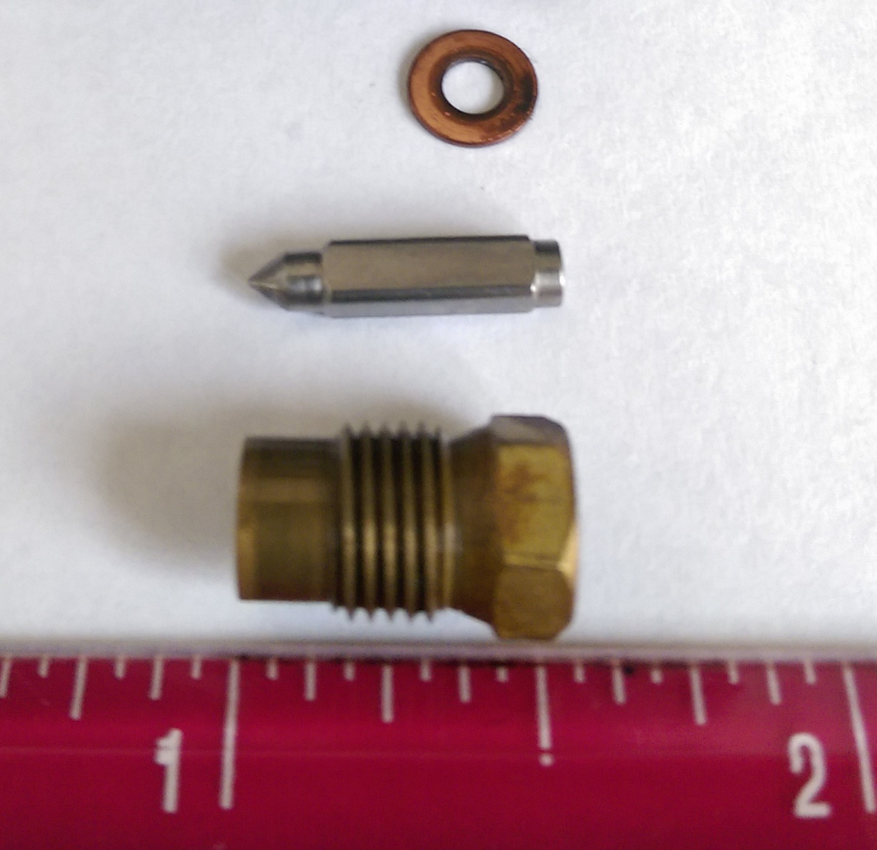

So here is a pic of the end of the seat i was trying to describe. The rubber washer i was talking about is PART of the seat. I think Tim rebuilt all the carbs on these two motors but i could be wrong. The gaskets look pretty clean.
Here is another angle of the needle and seat. They look different than the Sierra Marine part.

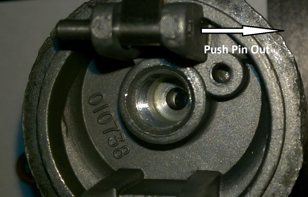

Oh, what's the best way to get that pin out of the cover? The one that holds the "secondary lever". I used a punch but it seemed pretty stubborn.

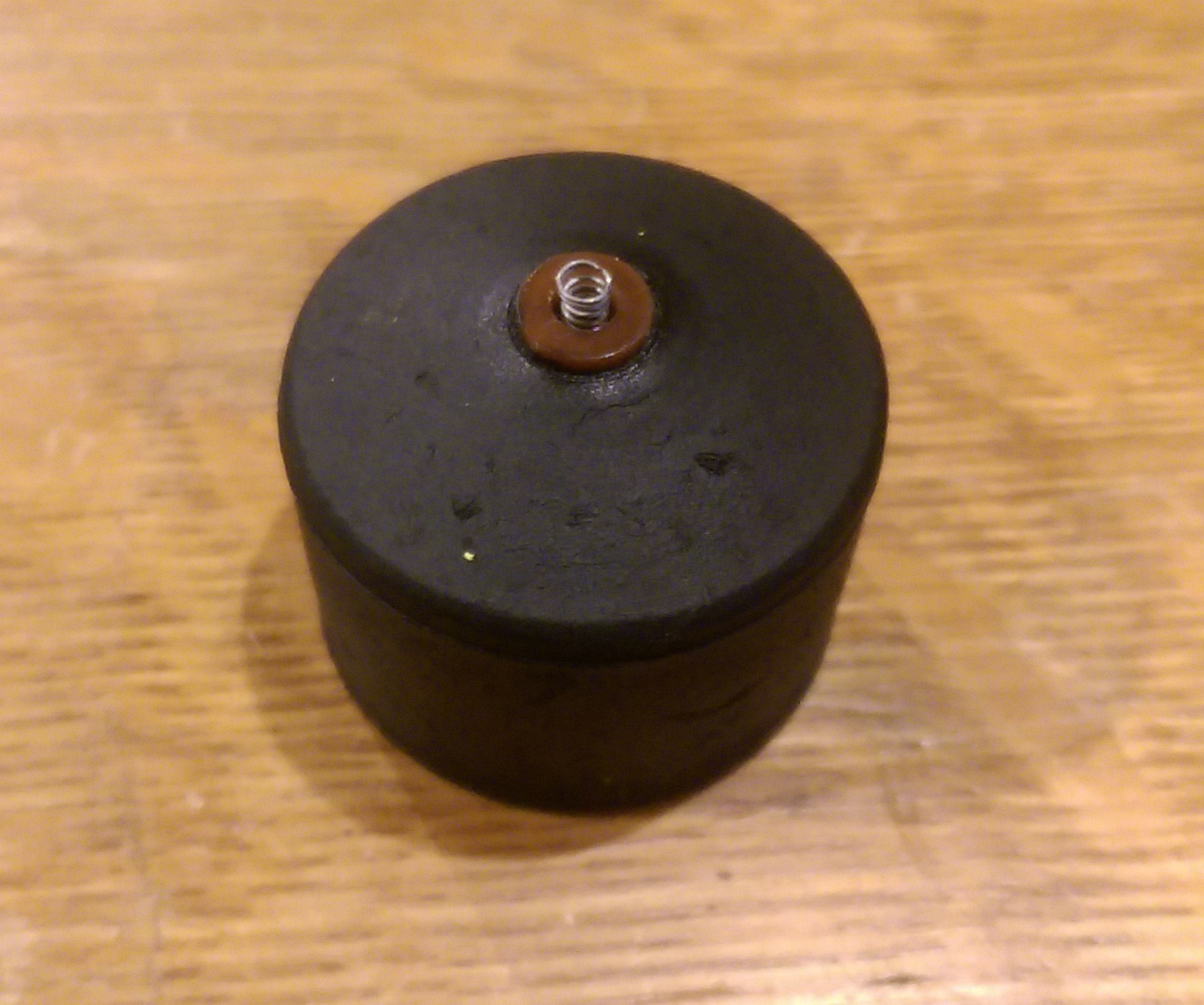

The float.Measures 3/32 from top of spring to bottom of plastic part of float body.

Re:Merc 1000 on 'Cat 10 years 8 months ago #119771
change the needle and seat to the newer ones rubber is on the needle. float looks good.
You'll note that the end of the pin which is seated in the float lever "ear" has splines on it.
These splines are what holds the pin in place.
Drive the splined-end out; the other end is just a slip-fit in the ears and as soon as the splined end clears the ear, the pin can be pushed out with your fingers.
HTH........ed

Thanks ed. I pushed the splined end in, then tried sending through the other "ear" Glad i stopped. The way you describe makes more sense.

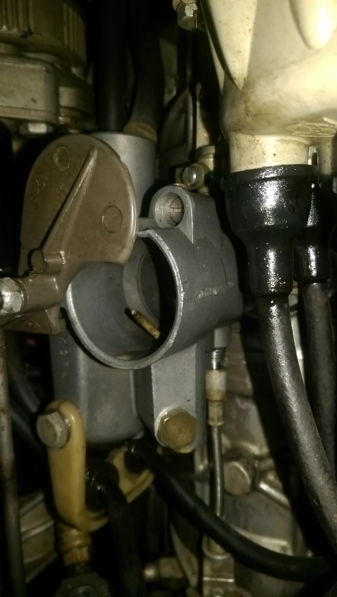

Some pics, don't know if they'll help.
Middle carb with Mercarb top:
Back of middle carb:

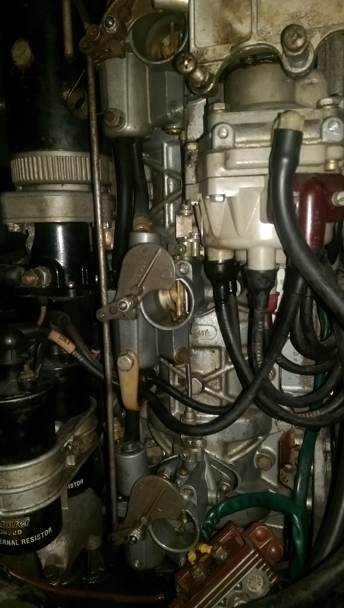

Re:Merc 1000 on 'Cat 10 years 8 months ago #119848
Looks like you have KC-7A carbs, which should be fine as they are originally for a 93 ci 1100.
The main jet size is the only critical issue, and I am confident that Tim would have installed the correct ones for the 90ci 1000.
I put .071 mains in my 1000 builds, but there were .069 mains listed as standards too.
Am I correct in assuming that the choke butterflies are partially closed in an effort to show the carburetor part number, and that they actually open up completely when left alone???
doc

Good eye, I didn't notice the butterflies. If you look at the top center of the picture of all 3 carburetors you will see the electric choke plunger that fits in the solenoid. That was tucked back to get it out of the way and was holding the butterflies closed. They do open completely when that plunger is un-tucked.

I have those screw retaining screw drivers too, but the one I have that fits into the main jet hole is all worn out. That's why I went to toothpicks.
Yes,...I am a bit of a tight-wad.

Thanks for the Heads up. I probably would only go quarter throttle if even that. Just want to see if she'll idle ok after she warms up.
Dan
68 MFG Chevron
61 Power Cat 18DC Tahitian
Re:Merc 1000 on 'Cat 10 years 8 months ago #119921
And,...If she doesn't want to idle happily,...You may have to open (counter-clockwise) as much as a 1/2 turn +/- in the cold weather.
Do this at 1/8 turn to both carburetors for each idle test, then add more C-Clkwz as needed. Note what it was at originally though as you may want to return to those settings in warmer weather.
doc
