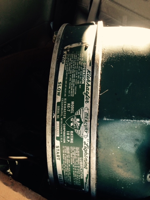

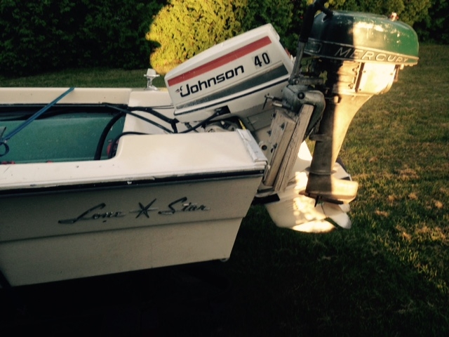

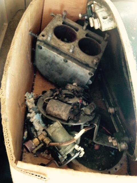

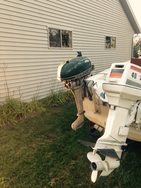

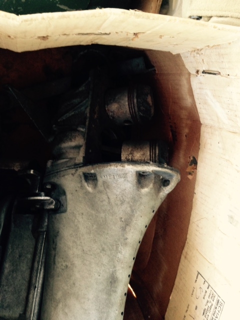

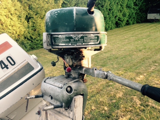

I have been working on a rebuild of Merc KE-7 Lightning that a friend gave me when he heard I was restoring my 1963 Lone Star Triton. Turns out that he used the motor on a hydroplane in college in the 60's, but then had it break down. He was taking a class to fix it in the '70's, but ran out of ambition and just boxed up the parts. It has been sitting in his garage attic for 40+ years!!
With a little parts sourcing for points and some fabrication and welding of parts, we have it firing. I just need to source a replacement impeller for the water pump, and potentially the lower cowls. I was hoping that someone could help me out on finding parts without breaking the bank.
Here are some pics of how I received it and its current - almost finished product.
