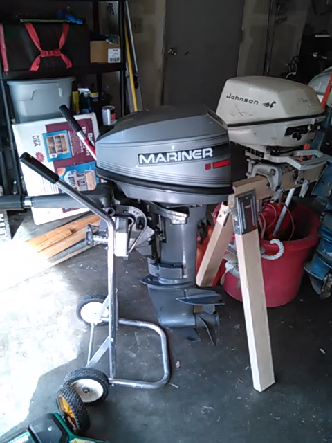

Hi guys. I was hoping to sell some kicker motors, but looks like will be keeping more than expected.
So, for winter storage, can I just run a mixture of stabil into all the engines on their last run, drain carbs as best as possible and hope theyre good to go next season? I dont want to fight varnish in the spring because many of these need to SELL. And they gotta run to do that.
Looking for the cheap and easy solution as they dont need any service otherwise. Mostly mercs, but some omc and a mariner as well, all 2 strokes.
They will be in a somewhat heated garage.

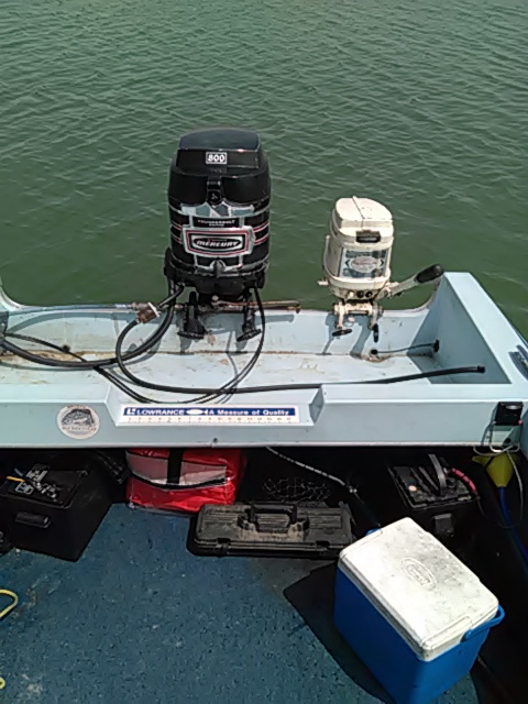

Were going to make 1 last fishing trip, hopefully tomorrow. At this point there arent any lakes close that are still open to power boating,, so one last road trip. Ill get non ethanol gas, and doctor it up with stabil. Going to try and run her out till gas dont flow any more. Its actually almost there,, but we need non eth, and at least a half hour of go time.
I whacked the tongue of the trailer for glasspar, so now its a 16' trailer instead of 18'. The glasspar, with its merc 800 and merc 60 should just fit in garage with motors down and about 8" to spare,, so will be in semi heated garage.
Managed to sell a couple more kickers,, so possibly might not have to store any extras,, but in case we do, then ill do as you guys suggest. Should be pretty easy going in the garage tho.
I work in garage, so it will be heated in day, but left to cool at night. Insulated, insulated door. Should be good for lower units, and other freezing issues?
