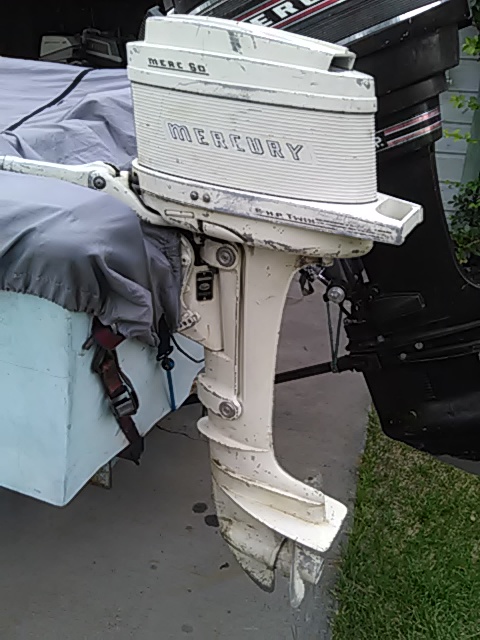

Hi folks. I broke the choke knob on my mariner which runs 50/1 just like my big merc so they run off the same fuel tank. While the mariner is down, there will be a white case 6hp twin merc in its place.
The 1960s merc 60 runs on 40/1. However,, its been said that in dirt bikes anyway,, with the newer high tech lubricants and detergents,, that its safe to run thinner mixtures.
Looking for opinions: Can I safely run the merc 60 on the same 50/1 fuel mix as the big merc 800? Cabellas premium 2 stroke oil with all the fancy additives is whats in the gas.
mercury 60 6hp twin serial # 1526973.
