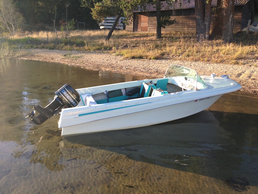

I am having the sinking feeling like I screwed up bad. The 650 was having shifting problems last night for the first time ever. It wouldn't go into reverse. I thought no big, let's test it in forward and see if it will reset. It didn't and on the test there was a crunching sound and the motor died. It would restart, but under any power it would just die. I managed to limp into Camp Cowles, our local Boy Scout camp and bummed a ride home. I went and rescued with our barge.
I opened up the drain and was faced with a teaspoon of lower end fluid. There was no water. I think I must have forgotten to put fluid in in the spring, that is all I can figure...
Can the lower end fluid just drain out? What kind of damage did I do and what kind of repair am I looking at?
Thanks Boys, feeling a little dumb right now.
Thom

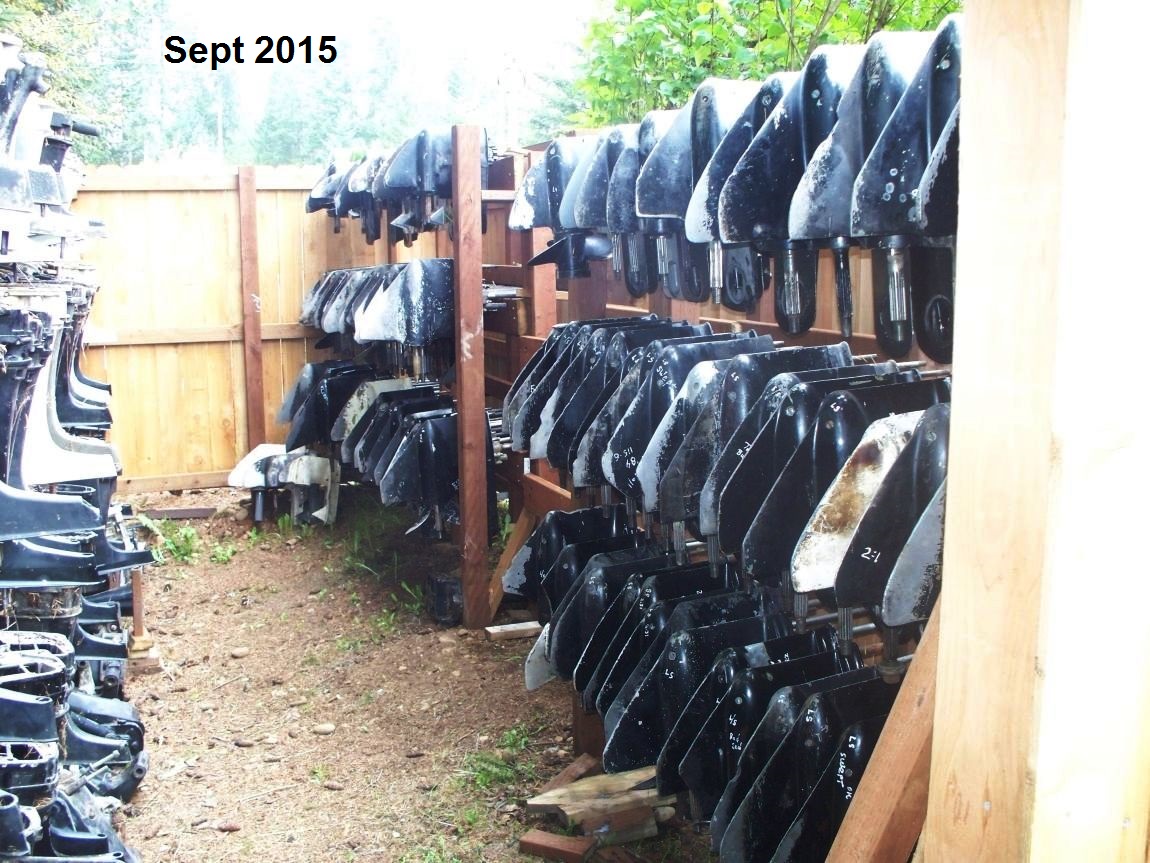

Re:Lower unit trouble, '74 Merc 650 11 years 1 month ago #114966
Well,...I do have a "few" :-)
