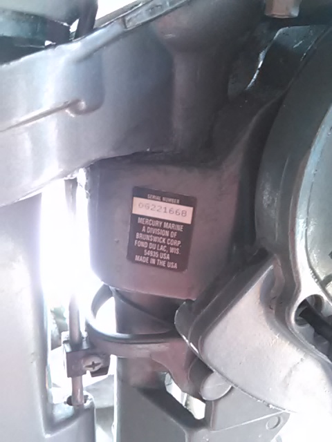

Hi. Im sure this gets asked, because when I searched, I got a bunch of different and equally wrong results. Seems like mariner serial numbers are very inconsistant at best?
I have a 6hp 2 stroke mariner looks newer,, late eighties, to nineties.
Blue grey in color, and pretty heavy compared to a vintage 6hp.
Serial number 06221668
Can anybody point me to some correct information? Year, fuel mix, can i turn it into a 9.9 or a 15? Its a big hunka 6hp. So either its a real brute,, or??
My searching has called it a 1976 150 hp, and a mid nineties 200hp, c ant be right.

do you have a picture of the serial number.. are you sure that's the correct number..
i came up with the same thing.. 150hp by those numbers..

The serial number is 0G221668 for the 6 hp Mariner.
Doc
Re:Need mariner serial # info, yeah i searched.... 11 years 2 months ago #114685
Thanks doc. Yup, its a G.

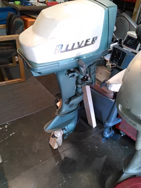

After testing this mariner,, then I get to test a real gem from way back.

Ok so the mariner is a 1995. Still looking for oil mix ratio. Going to test tomorrow!

Sweet little Oliver! :)

Not to derail this thread, but that is one sweet Oliver. Should start a post in other outboards about that one when your ready.
Re:Need mariner serial # info, yeah i searched.... 11 years 2 months ago #114716

So, in case anybody searches again. The serial number denotes 1995.
