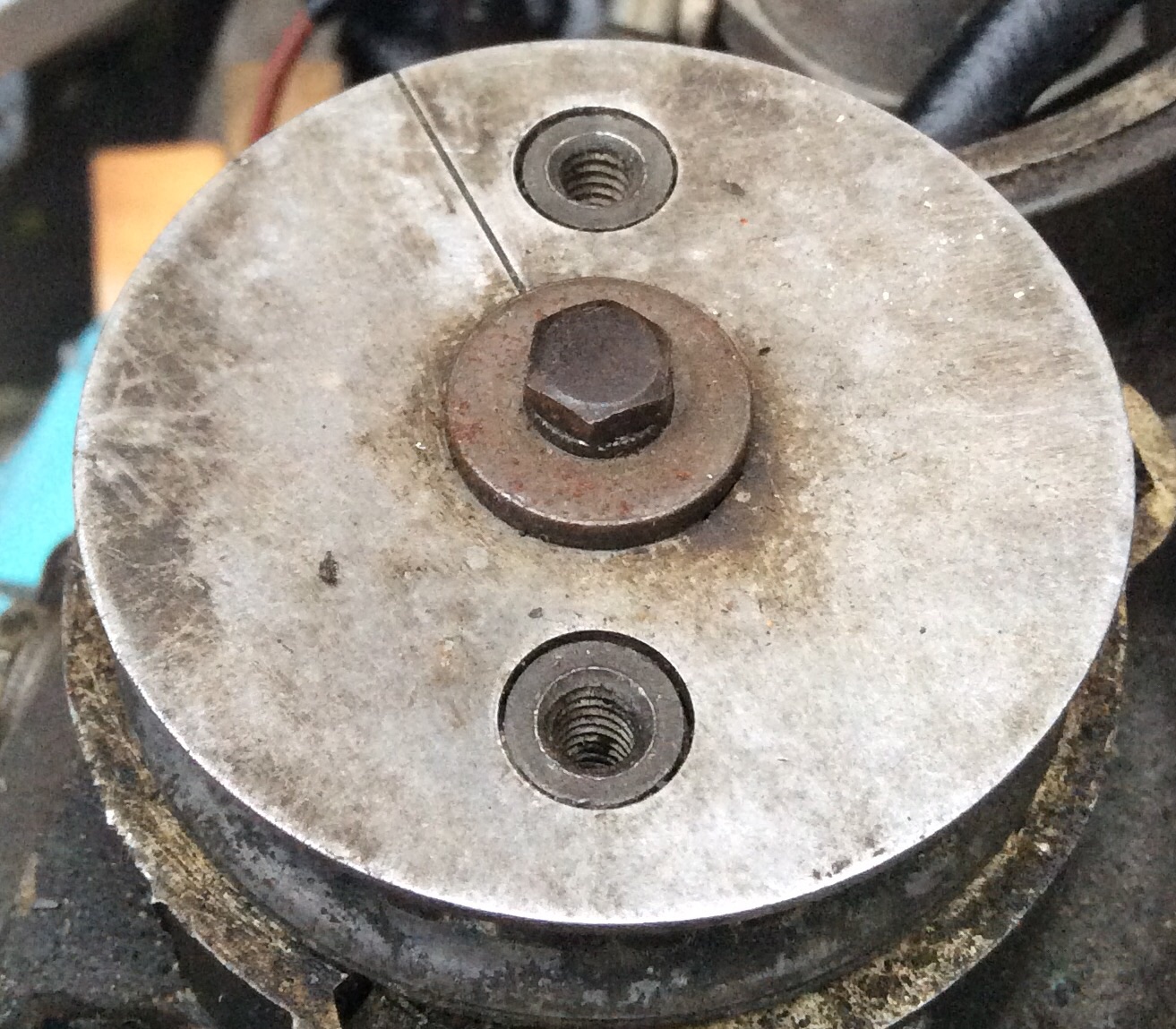

put the top cyl on top dead center then on the mag drive under the cover there is an arrow very small and hard to see that you point directly at the crank install belt that is it. 1 914 310 7086. if needed.

Thanks Dave. I forgot that the top plate has to come off the mag in order to see the arrow on the cog of the mag pulley.

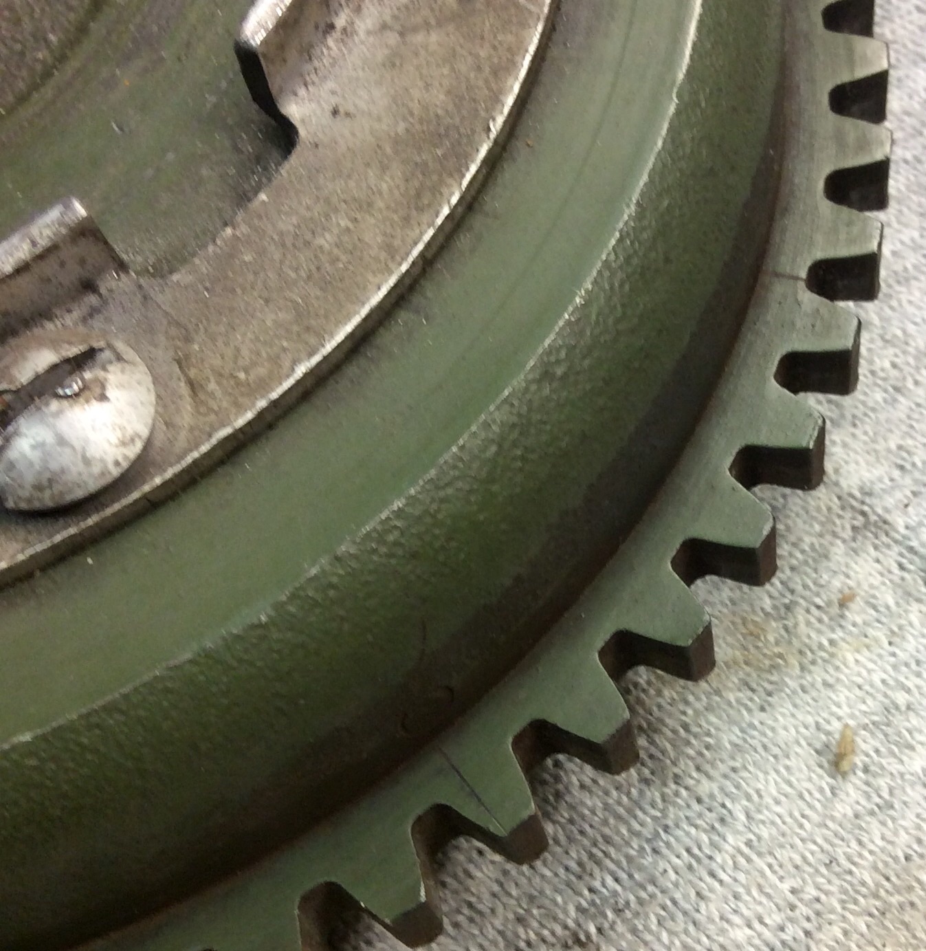

Which mark on the fly wheel (two in the picture) do I line up with the mark on the mag pulley?

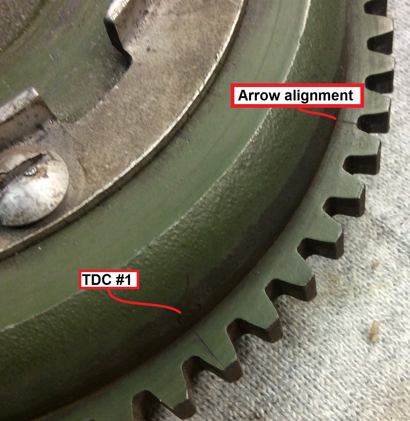

There are (2) marks on the flywheel.
The line with the 0 stamped on it is the TDC #1 mark.
The other line - that has no zero is the one you will use and align with the arrow on the distributor pulley.
