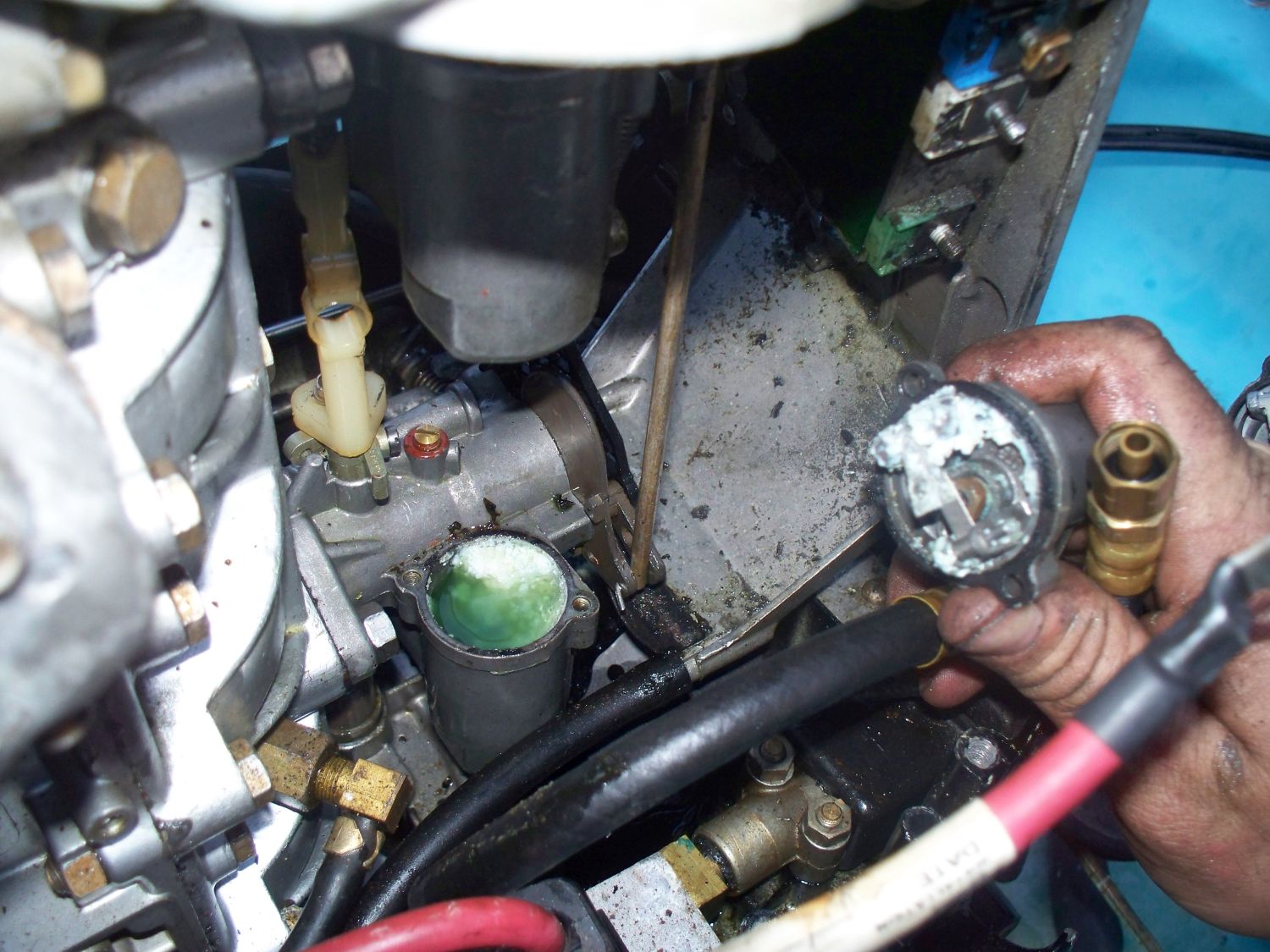

I think this is the worst example I've come across of the damage ethanol can cause in a carburetor.
The story was that the mid '70s 500 quit running a couple years ago, was left unattended, then brought to the Mercury Magic Shoppe for a resurrection when simply fresh gasoline was primed up, and the poor beast failed to fire.
Fortunately I had a set of clean replacement carburetors and a fuel pump assembly for the beast.

Is that what I think it is? Is that build up in the fuel bowl? If so what is it and how is the gas doing that? Is it breaking down the metal in the carb?
Re:Ethanol Carnage 11 years 2 months ago #114452
Would that be from e85 or the ten percent blend?
Re:Ethanol Carnage 11 years 2 months ago #114461
I'm pretty sure it was the less than 10% ethanol.
doc
Re:Ethanol Carnage 11 years 2 months ago #114489
Wow that is really hard on the carbs.
Re:Ethanol Carnage 11 years 2 months ago #114501
Even more unfortunate is that it's not just the carbs. A two stroke gets it lubrication from the fuel, right? So when the orifices begin to plug up and the motor starts to run lean, guess what else it isn't getting enough of!

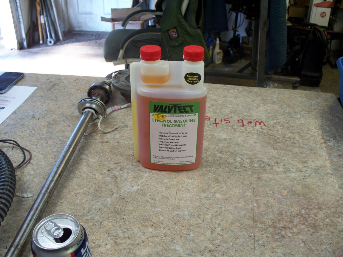

Has anyone ever used or have knowledge of this product??
It claims it "Prevents Ethanol Problems"
