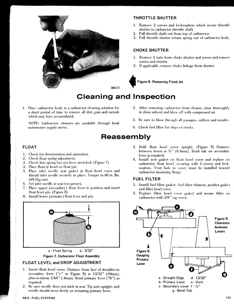

The other cause of this 'flooding' issue can be improperly adjusted float needle linkage. Initially this can be mistaken as the cause if you still have the original needle & seat assemblies installed because the rubber seat in the original set-ups gets mushy due to the alcohol in the gasoline we are confronted with today.
See the attached to set the linkage mentioned.
