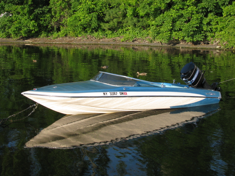

Nice looking Glastron, Matt. Post some more pics of it when you get a chance, okay?
